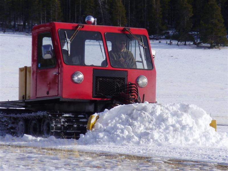

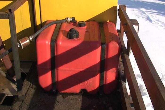

Here is a pic that shows two fuel tanks on our SV200 taken today. The two yellow tanks on the RH back are fuel tanks. I believe they are similiar to your original tank and with the two tanks we hold about 40+ gallons of fuel enough to run many hours with the 250 Ford engine.

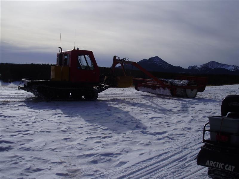

We were doing some engine tuning, steering band adjustment, track tensioning and testing today prior to installing the Valley fold up rear drag on the back after some major rebuild/restoration work on our Bombardier SV200. We also needed to move a 10 wide heavy older Maxey roller, with a cutting blade and packer pan type drag and used the SV200 to do that also. It turned out easier to push using the pin on the front blade mount for a mile than to try and drag it with the SV200 as we needed to fit it threw two 12 foot gates along the way. The Maxey drag is set up for an LMC 1200 and not the Bombardier we used today. We dozed some snow and generally tested all components to make sure before the drag is installed we are ready to go. Everything functioned as it should and we will install the rear foldup drag this week.
