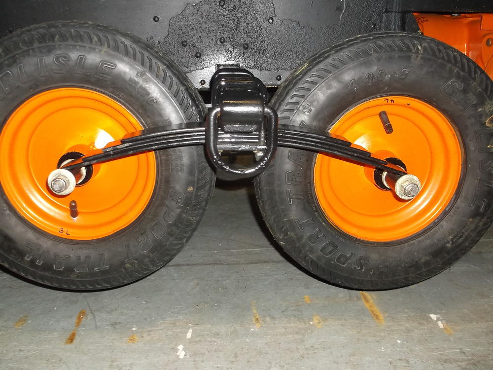

My 1402 has Carlisle sport trail 4.80 X 8. I think they are 4 ply or more. Nikson put them on new in 2012. I had one with a very slow leak so I put a self sealing tube in it but that is the only problem I have had. All my tires are pneumatic with tubes but we operate on roads not the boonies. No problems with them. Mine still has the original "hub in rim" wheels with tapered roller bearings.

If you are tearing out the sdewalls with the springs I don't think it matters what kind of tires you use they will get ruined. Nikson ran mine in some pretty remote places through crazy deep snow with these tires without a problem. But we have never had to operate in temps below single digits. I would try to figure out why the the springs are moving around. I would get some new U bolts that are a tight fit around the springs.I pretty much have to pound mine on. You could try putting clips on the ones you have. 3/4 X 1/8 flat bar would do the trick. You just have to rivet it to the ends of the top leaf.
turbinator62
Site Supporter
Looking at my springs and wheels I don't see how the spring could rotate enough to contact the side wall. It looks like it would hit the rim first unless your upper spring is shorter. Mine are 12".
The bottom plates are also important. If the holes are wider than the springs the u bolts won't restrain them.

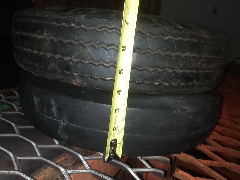

I have all the wheels off my imp and the rubber off the wheels but if memory serves I think the top spring could touch the sidewall. Has anyone used the solid tire above? I wonder how wide it is and if you can get them in slicks? I am guessing the solid tire would be a rougher ride.
I received the Fall Line slick, it is about a 1/2 inch narrower than the original Goodyear tire and seems a hair taller. You also need inner tubes with them but I can't find inner tubes that take 105 PSI like the tire needs. Probably have to buy them from Fall Line too. The side wall seems about the same as the original Goodyear tire. The tire that had the toughest sidewall was the PrimeX SpeedLine one, it was a real PITA to get on/off the wheel but it is also the one that lost it's sidewall integrity and became "pregnant". Maybe the one I has was defective but the effort it takes to get it on/off the wheel makes me not want to find out, despite having a new one on hand.
I am not sure what to do for tires, I expected the Falline tore to be more substantial.
