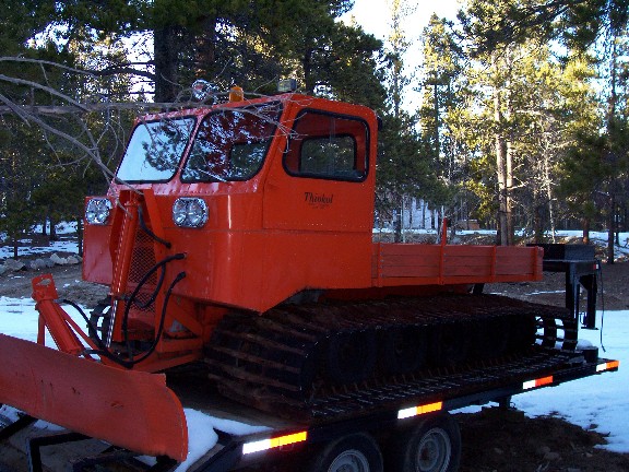

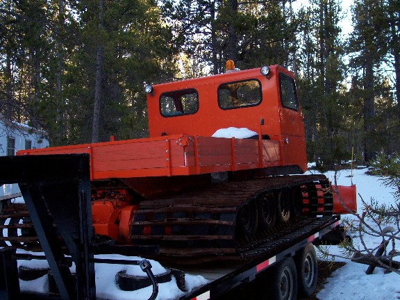

Kgracey, I've been kicking around the idea of selling this one but really haven't made up my mind yet. Done alot of work to it but it still needs to be completed. I have all the parts including belts. If you're interested I'll have to think about what I'd want for it cause I'm probably upside down in it already.
