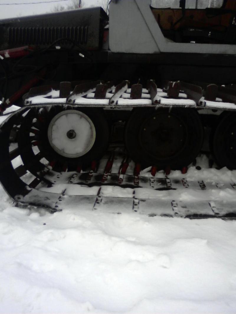

Here are a couple of pics of my Thiokol I am fixing up. The ones of the tires did not turn out very good but as you can kinda see the front tire is aluminum and the second one in is metal and has a 5 bolt pattern

It's pretty common to see aluminum rims on the front axel and steel ones behind those on the older Thiokols although I don't know if any came from the factory like that. I was told by the LMC salesman that sold me a 1200 years age that the aluminum rims were more durable than the steel but I have had both types fail on me before. Over the years they beefed up the aluminum ones as they tended to start cracking on the webbing near the hubs. I bought two new ones from the factory right before they went out of business and they had much thicker webbing and more meat around the hubs.
I know people have used standard trailer tires but I have always bought Good Year Monorails or snowcat tires from Fall Line in Reno. Foam filling is expensive so I figured spending a little extra on a quality tire was worth it.

Trailer tires don't seam to hold up to the heaver machines like your 2100 i have had better luck with the alpine guide tires than the good year monorail ck with okner supply as well for competitive pricing

I like the aluminum rims much better. They are alot stronger than the steel rims. Anything can fail if subjected to enough abuse. BUT the aluminum rims will take much more of a beating.
