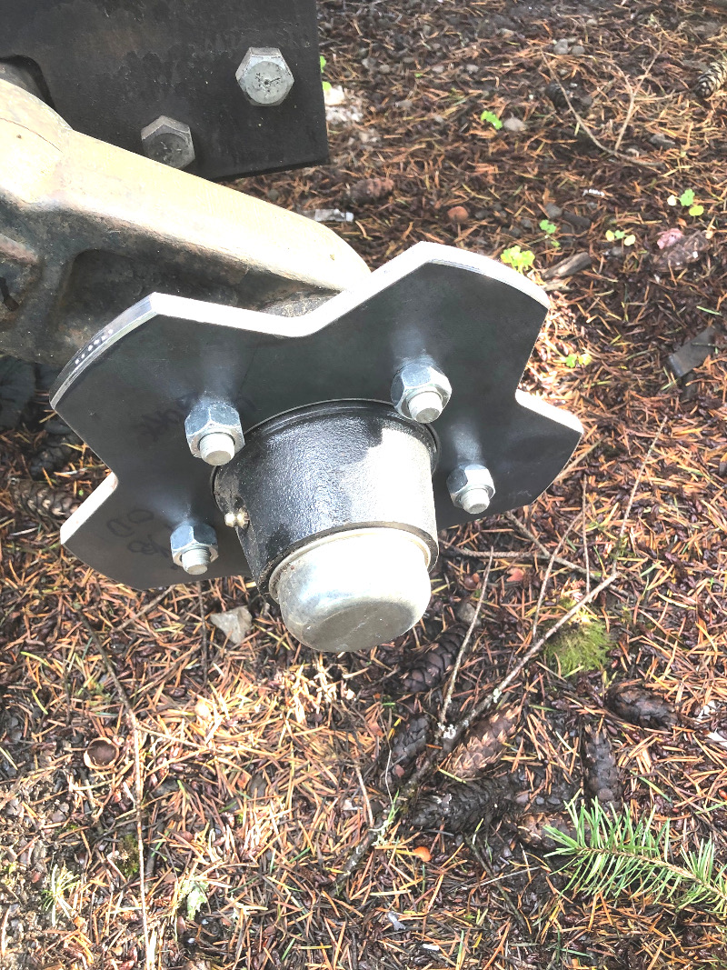

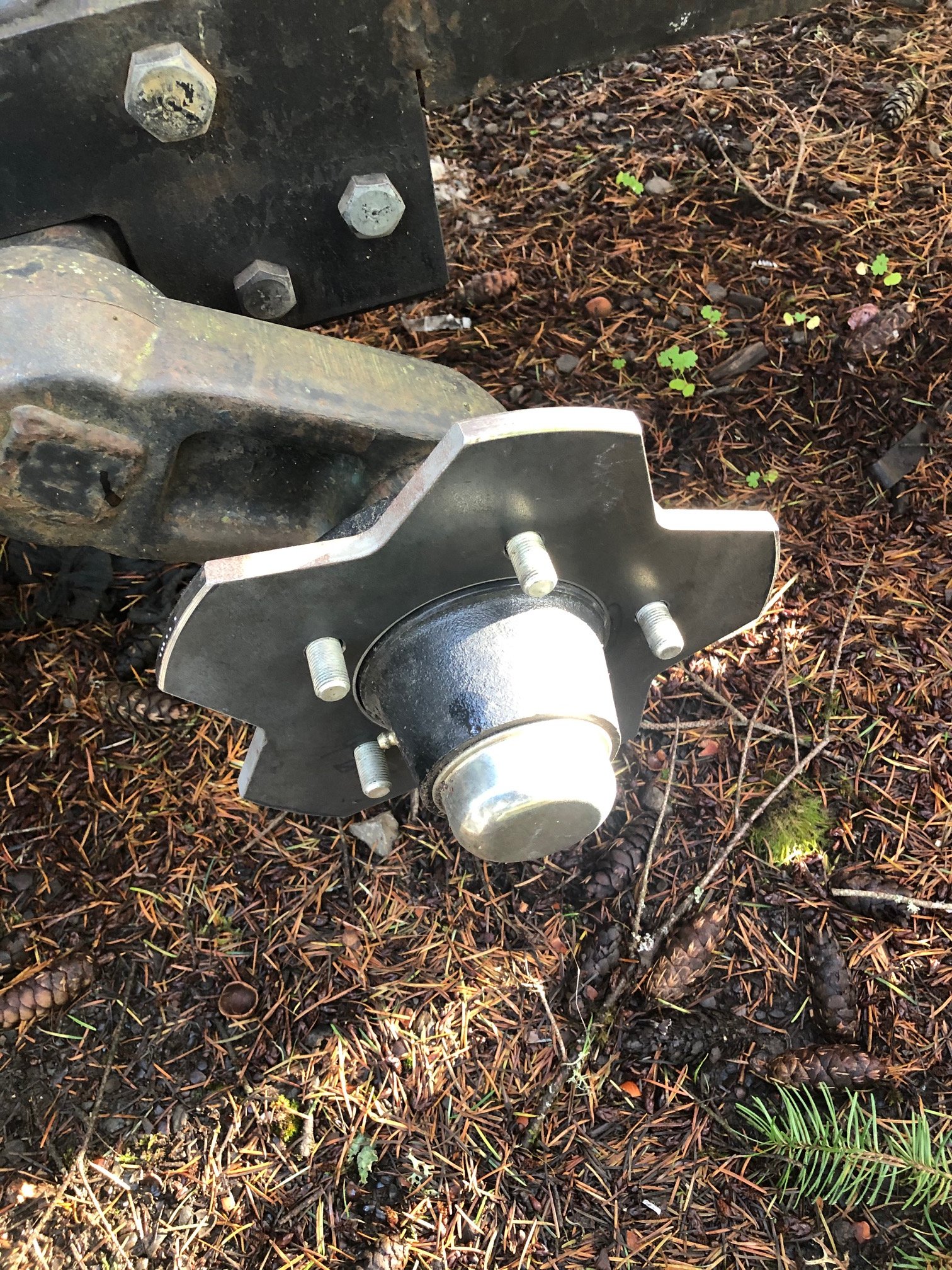

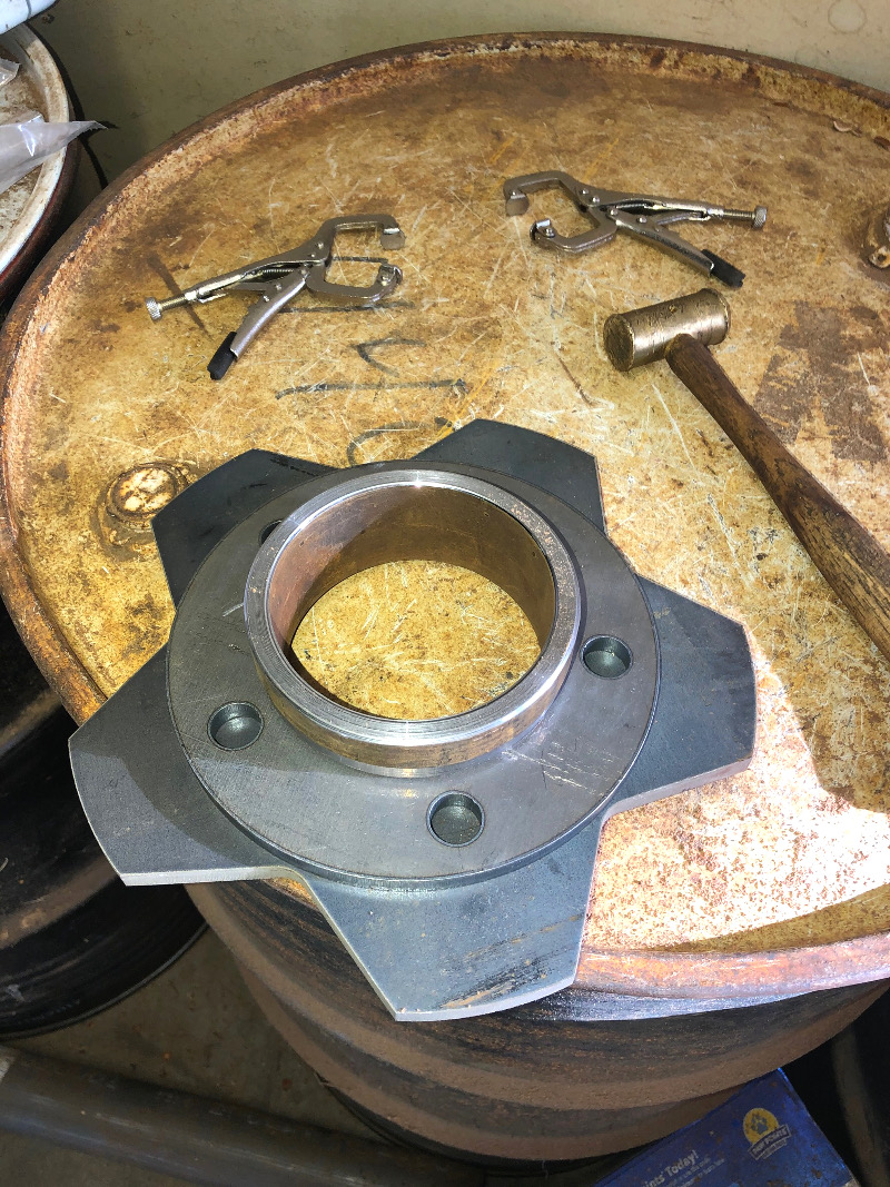

Got after the lug hole jig....got that done and the center "Snoflake" drilled and countersunk for the lug nuts
I drilled the holes at 17/32" and the plate slid right onto the hub/lug studs.
Countersunk the holes for the nut to fit in.
I am very happy with the results....

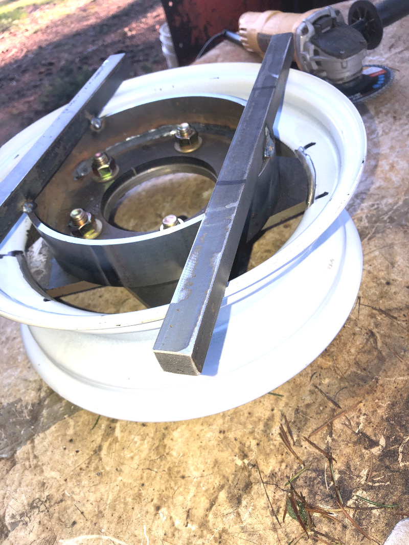

The next thing is to finish the JIG that sets the snoflake into the wheel for welding.
A bit of machining and a couple pieces of 3/4" square stock welded to the jig.
The jig uses the outer edge of the wheel to register from.
The factory wheels are 1-1/4" from the face that contacts the hub.
The new wheels are 4" wide instead of 3" so added 1/2" to the jig.
This will set the center plate at 1-3/4" from the outer lip to the center plate.
Close enough for the crowd I run with.....
Plus or minus 1/16" and nobody gonna care.......
The plan is to get the positioning jig finished and the wheel center tack welded in and see how it all looks and how true it actually runs......
Once this first wheel is complete more can follow really easy......

The locating fixture was a repurposed wheel offset setup from the jalopy shop.
I tossed it in the lathe and trued up the back face and the trimmed it to 1-3/4" thickness and welded the bars on.
Bolted the jig to the Snowflake

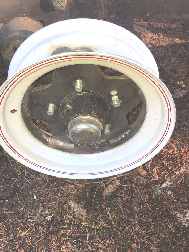

Tacked the Snowflake in place and then tried it on the hub.
The unit runs very nice. Tiny bit of overall run out radially. NONE AXIALLY
I am not totally sure the wheels are perfect before I got hold of them...They may have a tiny run out ....no worries.
A good deal for fresh wheels.......at an affordable price.

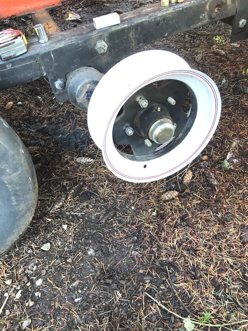

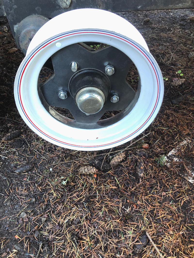

All welded up and ready for a clean up and some paint......
Not sure on color....likely go with a silver gray to look good with the 4 alloys.
Checked the dims from the cat tub to the center of the tires.....New wheel is spot on with the original location.
Gotta love it when a plan comes together....
Bobcatbob
Nice jig! Unless you’re really moving, a small radial runout should have no impact. Welds look great (a skill I have yet to master).
Snowy Rivers
Thank you Bob
I am pretty sure that these wheels may have/have had a slight bit of wiggle from the factory.... I am talking just enough to see if you hold a solid marker up close to the rim and spin it slowly ....and then the run out is is a couple places and not 180 degrees out, making me suspicious that the wheels may not be perfect...
Whatcha spect for a $20 wheel from across the pond (Not China though.....South Korea)
No wobble back and forth (In and out )
At 10-15 mph the RPM is just way too slow to ever cause issues....even if they ran out 1/4" I doubt you could notice it.
Not like hitting the slab with your Caddy having a wheel out of round and running 80 mph...

I am excited to have the first wheel basically finished....Still needs the valve stem hole enlarged a bit for the tubes....
I'll hit that with a bridge reamer and we'll be good to go....
I do plan to add a stem guard to keep the tire guides from knocking off the Valve stems.....

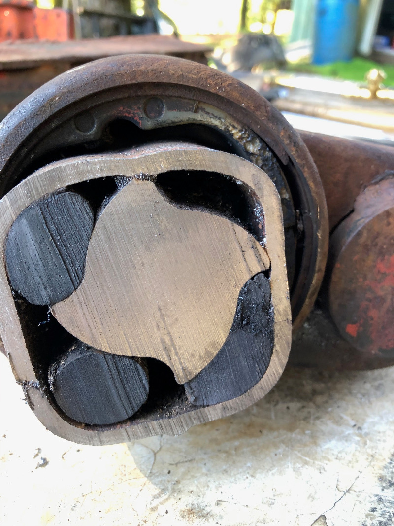

I have been thinking seriously on using a Timbre rubber spring mounted in a bracket on the frame that the new front axle reaction arm can push against.
Adjustable at assembly to get the axle located correctly with the chassis flat and a normal load on the road wheels.
Timbren "TORTUN4" units are rated at 6000# max and should be quite satisfactory to do the job. Durable and easily replaced if need be.
Looking at the original Torsion axle that I cut apart the internals can be seen well.
This axle was junk. The Rubber on the one corner had disintegrated and the internal shaft had shifted....Wear can be seen in the steel tube as to the shaft itself.
The plastic split bushing that was installed to help support the assembly is badly worn.
I can't say which went first....the bushing or the rubber....The rubber up in the corner that is missing was just chewed up mush and fell out when I sawed the tube off to salvage the Spindle arm.....
So.....If you have an axle that the bushing is badly worn and things have shifted.....What this picture shows is pretty much what's in there..
Sadly replacing the components is an issue.......
Hence my decision to go another route.......

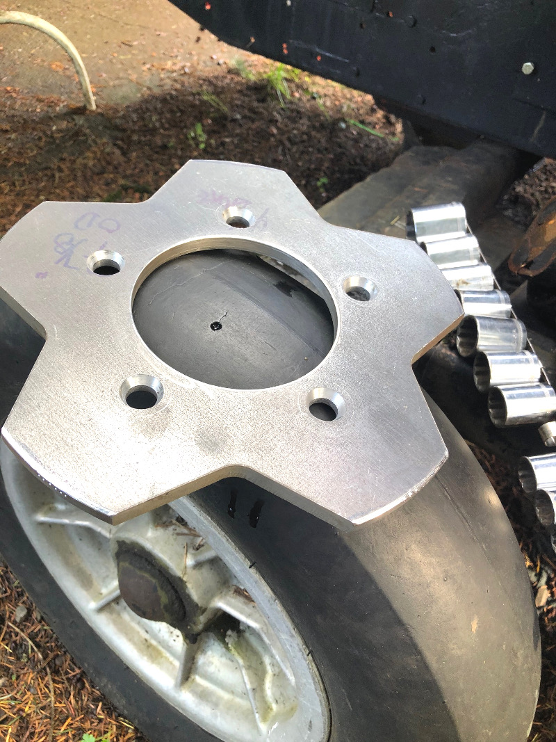

Snowy Rivers
Got after the second wheel in the new series.
The water jet cutter gave us a perfect center hole in the plate at 4.015".....
So all that is needed is to trim the OD of the plate so it just taps into the rim.
From here on the centers will all be the same.....The first one was the prototype...and I allowed way too much material to bore out of the center as well as too much on the OD as well.
We made adjustments to the drawing and they changed the dims in the data going to the water jet.
Now the center hole is perfect...My original ended up at 4.020" and that is fine...but getting the rest to a standard size that I do not need to machine will be sweet.
The hubs have a pilot that is 4"....so a few thou clearance is perfect.

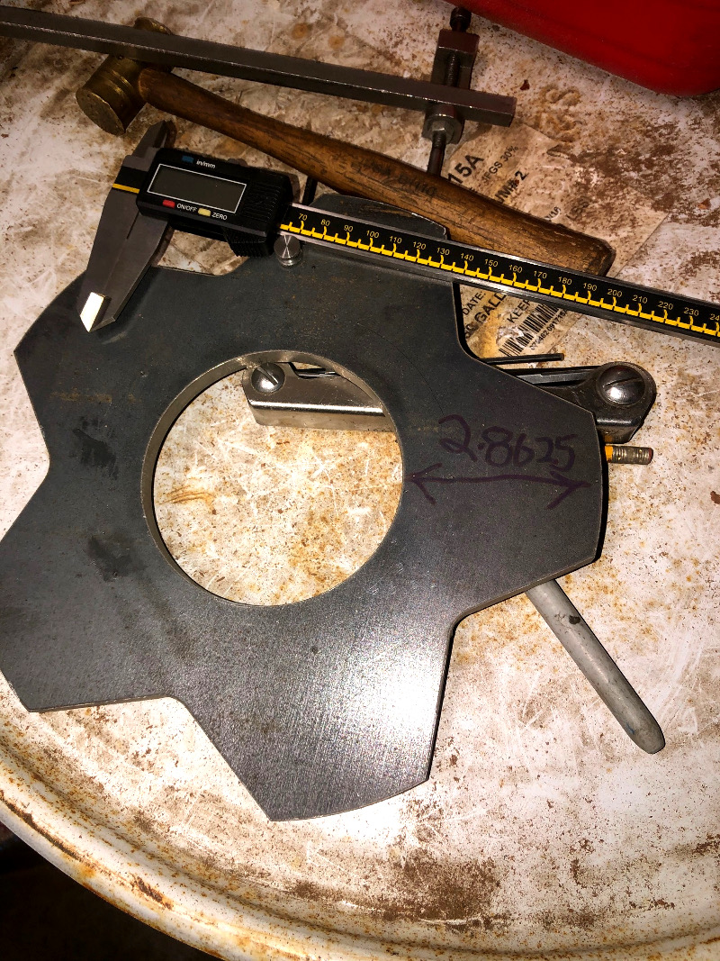

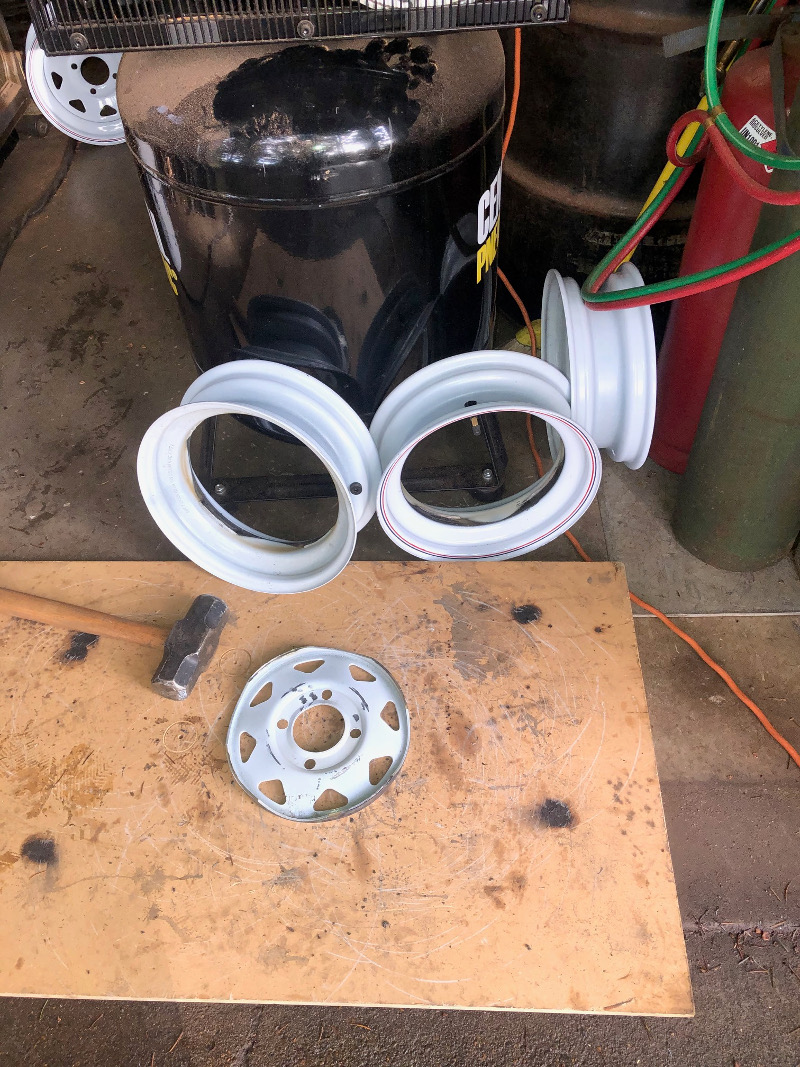

The rain had been nasty today...but got a break for about an hour earlier and decided to gitterdone.
Cut the factory center out and smoothed up things....Did the calculations and got the numbers so the OD of the snowflake can be cut.
2.8625" from the outer edge of the pilot hole to the OD of the snowflake....then this leave a tiny tiny bit to trim and get the rim to just tap onto the snowflake.
From now on these wheels will be very easy to do the rework on.
The centers will be identical and the entire process will be pretty much a slam dunk.
Cut the 4 welds loose
Knock out the old centers
Clean up the weld area
Machine the Snowflake OD
Transfer the lug stud holes
Drill and countersink the holes
Bolt the Snowflake to the alignment jig and fit to the wheel.
Weld the snowflake into the rim
DONE DEAL.....PAINT...
On a nice day these bad boys should be very easy to knock out quickly.

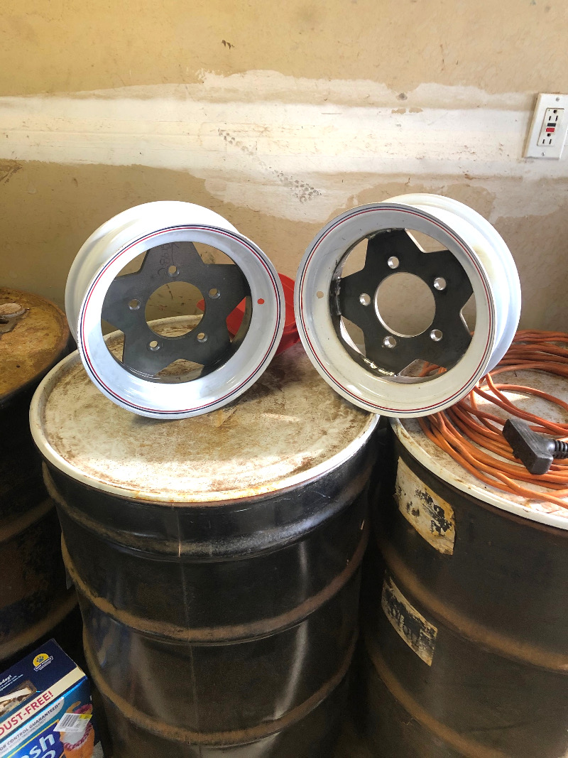

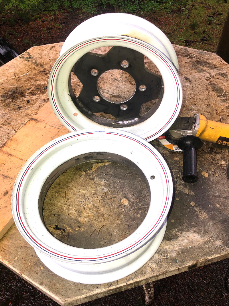

Weather was decent (Subjective term) and I dragged the box of 4 more wheels out of the truck and went after knocking the centers out.
Takes about 5 minutes to cut the welds loose and the cutoff wheel is good for two wheels before it is too small to gitterdone....
I had cut the second wheel the other day....and had 1 full disc and the last half of the first one left
So three down & one to go
Need to pick up more discs tomorrow.
But got something done.
The dims on the Snowflake from OD of the pilot hole to the OD of the Snowflake I said was to be 2.8625"
I got the Snowflake close and then did trial fits to get a "TAP" fit into the wheel.....
Came out to 2.858" when I could lightly tap things together.

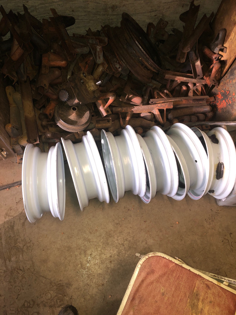

Snowy Rivers
Dan....
Thank you for the compliment...
Finding these lovely little wheels so cheap just makes me all warm and fuzzy....
Truth is I would love to have a complete set of the factory alloy HUB/WHEEL combos like whats up front...
Sadly the budget will not permit it.
But....after some trading with our member "Thefatsquatch" I have two more alloys that can go on the rear axle.
The 6 wheels in the piccy are gonna go on the center 3 axles.

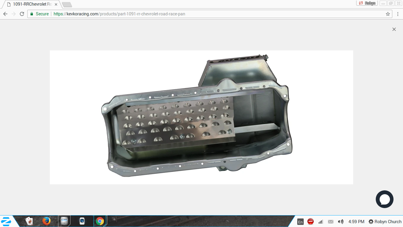

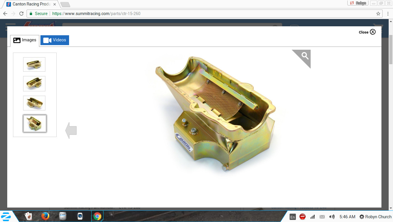

Then the subject of the engine oil pan comes into view.
The factory Ford 391 had a super deep sump and the cat tub has a boxed in area to allow the sump extension to fit.
The 305 Chevy has a tiny 4 quart pan......this is not gonna cut it for running off road and at weird angles.
Waaaaaaaaaaaaaaay TOO LITTLE OIL.
Figure while the engine/tranny is out to weld up the mounts.....a great time to remove that ugly sump extension (Been hacked by previous owners) and fit in a nice neat extension of about 4 inches deep and large enough to allow a baffled and gated 8 quart pan.
Found a nice "Road race" pan for the Small block Chevy that has a windage tray hinged trap doors and baffles to keep the oil at the pump inlet.
Uses a flexible dipstick tube that screws in on the LH kickout.....
This pan is gonna be plenty of oil for the application.
Possibly super steep nose down might be an issue....but I think this will work fine..
Far better than the 4 quart stock Camaro pan.....
Another thing...this pan will fit any small block with the dipstick notch in the LH side...be it a 305, 350, 400
These pans are not cheap....do not want to do it twice.....

Great work on the wheels Snowy (y) On the oil pan, great choice, you could also run an accumulator for some added safety and piece of mind. It's also something you could add in later if you run into oil starvation/low pressure issues often.
Snowy Rivers
Thanks Hillbilt
I ran an accumulator on my Blown big block Chevies in the drag boats....
I did more snooping and found a great deal (Shipping included to my door) for a KEVKO 1091RR pan that will fit any of the two piece rear main Chevy small blocks.
It does not have the dipstick notch in either side......
Has a kickout on both sides with a plug for a screw in dipstick tube.
7-1/2 quart in the pan
For a play toy...should be fine.
Now is the time to get this stuff dealt with.......come good weather I want to get haulin on this beast....
A winch cat....not so much :lmao:
This pan is better suited than the other one I was looking at.
The fact that pan will fit pretty much any of the two piece rear main small blocks is good.

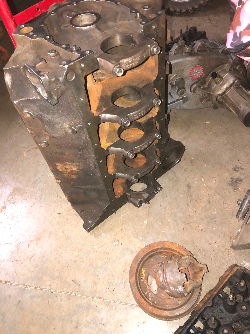

Snowy Rivers
Weather was basically dry today....but windy and cold.
Said T'Hell with it......gotta get some work done.
Got the 400 block outside and went after it.
Took the 9" grinder with the big cup brush after all the surfaces...
Decks
Pan rail.
Bell housing surface
Timing cover and fuel pump flange area.
Ran a bottle brush hone through the cylinders....yeah.... we gotta bore it .030.
One has a place water had been there....just too ugly to let go.
I tapped all the threaded holes to clean them up.
Took a magnifying glass to the area between the upper steam holes and the adjacent head bolt hole....NO APPARENT CRACKS.
Marked the main caps and got them off.
Wire brushed the seat in the block....not much rust...but grungy.
Washed up the main bolts and buffed them up well.
Main caps fit nice and snug.....Yesssssssssssssssssss.
The main bearing are likely what came in it new (GM200 3-78) March of 78 so this block is not older than a 1978....
Ordered up a set of bottom end bearings this morning.
Think I am gonna have the shop check the main line with a bar to see it we need to do an align hone on it...
The front and rear caps can't be mixed up...but the center 3 can......The were not numbered....most big block Chevy's have the numbers cast into the caps....Not these.
I marked them.....so we shall see...
It was nice to get all the threaded holes cleaned up....and not find any broken bolts or messed up threads.
One missing head dowel....no worries....more in the store.....If we deck the block they come out anyway.....
The dusting of Orange still showing inside the block will go away after the hot tank gets after it.......
Main caps and block bores look great..
No signs of the bearings moving about.....
Now.......
If the heads off the Vortec are usable ...as in....NO CRACKS...We are golden....
Unless something hinky shows it's head....things should have been worth the effort.
