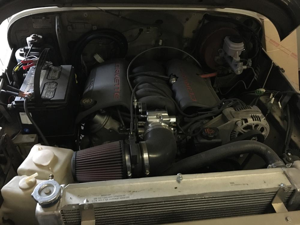

Incidentally some knucklehead, who shall remain nameless, has an FJ40 LandCruiser powered by...an LS1.

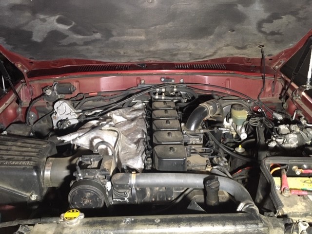

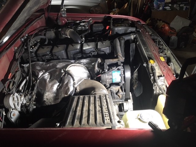

So a 6 cyl Cummins won't fit in a FJ 80? AC and mechanical fan. I even herd of a knucklehead that put a 3208 in a 1/2 ton GMC.
That's interesting and beyond Uber-cool. My wife drives a 2002 LX470, the slightly more refined sibling of the LandCruiser in the next generation (100 series) It's a great vehicle, but woefully gutless. If you added 150 HP...it wouldn't be too much.
In theory the 4.7L V-8 in her car has slightly more power than the 4.5L I-6 in the 80 series. But having a 6 cylinder Cummins would be fantastic. The torque would be incredible, the fuel economy much better, and the coolness factor would be approaching that of the 3208 powered Carryall.
I would say your so-called "knucklehead" is really a mechanical engineering genius!

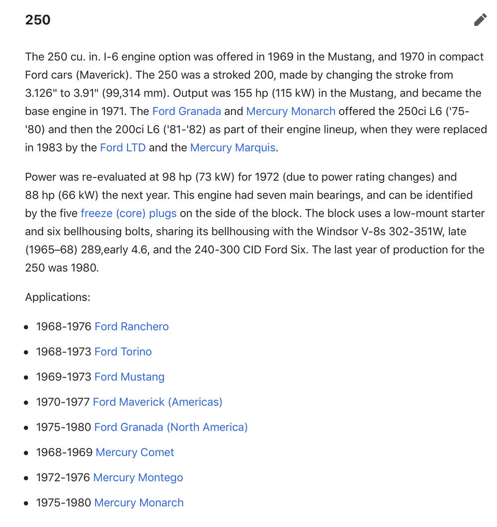

I am unaware of a 250 CI engine.
it could be a 170 or 200 those are in the older sprytes intake is cast as part of the head.
240 or 300 the big block version b and c model sprytes intake bolts on.
I am no expert, I just know the A models had the smaller engines and they sing a nice tune.( like a sewing machine) I think my experience with straight sixes and oc4 rear diffs puts me in the 19 mph and under category. that little motor is stitching pretty fast at the top of 4th to break 15mph

I came up with the 250 spec based on running some casting numbers on the engine. The local cat guru remembered this having a larger than stock power plant too.
I’ll do some double checking on the engine specs but it doesn’t feel starved for power at all. Thanks for choking in!
Snowy Rivers
I have never seen the 250 Cube 6 in the Ford....but they did make it for sure.
I probably missed it about the time they switched to labeling them in Liters....
