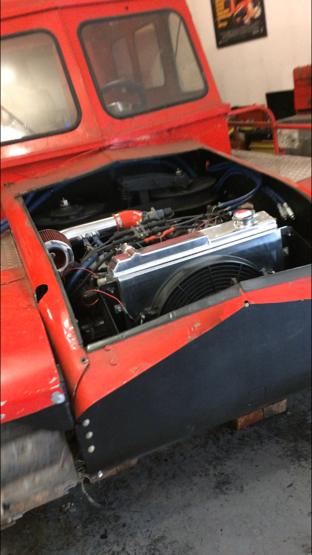

Update: should I choose to take the plunge I now have a donor 1991 legacy (the whole car) with an EJ22. I'm more than comfortable with the reliability, in particular the non-interference EJ22. The best EJ22 would probably be out of a '95-96 legacy (to get OBDII) but I can't be too picky. Im pretty leery of the EJ25 DOHC and SOHC because of all the head gasket problems
Did you buy it? Have you started this conversion? Let me know if you want any advice on the conversion.

I own the vehicle, yes. I had family move out of state and the car wasn't worth moving so it's mine now. It runs and drives, I've been using it a little bit here & there to see if it has any issues that concern me, nothing yet. In a past life I used to work on Subaru's professionally, I am very familiar with the EJ22 of this vintage.
I think the biggest hurdle for me is getting a cooling system in place. I'm not sure what route I would want to go with a radiator & plumbing.

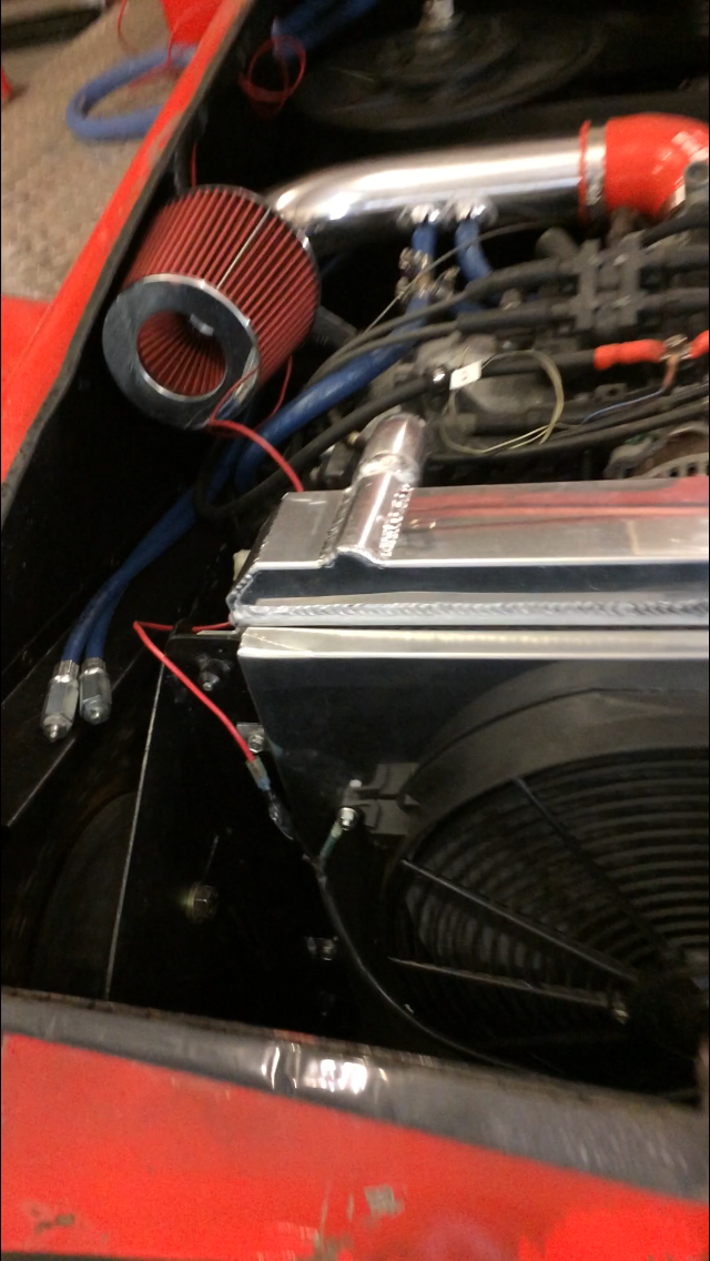

I tried and tried for days, maybe weeks to make the original Subaru radiator/fan unit fit, but it just would not. Eventually, I ordered an all aluminum 4-row radiator for a Jeep TJ Wrangler and it solved all my fitment issues. It has the ports in the appropriate places, but I still had to weld on additional elbows to make them line up better with the ports on the engine. Keep in mind that I moved my transmission mounts rearward 3 inches to give more room for all that stuff up front.
The exhaust took me quite some time to figure out, since I built the whole thing custom. Engine wiring will be a major hurdle. I’m assuming that engine is managed by computer. There’s a really smart guy named Mick Longley who owns a company called Busaru. Look it up on YouTube and there’s a whole series that shows how to pick the wiring harness apart, leaving only what you need to manage the engine. I just sent my harness to him for him to do the work. He has figured out all the issues involved in doing that conversion on vintage VWs.

Thanks for the advice. I'm still in the stockpiling mode as things sit but I'm inching towards the swap.
i've seen a few on the web that mounted a radiator remotely, on the rear or side of the rig which seems appealing so you keep the room up front but I'm also concerned that this would just add a lot of complexity and failure points versus a conventional/front mounted radiator. What fan setup did you use? With a Jeep radiator could you run an electric fan from TJ too? Do you run your rig when it isn't winter and have you had any over heating issues?

I bought a radiator with fan and shroud combo. Not sure if this link will work:
https://www.amazon.com/gp/product/B0...?ie=UTF8&psc=1
Iíve not actually finished the restoration yet, but installed and tested the engine and cooling system in my shop with no indication that there would be an overheating issue. Temperature stayed exactly within normal limits. Fan and thermostat cycled when they were supposed to. That radiator has way more cooling ability than the stock Subaru one. I donít anticipate any issues. Even when I built the new front skid plate, I didnít incorporate any grille openings because I wanted it all to be sealed and smooth up front to keep snow out. It currently will circulate fresh air from The original louvers toward the rear of the hood and over the engine. If I experience any overheating, I can cut louvers or openings in the front section of the hood.
Iíll attach some blurry screenshots of a video I took of it running in my shop. It sort of shows the current layout. You should be able to see house nicely everything fits and how much extra space there is in front of the radiator. I canít find any better pics, for some reason. Disregard the random wiring, this was just a test run before installing any of the permanent wiring.Name:  CD552654-1478-4F26-A2CF-261E3D2D5217.jpeg
Reply With Quote
The Following User Says Thank You to Alaska Jay For This Useful Post:
jim slagle  (12-19-2017)
  #19
Old 12-19-2017, 01:14 PM
Alaska Jay Alaska Jay is offline
Join Date: Sep 2016
Location: Fairbanks, Alaska
Posts: 60
Thanks: 11
Thanked 50 Times in 20 Posts
Alaska Jay is on a distinguished road
Default Re: Just Picked up a 1975 ST4 in the Willow area
The only modification I did to that rad/fan combo was to flip the fan shroud from the rear of the radiator to the front, and reverse the direction of airflow by switching the power wires. It blows air to the rear instead of the fan being positioned between the radiator and engine. I mounted the AC condenser between the radiator and engine but you can’t see it in these pics.
Reply With Quote

Air intake is below and behind the bumper??
Jim
