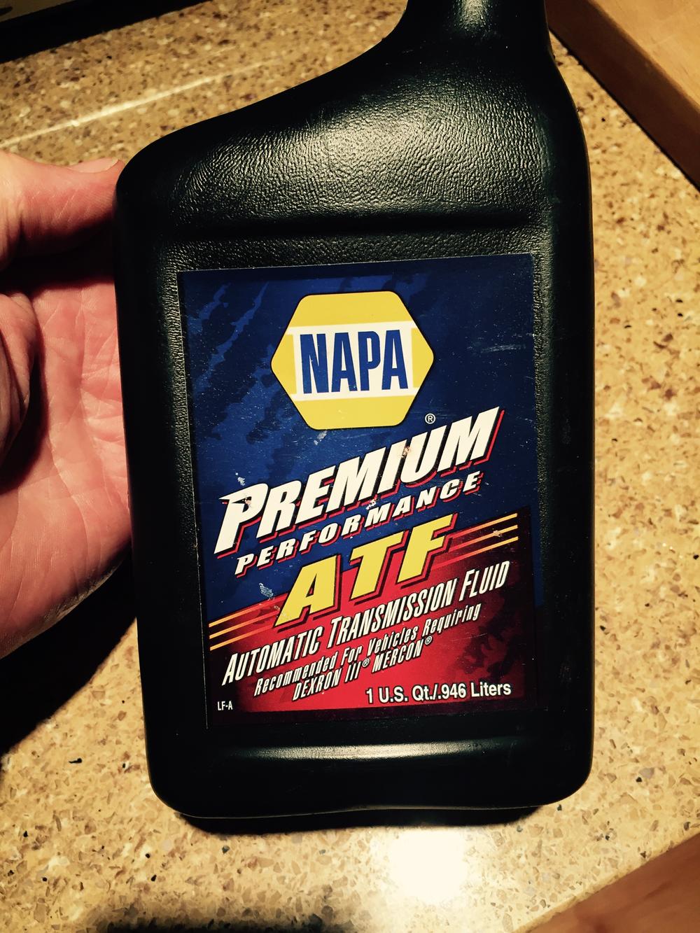

I was looking at the oil tank breather cap and noticed that the bolt through the cap runs to a standard nut. Im going to change that nut to a self locking nut. If that nut fell into the tank the filter would stop it but I don't like the idea of nut laying around in the tank. I think vibration possibly could cause the nut going loose.
That oil tank is full of ATF ! interesting
MNoutdoors RIP
type F ATF was common in that pump only type F not dextron mercron

For the little bit that is been run I'm sure it's fine but type F is recommended
And I can't say why I just know that what they wanted in those systems
The type F for what I understand was originally best suited for running the brass and bronze clutch packs in the transmissions. The dextron and mercron has friction modifiers

In our 3700AC we use AW32 in both hydro and aux hydraulic tanks. Sunstrand hydros. We use it for better cold weather and for our light use the oil never gets warm and the hydros run quieter. No problems at all so far, 15 years. The manual calls for also calls for Type F.
-Pat
That's reassuring Pat... I'm guessing that it may also have something to do with the type of seals used in the hyrdo also different seals react differentially to different types of fluids.

For what it's worth I was told by the local petroleum dealer last winter that the modern ATF will work in just about all applications including those that recommend type F. They said Type F is getting harder and harder to find. I had a Pisten Bully that I ran for at least 1000 hrs on Dextron III with no performance problems. I run a hydraulic fluid on my current Pisten Bully and the factory tech guys say use what ever type you like. ATF is a little better for cold start ups but not as good otherwise.
