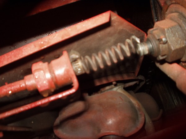

Mike, here are two photos I just snapped for you. The speedo cable should NOT be welded on! I suspect that would have been a hack repair job by someone who did a quick fix for a quick buck. The cable terminates with a spring that is attached to a bolt that is attached to the center of the drive hub/axle on the sprocket. You should see this in the parts manual photos I sent you.

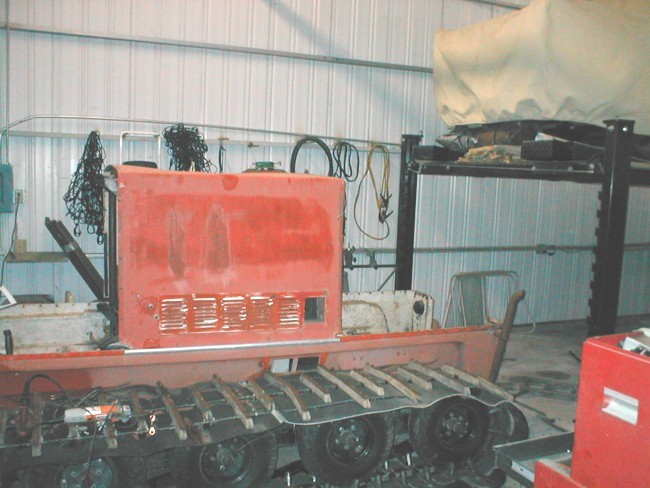

The first photo shows a close up view of the end of the cable (which is a spring) attached to the center hub of the drive sprocket. The second photo shows how the cable is routed under the engine guard shield, then up through the hole in the guard and around the side of back to the firewall where it terminates at the back of the speedometer. I added the direction arrow and the dots for BigAl, I figured he would need the extra help. (Al, sorry I didn't have crayons, it was the best I could do on short notice :whistle: )

Mike . . . One more thought, I've seen a lot of photos of engine compartments that do not show the guard that is in my photos. I think over time, many of them were removed and discarded. I'm not sure what purpose it really serves other than it gets in the way of things. So if you don't have it on yours, you are not really missing much.
