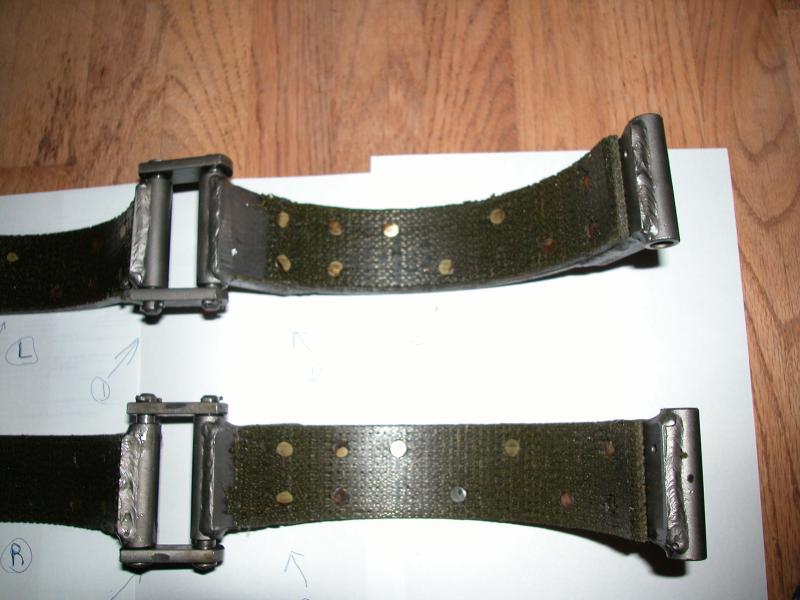

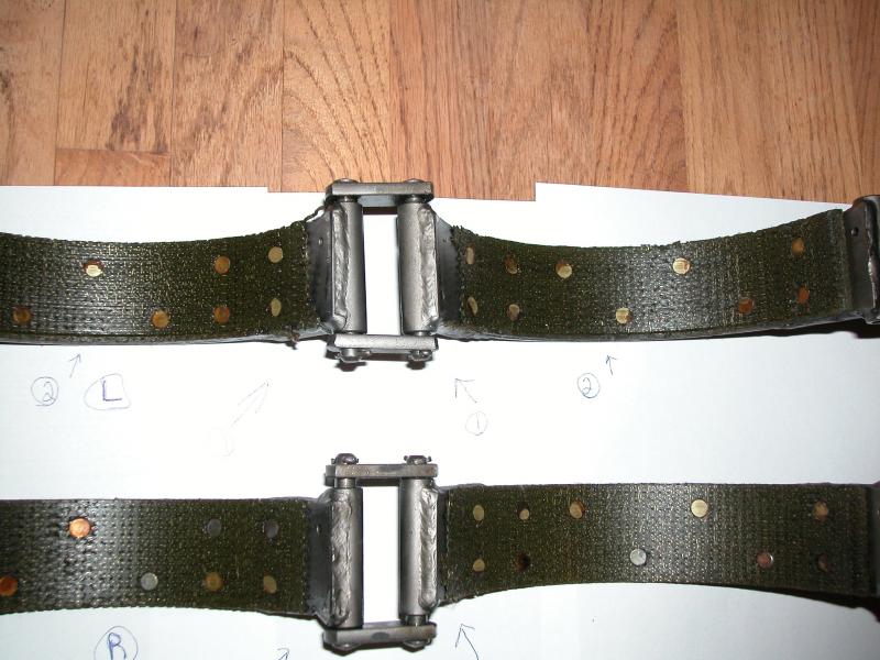

Today I just couldn't take it anymore...I dug into the dif. Not really all that bad getting to it, but taking it all the way out I can see a good amount of shop time. I was able to move the cab forward and pull the gas tank to access the top of the diff and finally inspect the pads. While digging in I found that the left pad was riding off center of the drum and wore the pad a little funky. Both bands were grabbing where they are connected together and not much wear or no wear on the other part (toward operator). Both drums are scored a little but nothing too deep. Also, I found that that the drum have a little (maybe 1/8") of play side to side and little to no play up and down. Is this normal? Is this OK? I included some pics this time.:biggrin: Now comes the questions of: Where can I find new pads or someone to replace them? What should I do about the drum movement? I am desperately hoping to not remove the entire dif.:unsure:
#1 points to the worn out (front of dif) side of the bands.
#2 points to the uneven wear on the outside of the L band.
Thanks,
Steve

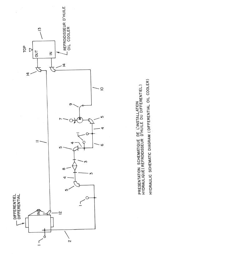

I don’t know when the coolers became available on the Bombi. If yours did not come with one from the factory it will somewhat difficult to install one. Take a look at the attached picture for reference. The yellow arrow points to the suction tube on the differential case. Do you recall seeing this when you had your machine apart to do the steering bands? If it was there the machine had a cooler on it at one point. The return line back into the differential case is visible from the cabin without having to disassemble anything. Look for a line or may in your case a pipe plug close to the pinion yolk / driveshaft flange. This is where the return oil comes back into the differential case. The return oil provides lubrication for the pinion bearings. One other thing to look for is a bulge at the bottom of the differential case about the size of a hockey puck. This is the sump for the suction line. I have attached a page from the Bombi manual that shows the hydraulic layout of the cooler. The circle with the triangle in it (item #7) is the hydraulic pump that runs off the drive shaft.
I had my machine out for the first time this winter after the ring and pinion surgery. With the correct oil, new brake bands, new ring and pinion it is a very different machine! Steering is 100% better! Not much force is needed on the steering levers to change direction. I think Boggie is the man that deserves some of the credit, that’s who I got the brake lining material from. So far it's good stuff and recommended!:clap:
Hope this all helps,
Radar

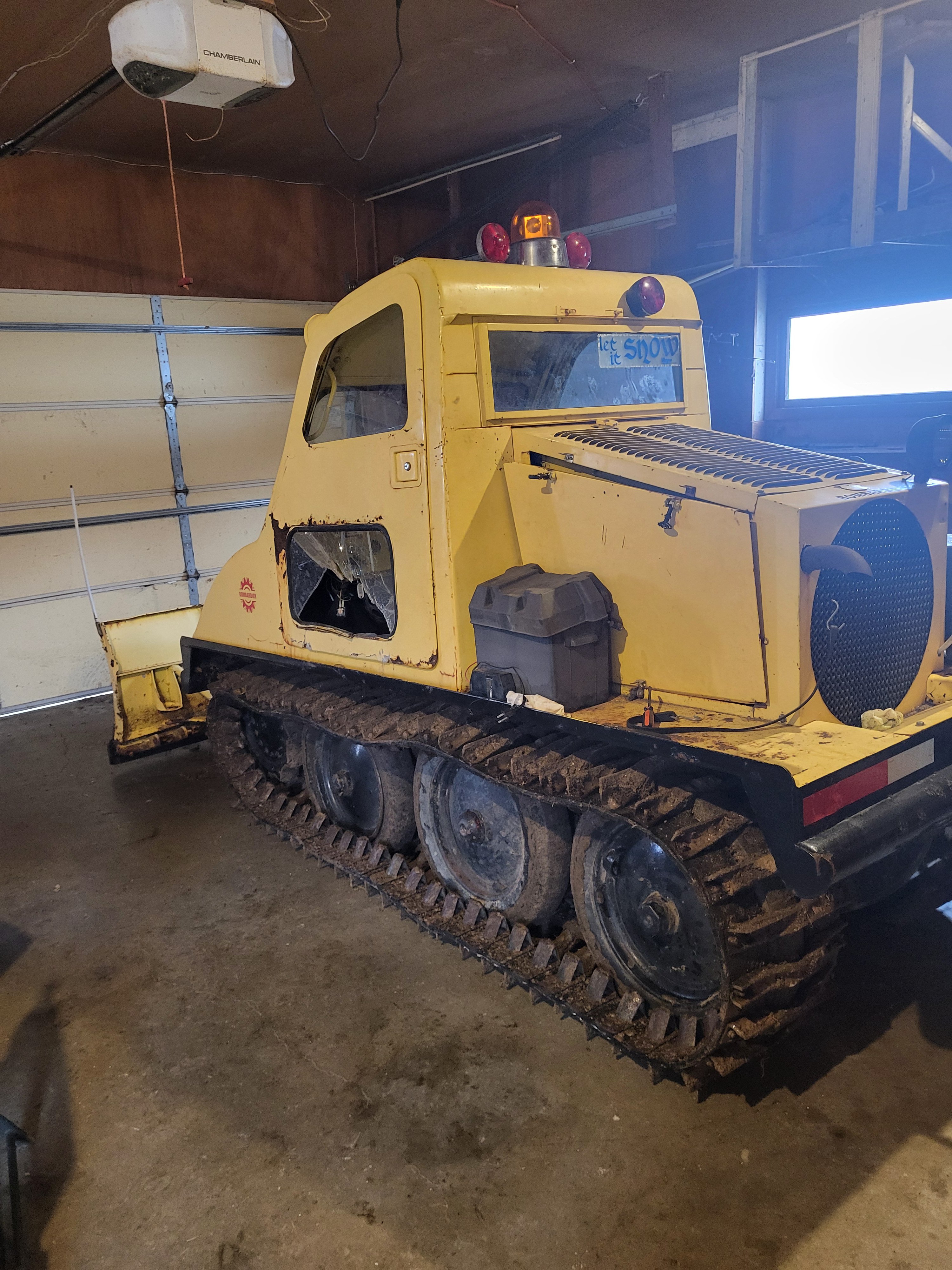

Benny barber
Looking good I'm just getting going on mine. Has the chrysler flat head 6 .runs like a top
