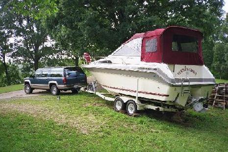

Your rigs sounds very familiar to mine. (she is sold now) I had a Sea Ray Sorrento 25 with the 454 330 hp I/O. Below is a picture of my old rig ready to go and a bonus pic of the "Firstmate" helping out with the tie lines. :D I downsized to a Boston Whaler 13-3.

Nice boat and WOW! Nice mate!
