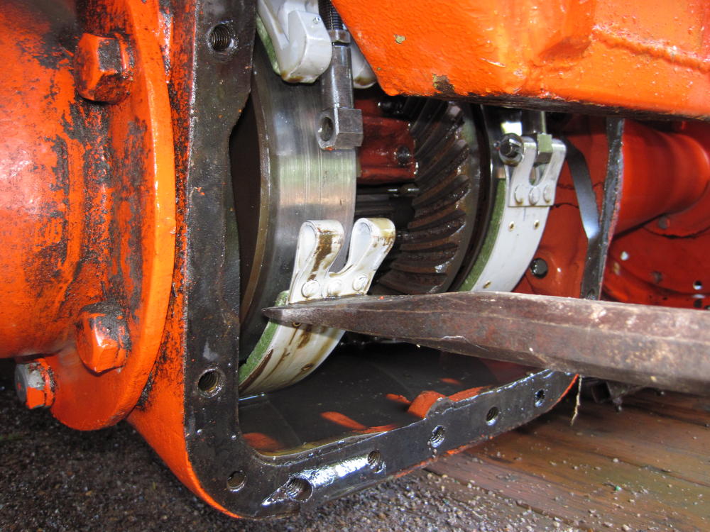

It has been several years since I changed out the brake bands on my Imp, but here's some of the details I recall:
  • I didn't pre-soak the bands -- just put them in dry. They'll have plenty of time to soak in the oil once you fill the differential.
  • I had to grind off just a bit of a high point on one bracket on the bands (don't remember exactly where) in order to clear the case when feeding the bands around the drum. Sorry that this is so vague, but if you can't quite pull the bands all the way around the drum then think about getting out a file or grinder.
  • The only tricky bit (for me) was pulling the bands tight enough to insert the pin holding them to the control levers. I couldn't do it by hand, so I eventually used blocks of wood to create a fulcrum and a six-foot digging bar as a lever. See photos below.
  • When it comes time to fill the differential w/ oil then pop the plugs off the side and top and fill from the top till it pours out the side. Then stop.
  • There's not a lot of torquing involved -- just tighten the various bolts a reasonable amount.
Don't be surprised if you have to go back in and cinch the bands a bit tighter after a few hours of use -- it seems like it takes a bit of time for everything to settle in to where it belongs.

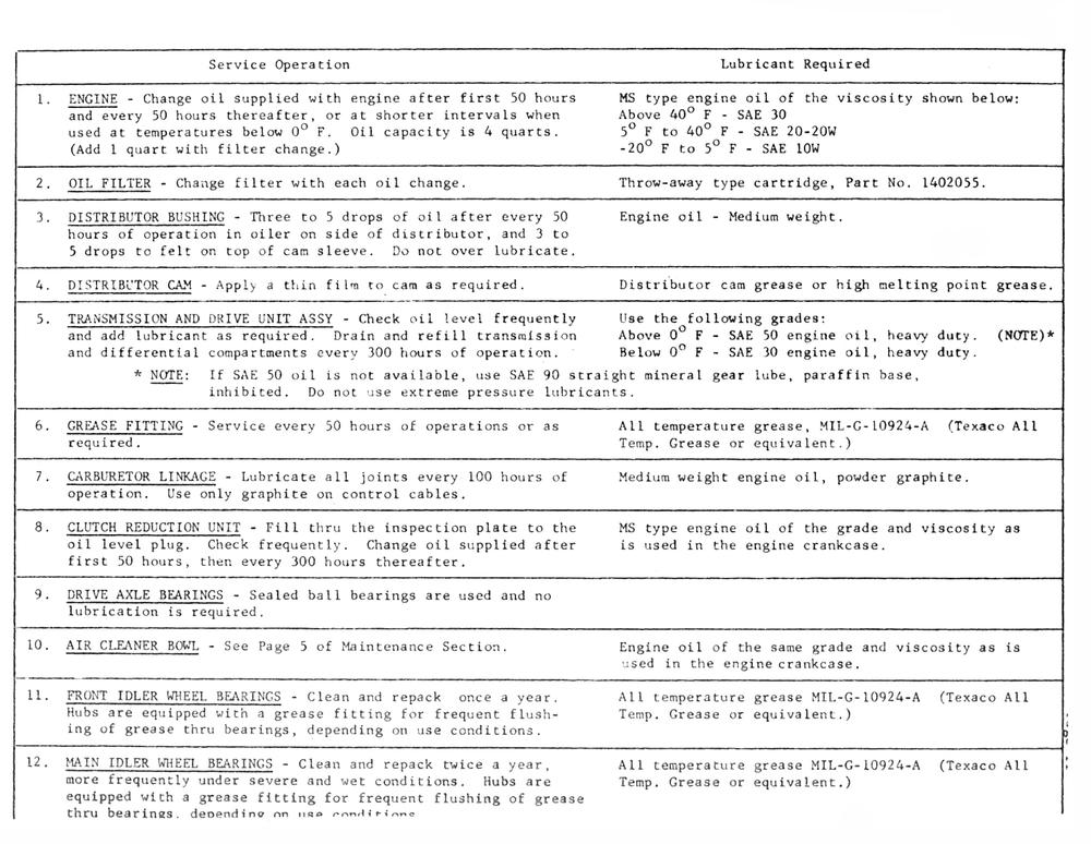

Also a page from my 1402 manual with lube specs.
I run 50W aircraft engine oil as per the 1965 manual for the 1402, which is the same rear end as your 1404.
There are other modern oils you can use like Shell Spirax 50. The main thing is, make sure they are GL1 spec. GL1 has no additives (sulphur) that will corrode the bronze bearings in the gearbox. If it stinks like sulphur, don't use it.

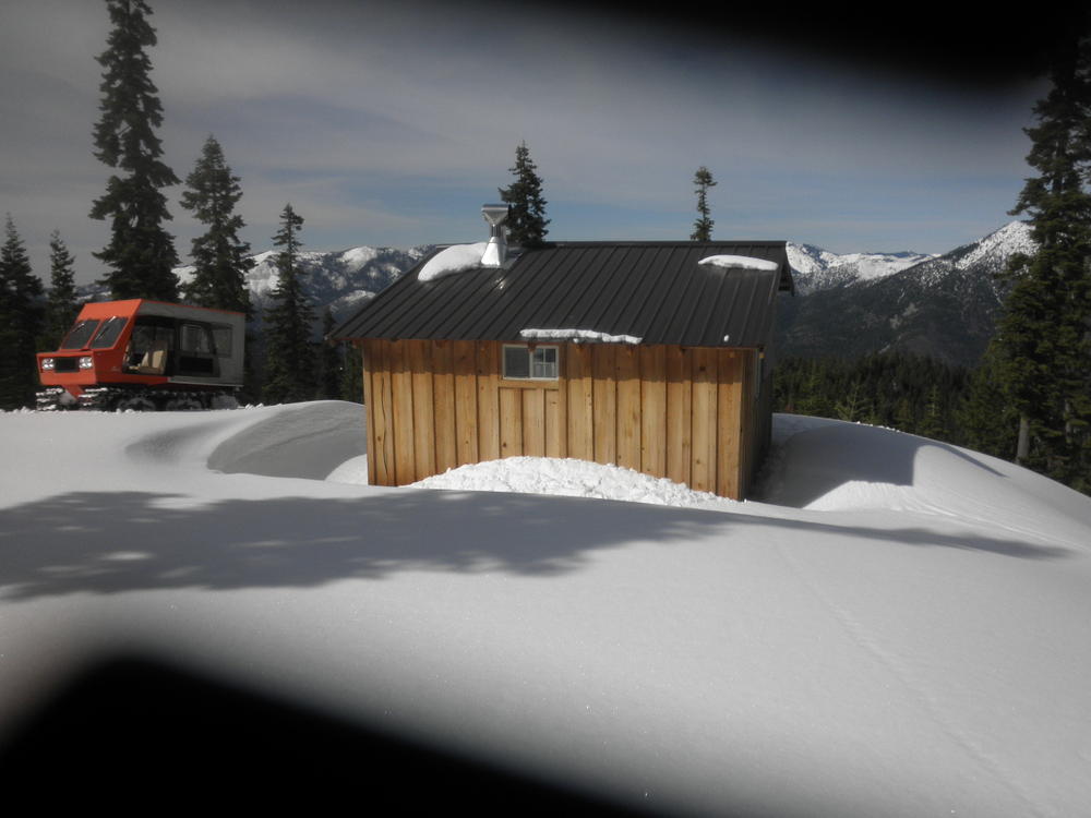

Well, I got'er done and took it for a ride to my cabin. So far, so good. I wanted to thank everyone here for the helpful information. Couldn't have done it without you.
