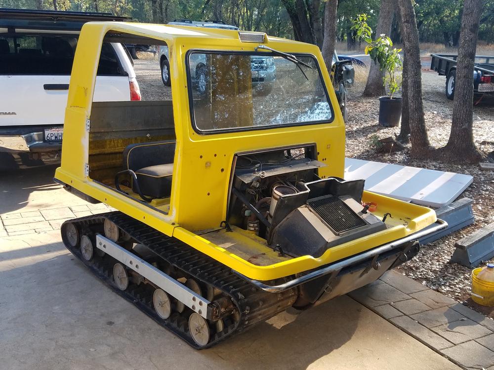

Picked this puppy up for $200 yesterday up near Burney, CA. Former Burney SAR machine, picked up by a local who passed on the family gave it a neighbor. This guy was going to just take it to the dumps but figured he'd try and post his first ever for sale item on the net. I called him 10 minutes after his Craigslist post and bang, it must have been meant to be.
Compression test looks good at 100 and 110. Need's a new CDI or I may convert to HEI. Perfect for our cabin up on Donner Pass to haul supplies and the sleigh.

The serial/Model number on this machine is 344014 and 898000-7410 and it has the later 29HP motor. I'm at the point where I need to replace the CDI to get it running and determine if I want to restore it or just sell it.
Has anyone swapped for HEI ignition on the OEM motor?

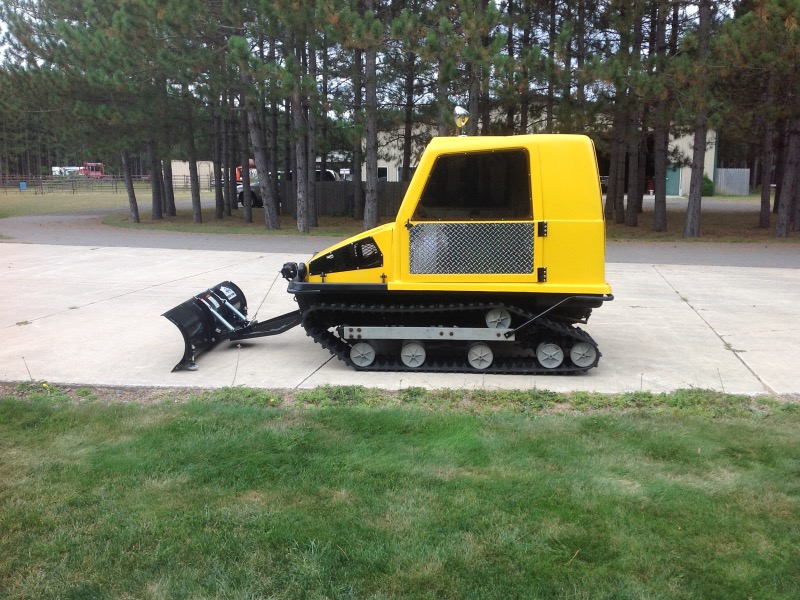

Your better off going to a fourstroke here is one looks like yours we did new tracks new engine tinted window
We have done several 24 Honda, 29 HP liquid , 27hp Kohler have a couple with the original motors also unrestored at this point

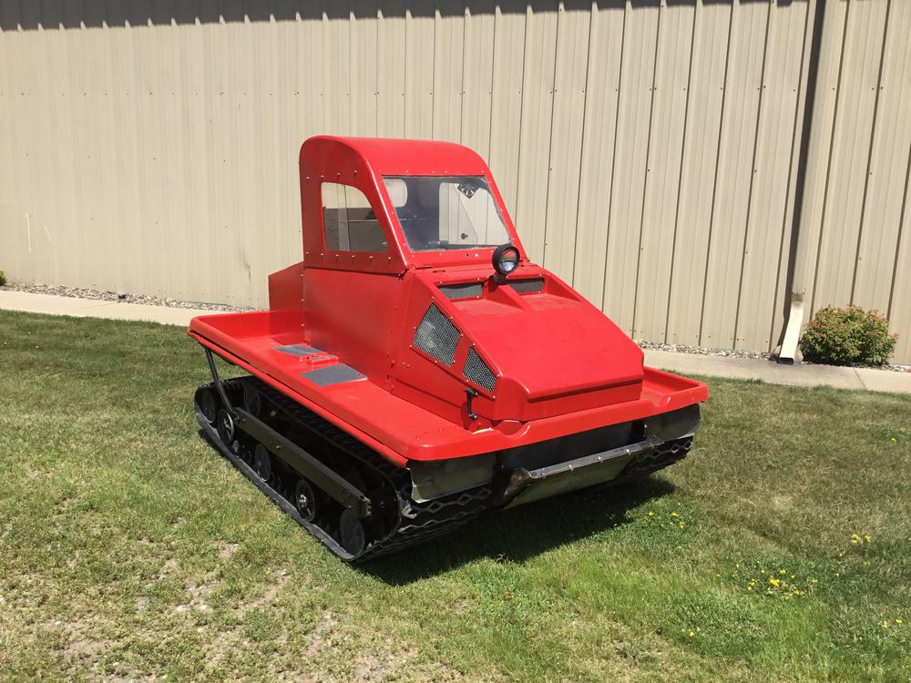

We call this one the Cush-kaw-Bom
29hp Kawasaki engine
Bombardier one man cab
