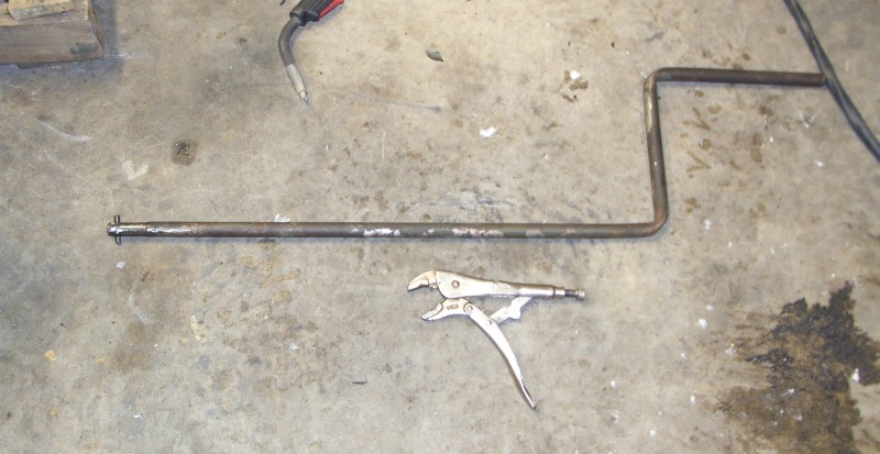

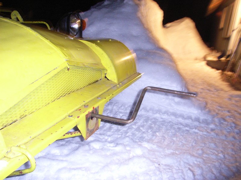

Woohoo! Houston...we have lift off! :applause: Okay, maybe it's not really that exciting but it's great not having to depend on batteries.
I slapped together the crank shown this evening. Would have been very simple if the pipe I had in the scrap heap wasn't ever so slighty larger in diameter than I needed. I had to lathe an insert of slightly less diameter and joined it to the hollow pipe with liquid metal rivets. Anyway, it's not near as pretty as Lyndon's, and doesn't have the spring-loaded plunger but it works. I couldn't be bothered with waiting to bend the offset in the pipe for the handle before I gave it a try. I grabbed the end of the straight pipe with the vise-grips and it started on the 2nd crank. I was surprised how little effort it took. Oh, I had to remove the winch mount to access the "crank hole."
Thanks for all your input and thanks especially to Lyndon for the stories. They are very entertaining :yum: . Keep 'em coming. I'm not sure AAA will be able to save me where I go Anita. If I get stuck I just might find out how to use the helicopter hooks!:yankchain:

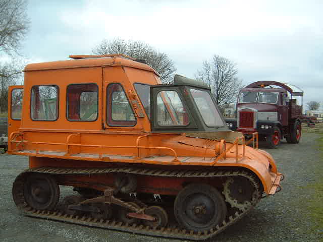

I thought I had better add a picture of my snowtrac which we took last week when Phil delivered the 'new' top for mine. We balanced the 'new' top at the same height as mine on the bonnet and you can see how out of proportion the old high cab is!
Lyndon
What a shame! Tall cab's a vertually non exsistant in North America. The fact is I've never seen one in the US,(Lower 48), Canada, or Alaska. Someone should snap this up.
Ice Queen
I am not doing a canvas top! I can't tell you more at this point as it is top secret and if I told you I would have to kill you!! Anyone want a 'tall cab'?
