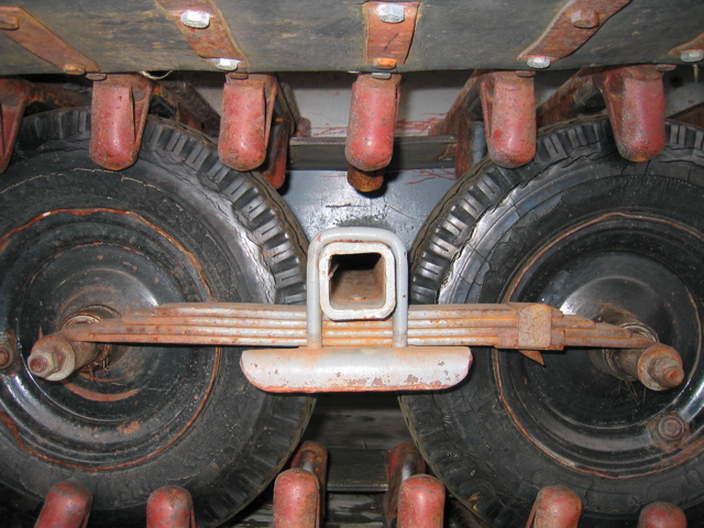

My leaf springs are probably original- look flat. Know I will be looking at a replacement of those as well as tires. Have several questions if anyone can chime in.
1) What do the leaf springs cost?
2) How difficult / costly is it to convert to torsion axle?
3) Does the ride improve with better springs/ axle?
4) Who is the best supplier for tires?
5) Do you stay with factory tire size or is there a reason to go bigger?
Thanks.

1. Leaf springs are not useally expensive(dont know about in alaska)
2. I cant think of any way for you to use a torqflex axel in your aplication.
3. A flat spring with fewer leafs will give the best ride but may lower you gvw.
4. Have you tried northern tool? they're online and have lots springs +tires.
5. It dosent look like you have room.:my2cents:

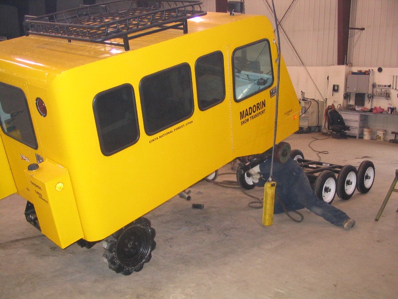

My Imp 1402 is probably the only one in the world that has been converted to torsion axles that I'm aware of so far. It was done somewhat out of neccessity. This cat had the axles changed from the original design by the previous owner. The whole chassis was lifted about 21/2" and the rearend was lowered to accomadate the change. With the geometry change, I was having some problems with the suspension. This is the reason I decided to make the change, plus possibly improve the ride.
There was a lot of calculating and measuring to get it right. I wanted to get the drive sproket off the ground about an inch and a half for a smooth ride. I considered dropping the front idler and adding another axle similar to the spryte. This could be done but I would go to the drop axle C-4 differential like the old spryte has to handle the additional track. I was told that the drop axle C-4 is stronger that the strait C-4 due to the gearing and heavier axles. :confused2:
I welded the whole assembly together and then attached it to the chassis. Some overall length was added, so a slightly longer track was made to fit.
It has worked out wonderfully, but took some serious planning to make it work. The ride is far superior to leaf springs. I believe the larger wheels help a lot too. Just try rolling the two wheels over the grousers of a track and compare the wheel movement. The attack angle of the front end I think helps it get on top of deep snow. It tends to slightly pitch up when in deep powder, just the way I like it,:eek:

MM, I'm glad you posted some picks- I can't get enough of looking at your imp. Serious Imp envy. I also notice you moved your fuel tank(s)- that is something else I want to do. I believe you when you say there was some measuring- and head scratching. Perhaps teeoster and I will follow behind you on the axle change-out. To clarify though- the previous owner did a lift using leaf springs? If so, what problem did the lift create that forced a change to torsion? (hope I understand correctly)

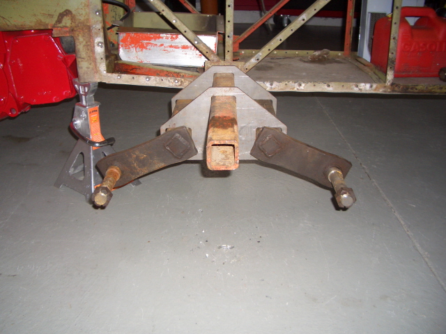

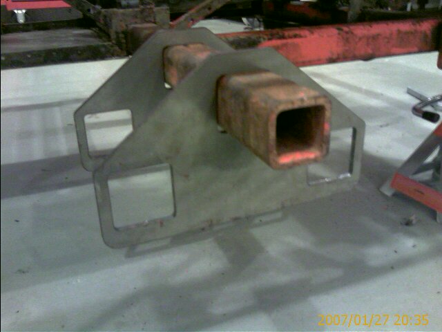

I took a photo of the plates I had laser cut. The torsion axles slip right into the two square holes, one going in each direction. I had two of these made just for fit up, I will probably have to adjust the exact shape once I get the machine put together a little more and see how the weight gets distributed. I guess you could say everything is adjustable until it all gets welded together.
AKdadio
Hey John, that is pretty much what I had envisioned you meant. Looks like you are designing in some lift too. (?) ps, engine is in town- haven't picked it up yet.

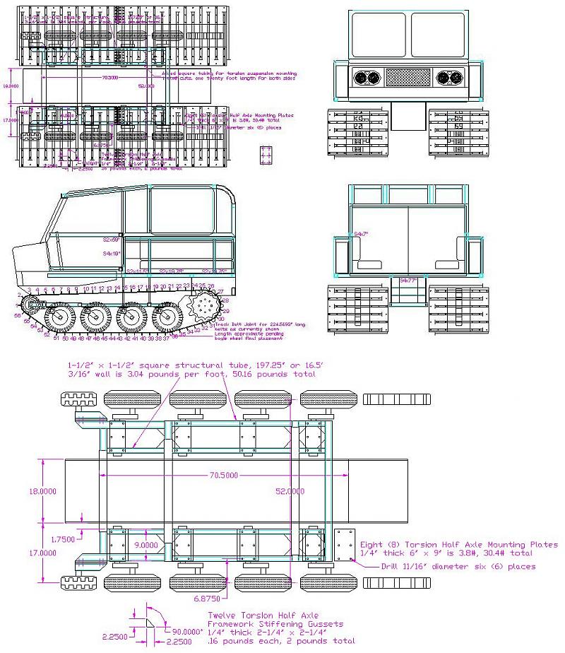

Here is a screen shot of a design generated in AutoCad to convert a 1404WT Thiokol Imp to torsion suspension.
This design uses torsion half-axles bolted to mounting plates that are welded to a sub-frame boxed in with the existing square tubes. In addition another square tube is added in the rear for support.
The sub-frame is made from smaller square tube so that it can be welded at an angle to the existing tubes. The torsion half-axles come with a camber built into the mount so as weight deflects the torsion axle they do not end up "splayed out". Testing with the maximum weight on the torsion half axle showed about 1/8" deflection.
The torsion half-axles chosen have removable trailing arms with an internal spline that mates to an external spline on the torsion mount. This allows for adjustment of the angle of the trailing arm.
The bogie wheel locations have been chosen so that there is no possibility of contact between bogies, front idlers, or rear drive sprockets, regardless of trailing arm position. (If someone decided to mount one as a leading arm, then all bets are off.)
The cost for the steel, torsion half-axles, hubs, tires and galvanized wheels was less than the cost of the springs, u-bolts, spring plates, spindles, axle bolts and replacement tires and wheels.
These suspension modifications are just beginning, so it remains to be seen how the end result turns out.
The labor cost to design and install the sub-frame, well you're not suposed to figure that in are you?

Nice research and CAD work.:respect: Would you disclose the maker of the torsion axles? I like that they are adjustable.
I am very surprised that the torsion setup could be less $ than leaf springs, since trailer springs are about $20 each.
-Pat
GSSD06
Yes, leaf springs are cheap, and easy to get made a lot of places around the country in any configuration you can imagine. The expensive part of a suspension rework for me was the hollow tube spindles (1405011) and shoulder nuts (1405012). A previous owner had put in some grade 2 axle bolts and did not preload the spindles or lubricate properly, so they needed to be replaced.
The torsion half-axles I purchased from Southwest Wheel are Flexiride FR-1400B made by UCF America with 5 lug on 4.5" bolt circle and 2-3/4" pilot hubs.
http://www.etrailerpart.com/halftorsionaxles.htm

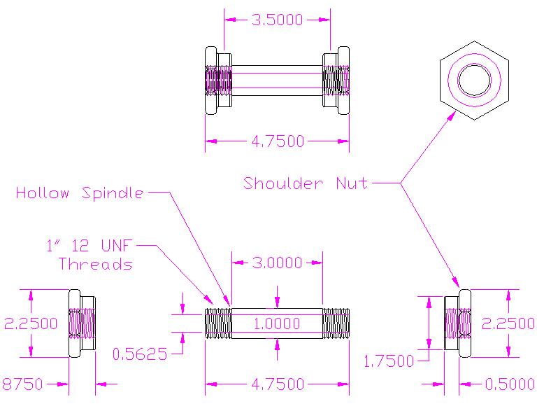

The FR-1400B is the smallest half axle in the series with the splined trailing arm. The smaller sizes have fixed trailing arms. The FR-1400B is rated at 1400 pounds per pair, so heavier than needed and will no doubt be a stiffer ride than desired. However I have yet to ride in a two-track snow cat that did not have a stiffer than desired ride on those hard packed bumpy roads.
I even went so far as to reverse engineer the spindles and shoulder nuts and get a few quotes from local machine shops. But the overall cost of properly reworking the suspension with the part sources I found was higher for the stock spring arrangement than for the torsion half-axles. By the way, the drawing of the spindles and nuts was for quoting purposes only, not sufficient to make the parts properly.

Hi mtncrawler you bring up a good point I had no idea about when I designed the suspension modifications. The drawing shows the trailing arms mounted to give more ground clearance, but could just as easily be rotated to the stock location.
I was never happy with the lack of track tension adjustability on the Imp. But it did not seem to be that much of a problem, perhaps because I did not encounter situations where it might have been.
Also, when I developed that design I was struggling with an "easy" way to make the front idler adjustable. Now that I have a Super Imp, I find the track adjustment very useful. The bulldozers we had when I was growing up also used a grease gun to tension the tracks.
What I do with my Super Imp is tighten the tracks just enough so that I do not jump a tooth on the drive sprocket when I am going down hill and make a turn. I find that when the track pops over a tooth it is really hard on the sprocket.
My plans for the Imp have also changed. When I designed the torsion suspension I was planning to modify the two person cab to a full cab and wanted extra weight carrying capacity. Now that I have a full cab Super Imp, I want to keep the Imp as light as possible for better deep powder performance and to be able to get up that last steep pitch at several radio sites I visit in the winter.
Also, now that I know more about the Imp differential compared to that in my Super Imp, it is another good reason to keep the Imp light and not over tax the differential. For this winter I think I will keep the cab completely off the Imp, add a roll bar, maybe a soft top, and hope for some real deep snow to test out the performance.
I appreciate all the comments, they are very helpful to consider the pros and cons of several options.

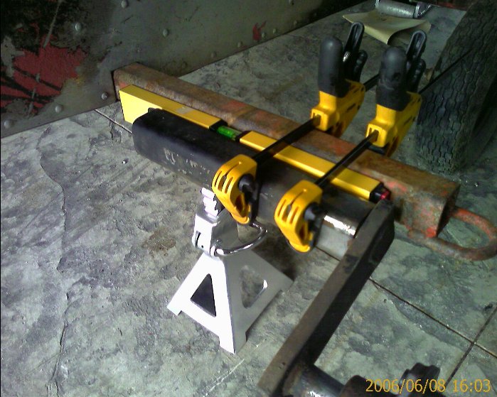

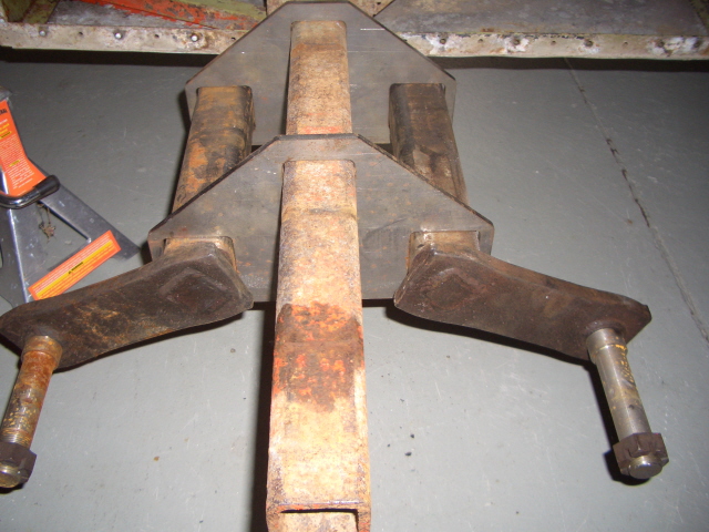

Teeoster

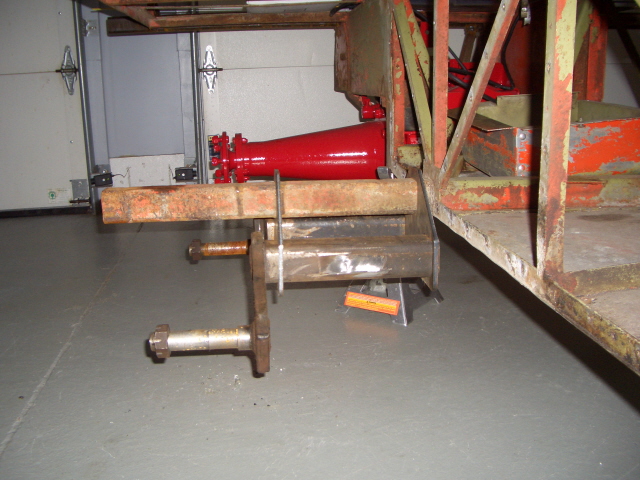

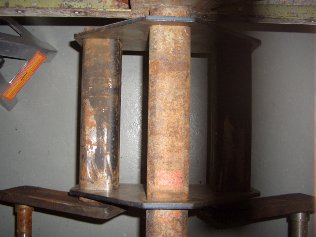

You guys got me think about the suspension on my IMP again. I have not had the chance to work on it lately, but have put some thought into the design I came up with. I attached a few more pictures to better illustrate what I am trying to to do. I value the engineering savvy of you guys and appreciate any comments or suggestions.
I an effort to get the maximum results per $ I am trying to use these surplus axles I came across a few months back. this guy is literally selling these 1400# axle assemblies to me for $50 a piece, and he has allot of them. Enough to share with my IMP'ing friends if this works out:beer: Before final welding I intend on using a fixture to make sure all the hubs are in line with the rear end and square to the rest of the machine.
So the prototype mounting plates I had made at my shop are just that prototypes and can be changes in anyway to accommodate attack angles, ride heights, camber, ect.
I guess I have a few concerns I would like to ask the experts opinions on, and please feel free to toss any possible suggestions out there.
The fist is track and guide clearance; I have 24" drop center grousers, will they clear, if not will small well placed "skid" plates solve the problem?
The second is proper suspension for weight; Will the 700# each torsion units be enough, or can they be rotated to individually tune the specific location they have on the machine?
The third is original frame strength; is the new setup going to exert more twisting force one the frame member it is mounting to than the stock units did? if so is it too much for the design of the IMP frame?
The forth is mounting plate thickness; Is 1/4" material strong enough or should I go to 3/8"?
