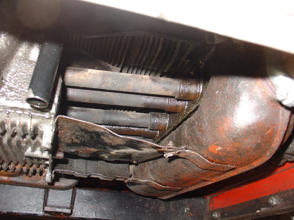

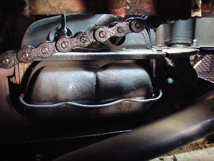

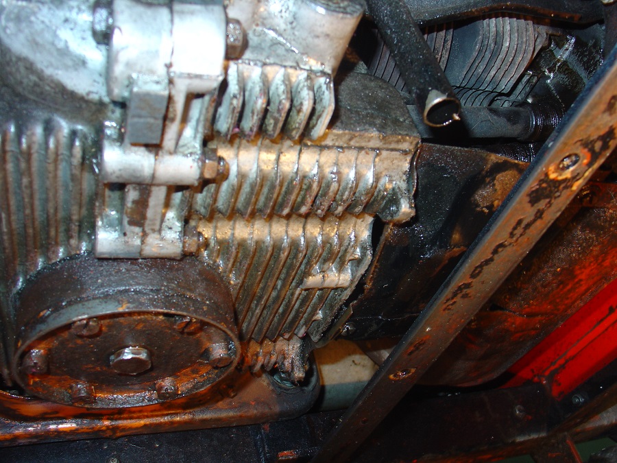

A) Problem - Oil leaking,
I start to work to find and fix the leaks from gravity, or when the engine is running.
My opinion is that the possible source of leaks in my ST4 are coming from:
15% from Gravity!!!!!!!::whistling::whistling:
5% from the Oil sump plate (I have to replace the two gaskets on the oil stainer cover )
30% From the Oil cooler in the fun house (to replace the seals)
5% from the Oil filter and breather (one seal)
45% from the right and left valve covers (Two seals)
But always there are some others hidden sources of Oil leaks that i have to find them in the next days.

300 H and H
Nikos,
Besides the ones you know about,....
I think the leak might just be your push rod tubes. mostly looks pretty dry, except for the shield under those push rod tubes.
I hope the heads don't have to come off to seal them, I don't know for sure...
I think yours looks very original. My bet is it may even have the VW thermostat and fan louvers. Check to see. It needs to be removed from under the engine before you can remove the upper fan housing..
Be sure to look closely at those variator out put shaft seals, behind the small chain sprockets. Those seals like to leak, and are a major PIA to change out.
Regards,
Kirk
Snowtrac Nome
member formerly known as dds
nikos too things 1 check compression any leakage in the cylinder ends up in the crank case check torque on head studs 18 ftlbs for 8 mm studs 21 for 10 mm studs most likely if a 10 mm stud is loose its pulling from the case. if compression is good and heads are tight from your pics it looks like push rod tubes are leaking the oem tubes are steel and will rust until they leak I use stainless steel tubs they will last longer also an adhesive known as pro seal should be used on the push rod tube seals this will keep the tubes sealed even after they loose their spring in the bellows. good luck

Sno-Surfer
You'll also need the round seals for ends of the push rods and you'll have to remove the heads to do it. I would take a better look at it and make sure they are leaking. It's a pain to do it and I think you will have to pull the motor.
I see you also have the temperature sending unit on the oil pan. I just took mine off as it wasn't hooked up anyway and that eliminates one area it could leak from, not that your looks like it leaks much there but we don't like leaks.
Good luck. :wink:
Snowtrac Nome
engines come out easy should take about 20 minuets remove the rockers push rods and heads now is the time to make shure your studs aren't pulling from the case replace the push rod tubes and seals with new seals I use pro seal to seal them up and never have another leak.
