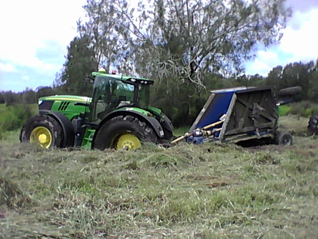

Hi all
Many thanks for the responses.
We have peat so low ground pressure is important.
We can set up for long straight runs so turning may not be a major problem. We may even narrow the tracks a bit.
I will look into the valve dropping issue - did CAT have a fix?
I have attached a photo outlining our problem with high ground pressure tractors
Ian

As a fellow farmer, I have to ask, were you are at.. And what do you grow?
Here in the mid west, it is corn and soybeans. We have soft conditions, but not like your perhaps. Peat bogs are small here..
I still wonder if an older Caterpillar row crop tractor would not be a tougher solution than a snow cat. Wheeled tractors end up around 30-40 psi on the soil. The Cat tractor I speak of is more on the order of 5 lbs. A snow cat is usually in the 2 lb. or less per sqr. inch. I am not sure you could tell the difference real world. I have seen these Caterpillar tractors sell for very reasonable prices. Good support, and parts availability would definitely be a plus as well..
There is a Detroit diesel powered Tucker in the buy sell trade forum right now for $22K. The 1744's are a beast of a snow cat, and have been used in farming. Might check it out..
Regards, Kirk
