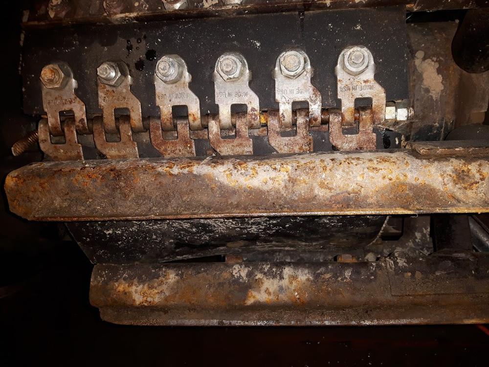

Default Where can I buy new lacing?
New?

Mining, mill supply houses should have it.

Do a search for Conveyor Belt Lacing for a local source in your area.
There are lots of different types, might be hard to match up your current joints, but you can replace the whole lacing system if you can't find compatible parts.
It can be purchased mail order from industrial supply houses like GRAINGER, EMURDOCK and others:
https://www.grainger.com/category/la...ecatalog/N-9qt
http://www.emurdock.com/flexco-allig...lt-lacing.aspx
This one looks fairly close >>> http://www.ashlandconveyor.com/categ...or/belt-lacing

I just bought a 36 strip of Flexco 375 for my Tucker. This was the cheapest place I could find online but took a week to fill order. The strips can be broken into any length by 1 increments. You can buy them in singles, doubles, or other lengths.
https://www.mrosupply.com/conveyors/..._40023_flexco/
