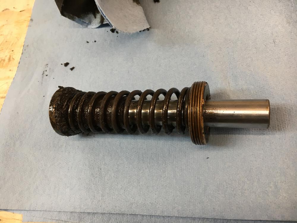

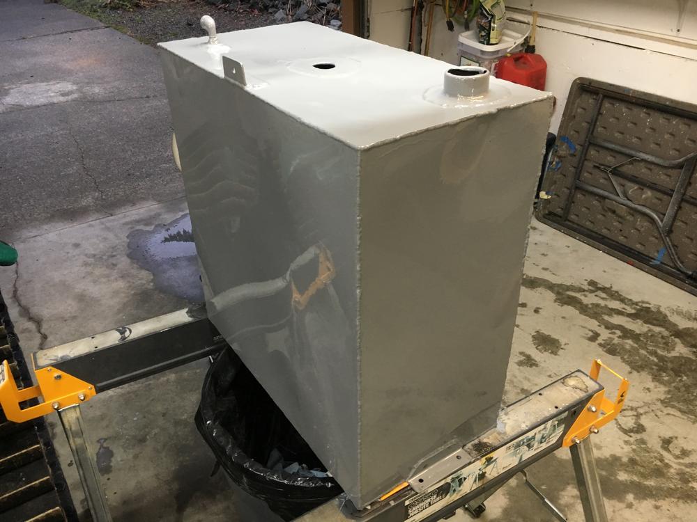

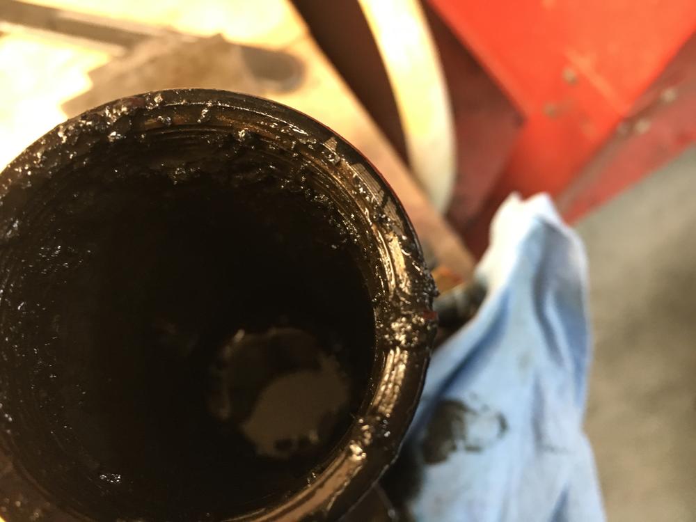

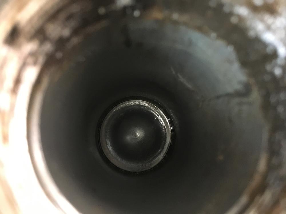

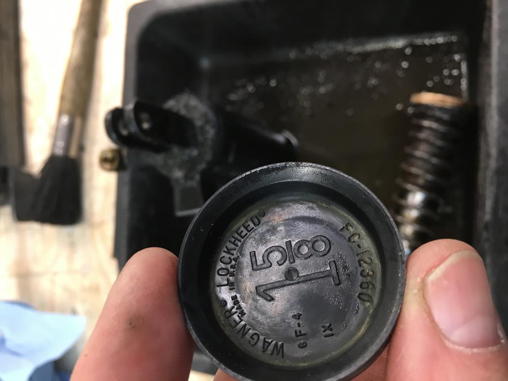

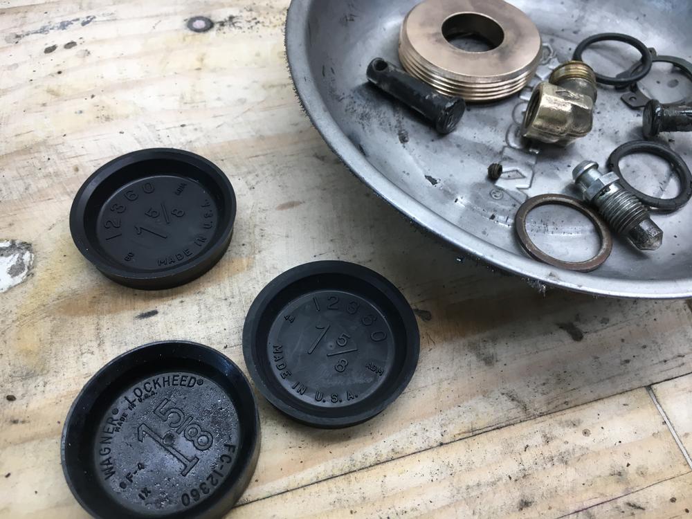

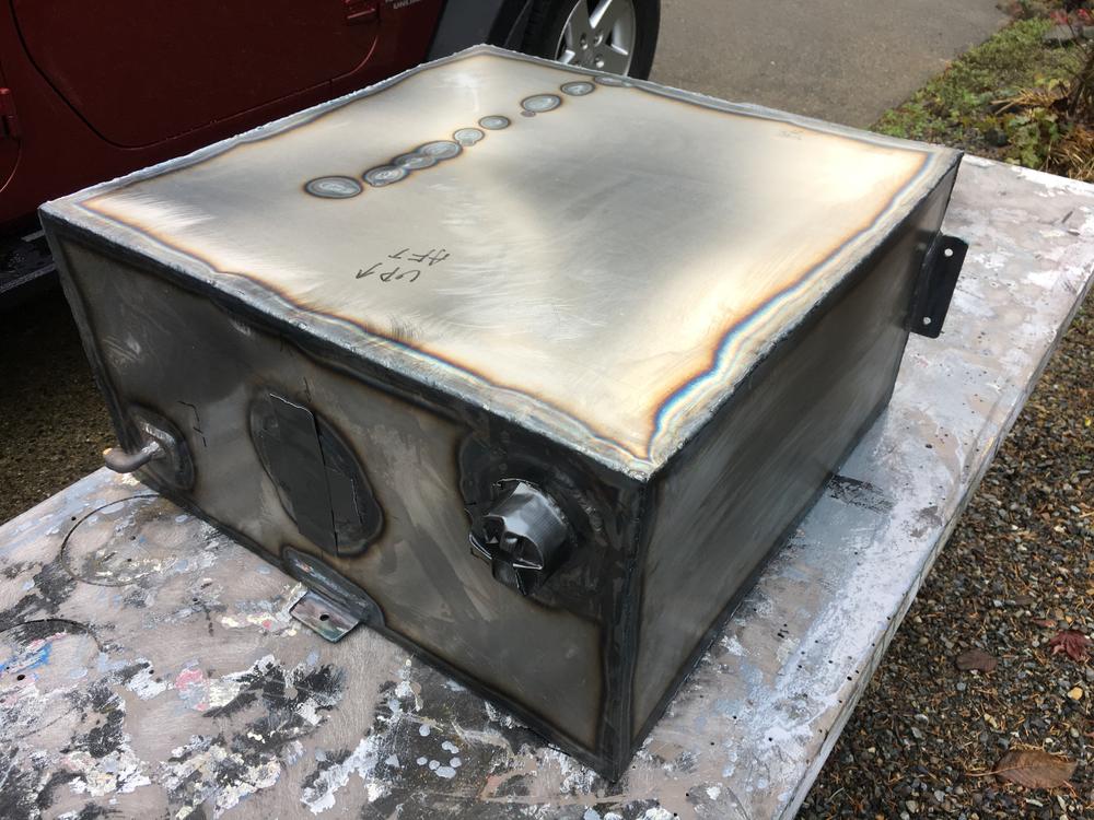

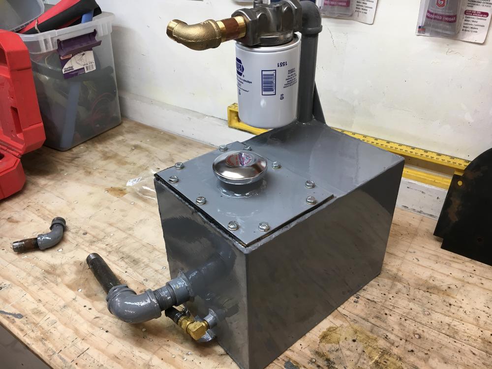

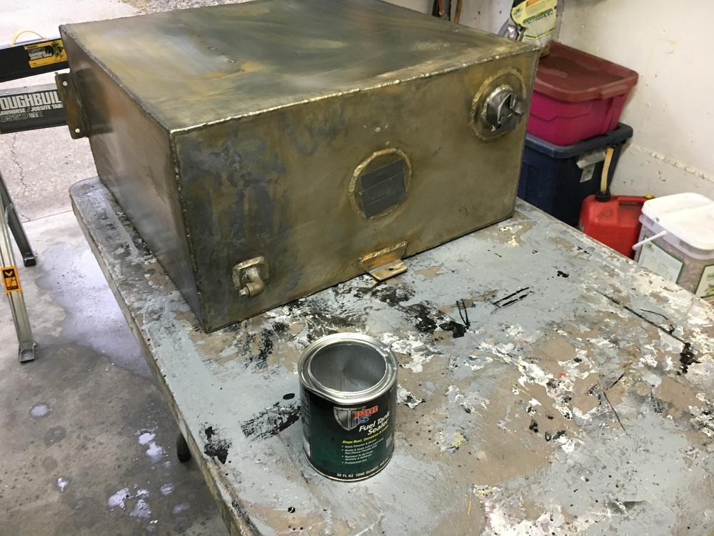

After welding on the mounting brackets, I cleaned the interior of the tank, metal prepped it and poured in the tank sealer. In between flipping it around numerous times, I removed the leaking left brake actuator for re-sealing.
Couldn't figure out how to get the end plug out until Boggie told me about the tiny setscrew holding the end plug in - that guy is a vast storehouse of SkiDozer knowledge and I never thought to look for that screw in the side of the cylinder. He also mentioned I could get a new chevron cup at NAPA, so while the tank drained out the excess sealant, I drove down and picked up a couple of seals. The cylinder has seen better days, pretty ugly inside from water ingress, but the bore was excellent - unlike the spring. So I painted the spring and cylinder with some POR and tomorrow I'll reassemble.
Painted the outside of the tank with the first coat of POR as well.

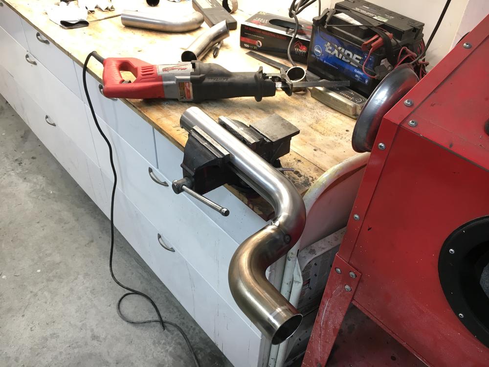

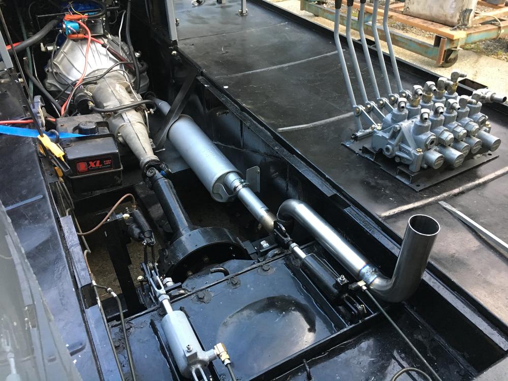

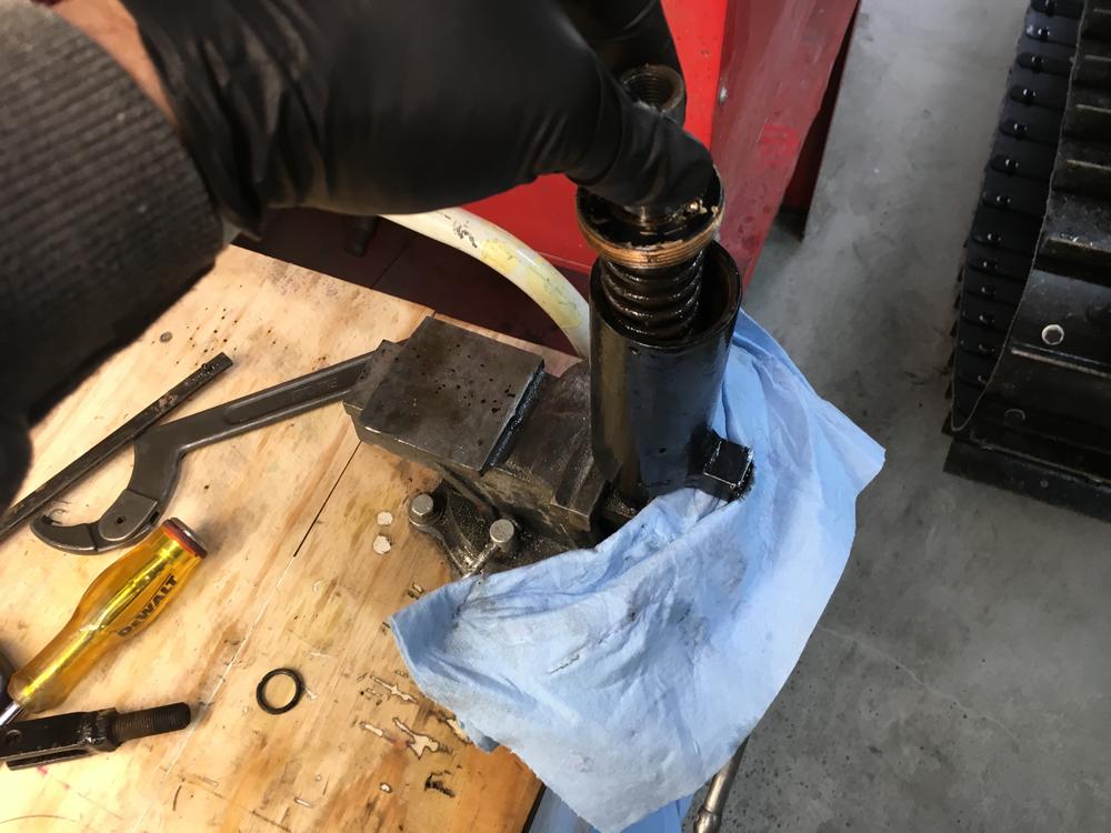

Steering actuator rebuilt, works great now. Next up is to extend the exhaust pipe aft, far enough to clear the extended cab. It will come up adjacent to the fuel tank, on the other side of the tunnel. Pipe is kind of close to the right steer actuator, so I'll build a heat shield into the mount bracket I plan to fab up for where the pipe makes its final turn up. It will run up the back of the aft wall of the extended cab.

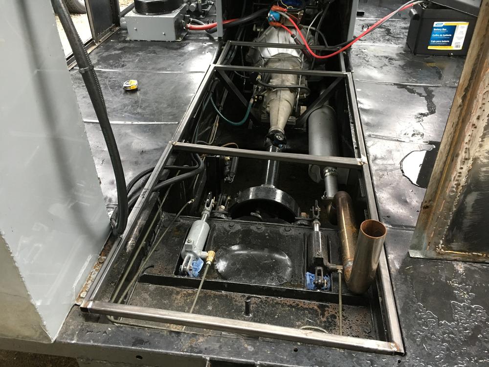

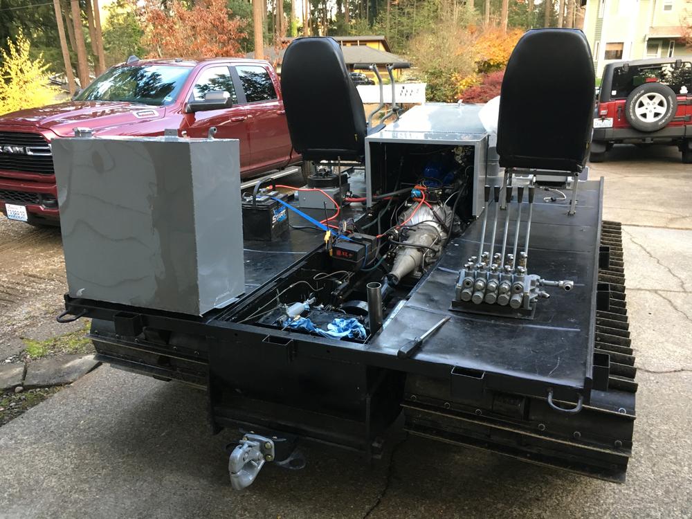

Slowly but surely making progress. Mechanically the cat is mostly done, hydraulics ready to go back in, battery box relocated aft of the passenger seat, the hydraulic reservoir will go next to it. I’m trying to get as much finalized as possible before putting the cab on, access is so much easier now. I spent the afternoon today grinding on the front of the cab, should have it on soon.

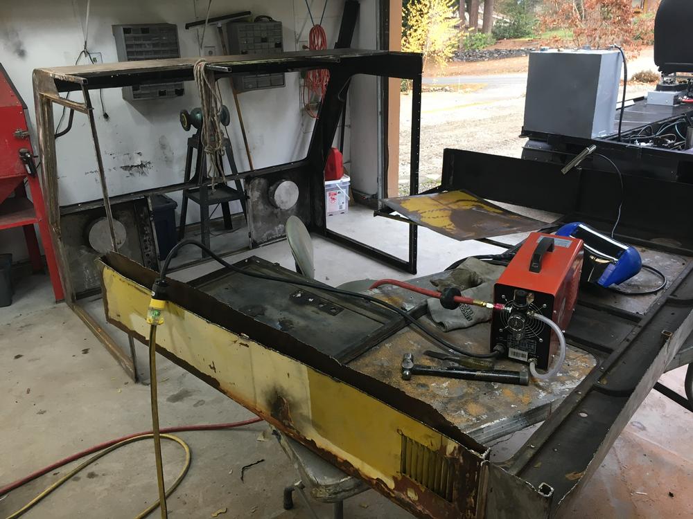

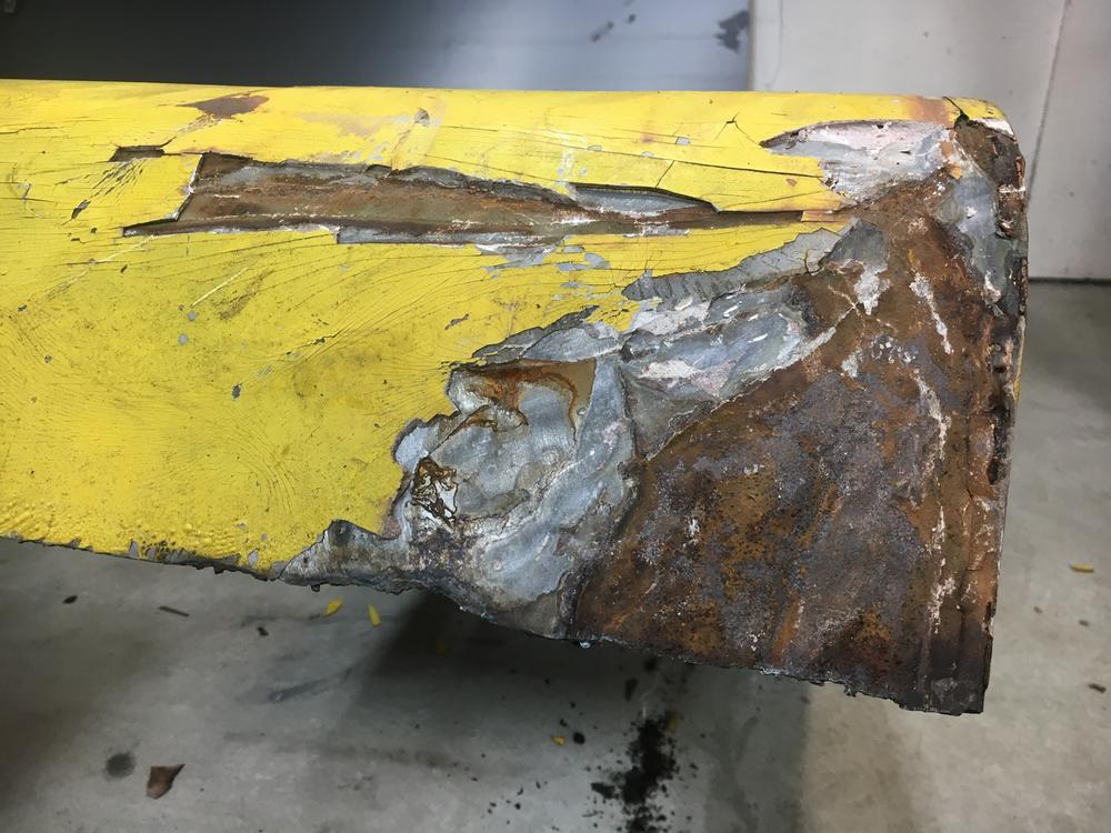

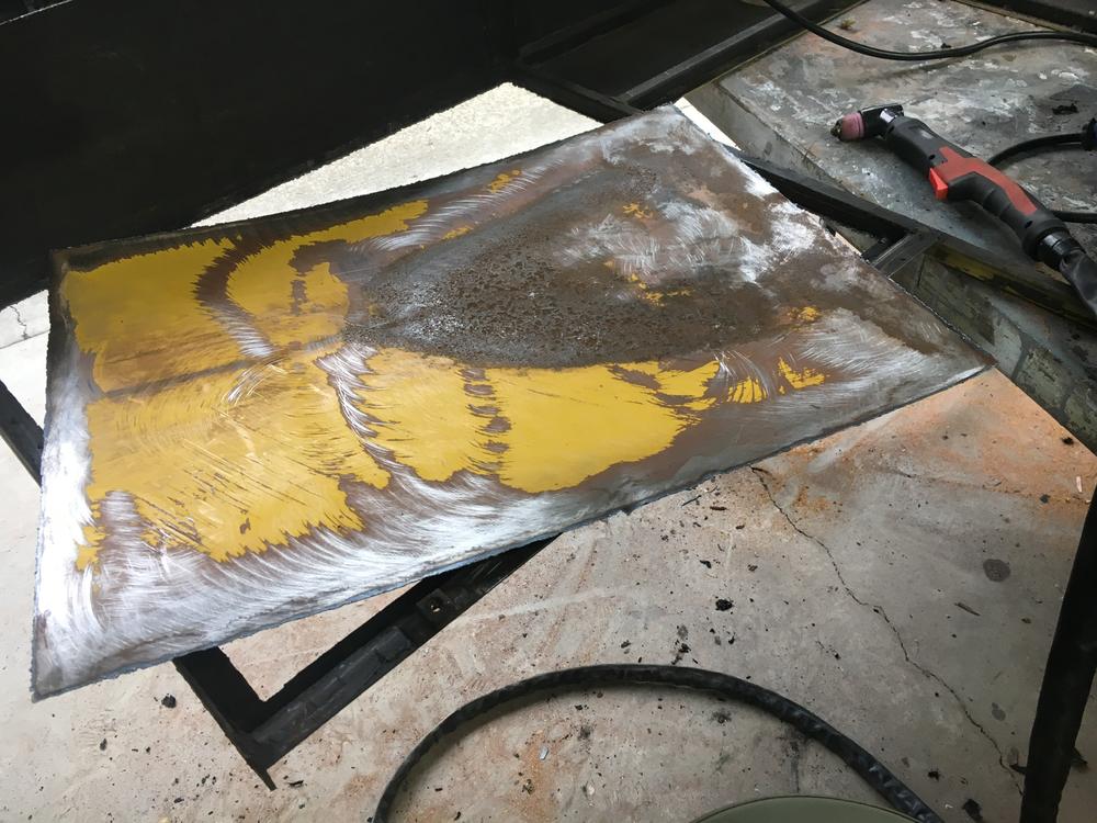

Went to Tacoma and bought a bunch of steel, now I’m cutting out all the badly bent or rusted parts, getting ready to put it back together 54” longer.

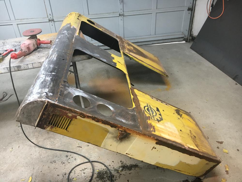

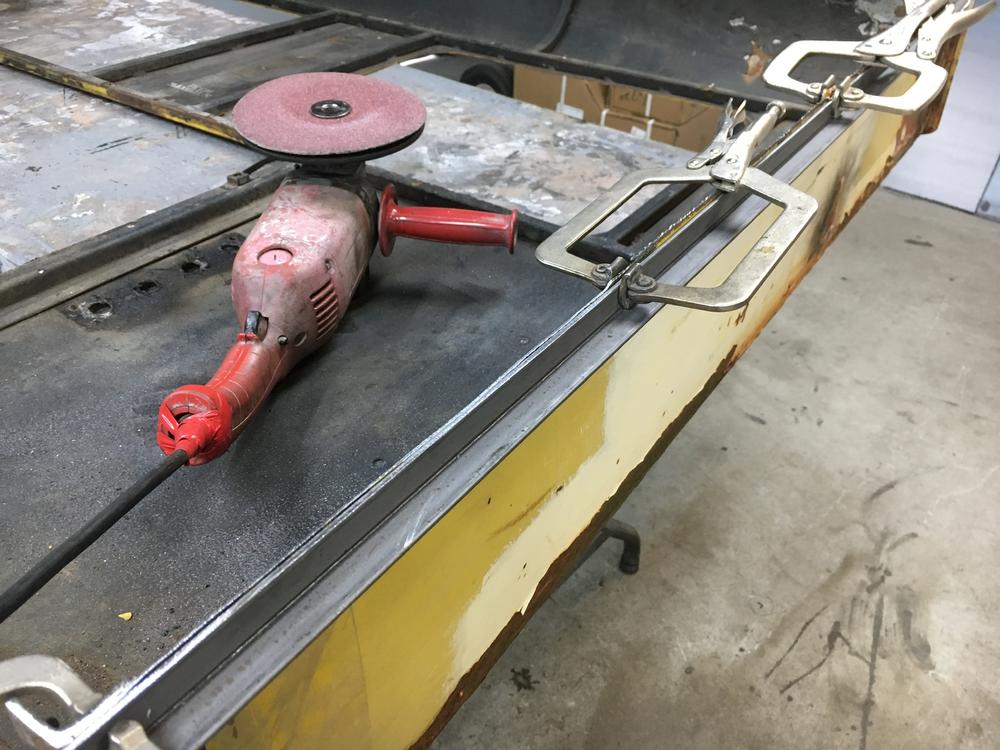

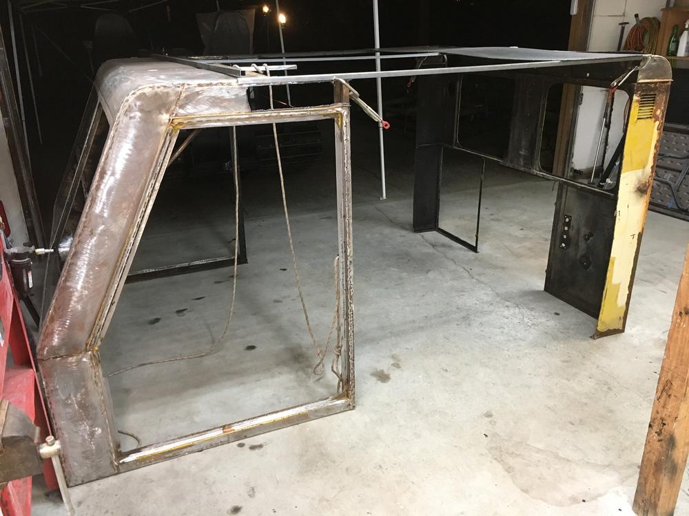

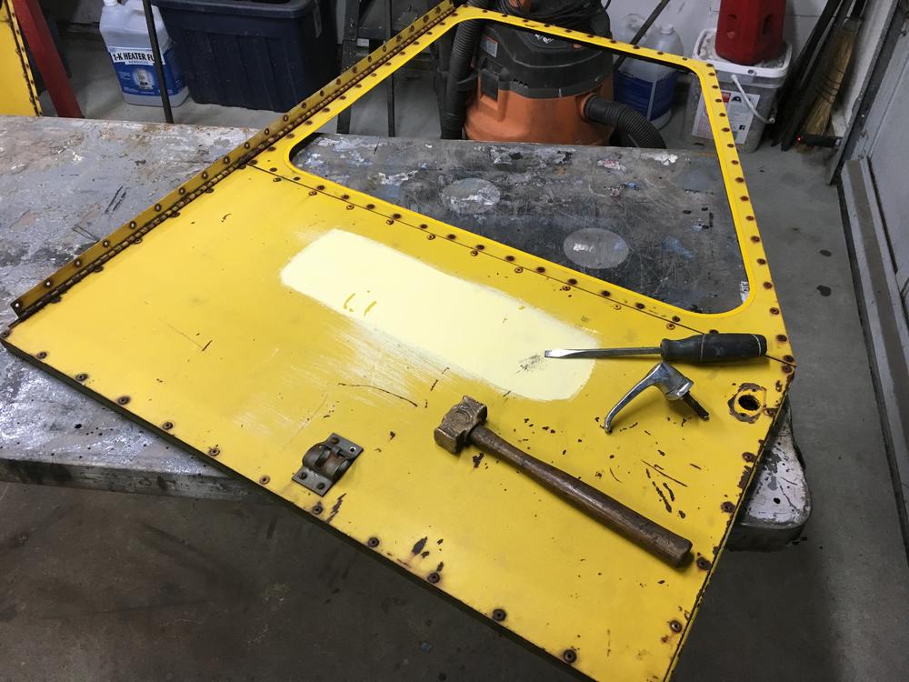

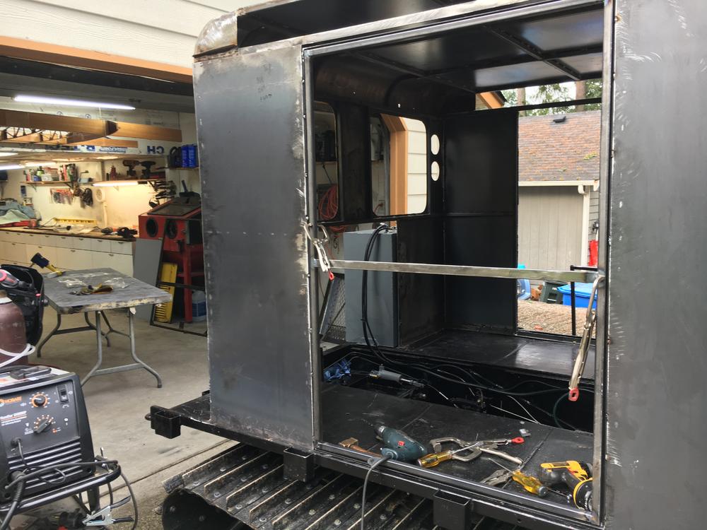

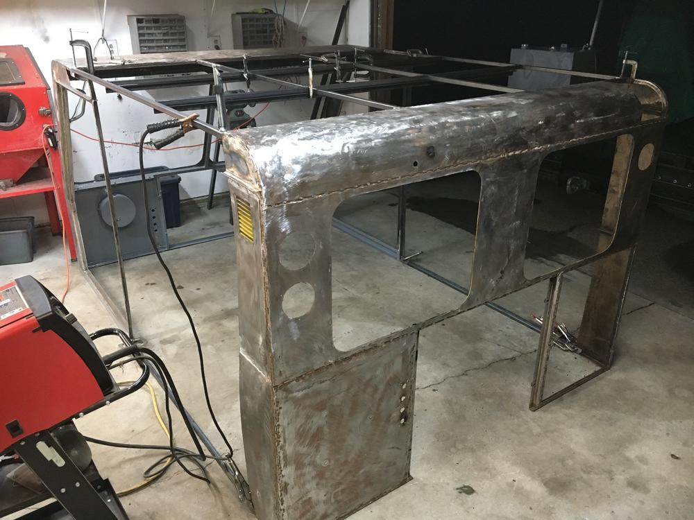

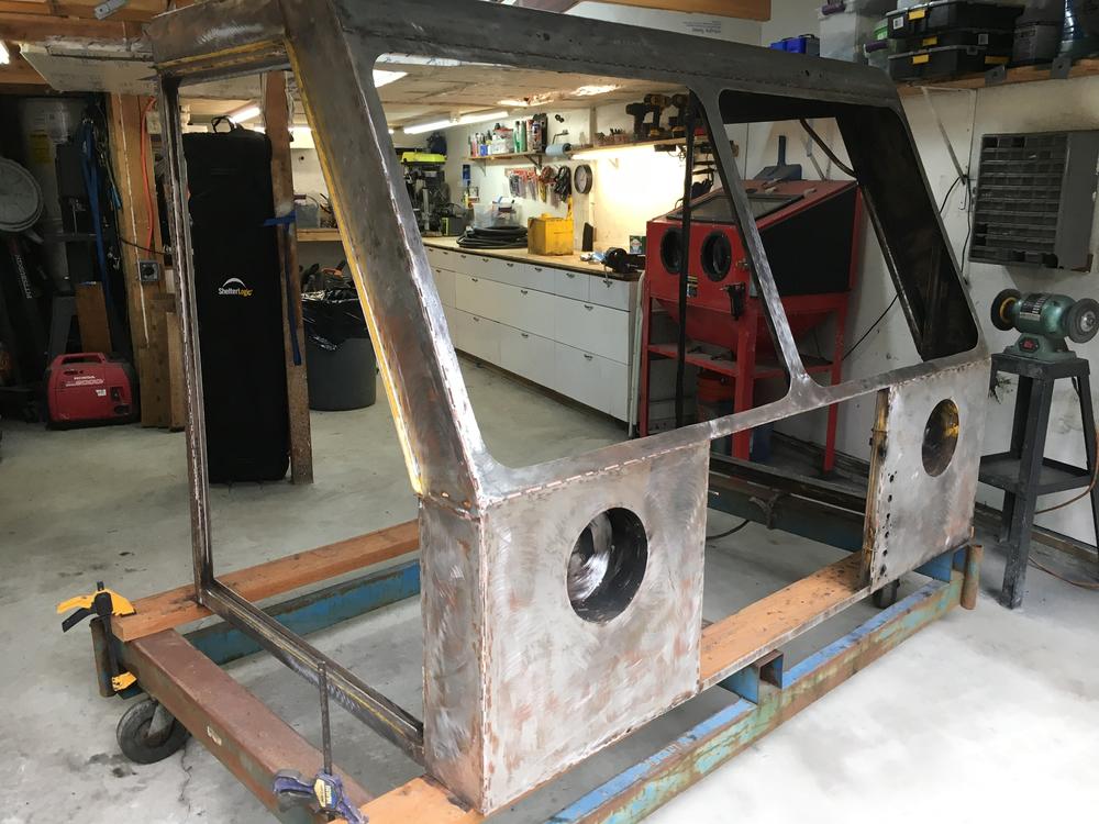

Cut a bunch of square tube today, after much scraping of undercoating from the interior of the cab, I straightened the sides of the aft part and squared it all up and tacked up the pieces.

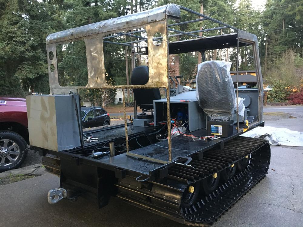

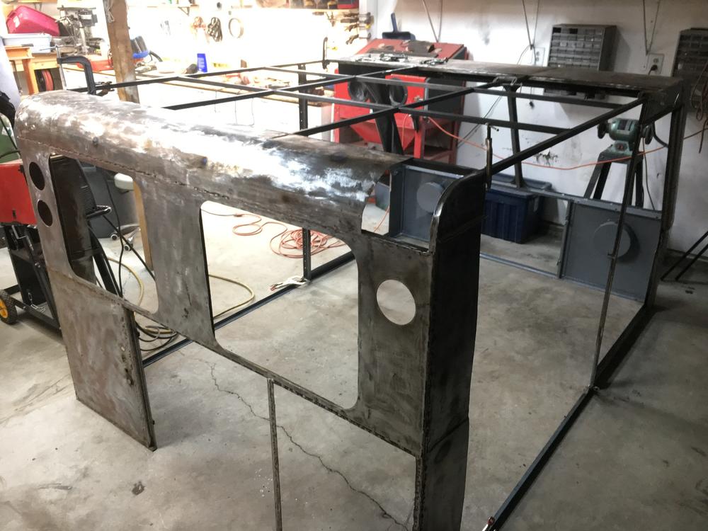

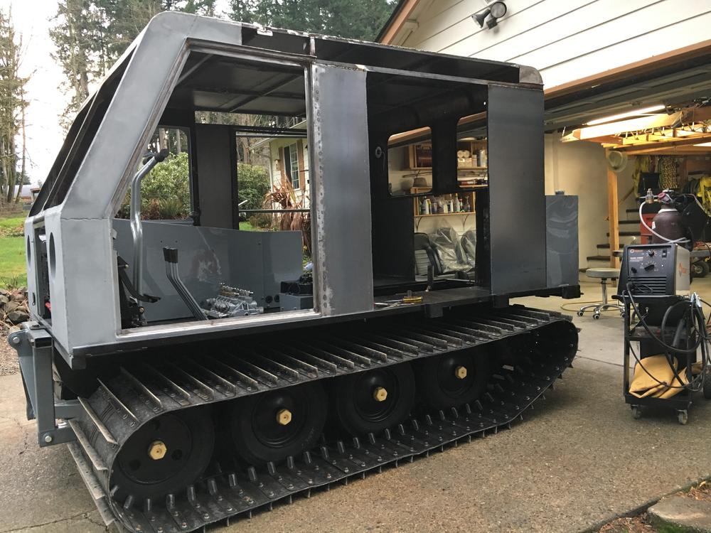

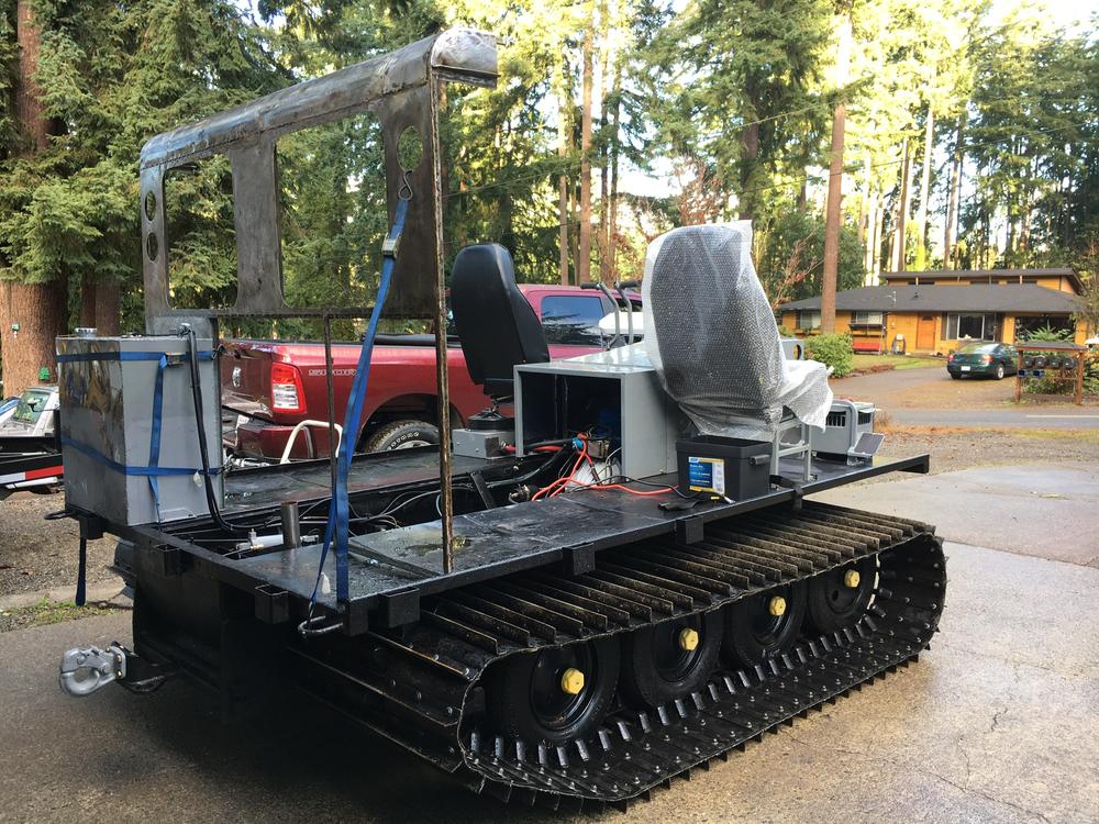

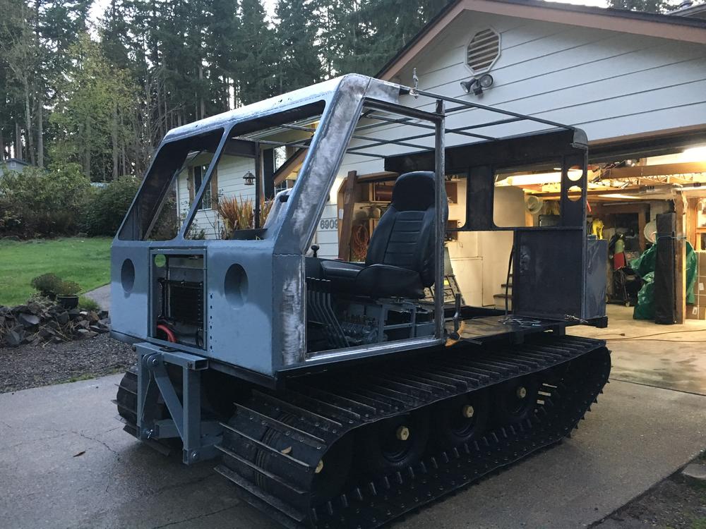

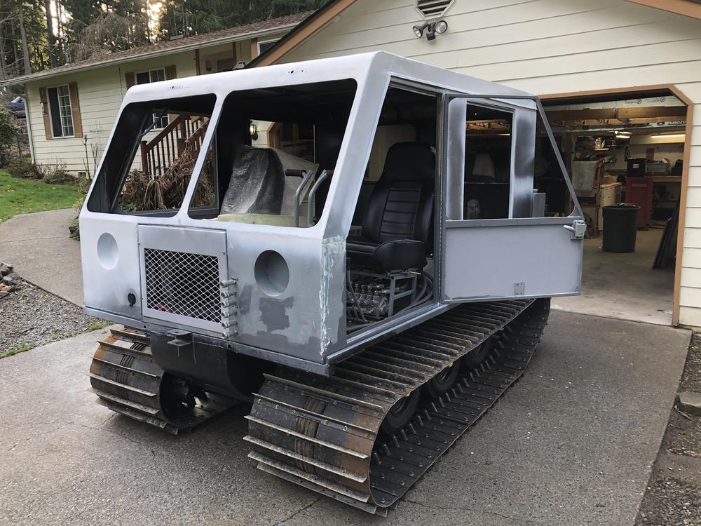

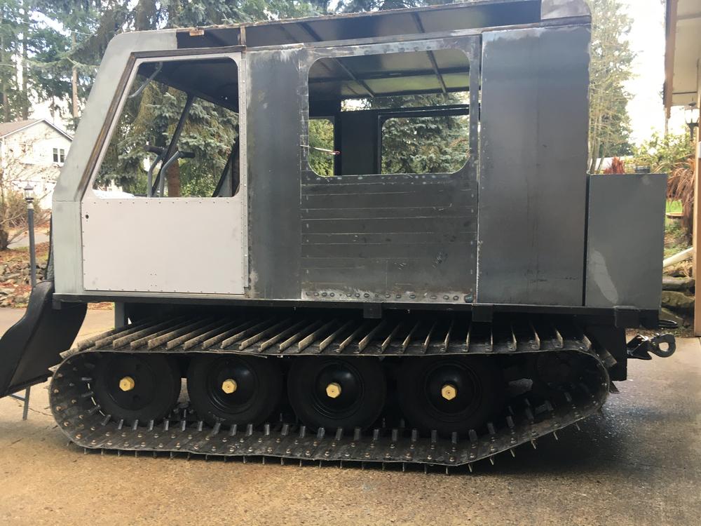

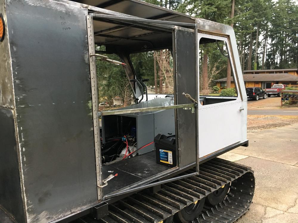

Long day, but I was successful in getting the cab back on the cat - most of it anyhow. Big milestone, now I need to finish framing out the sides, make a couple of aft doors and paint.

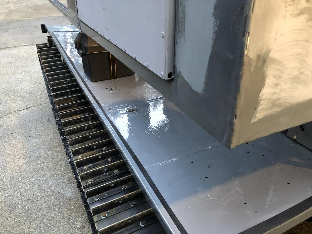

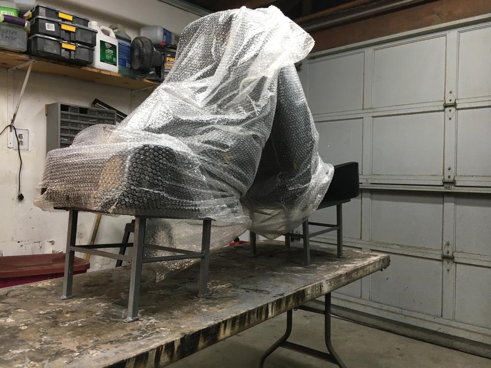

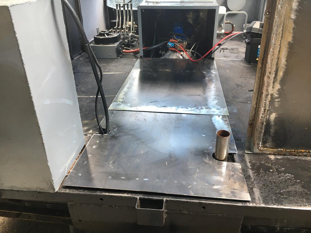

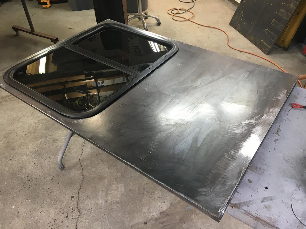

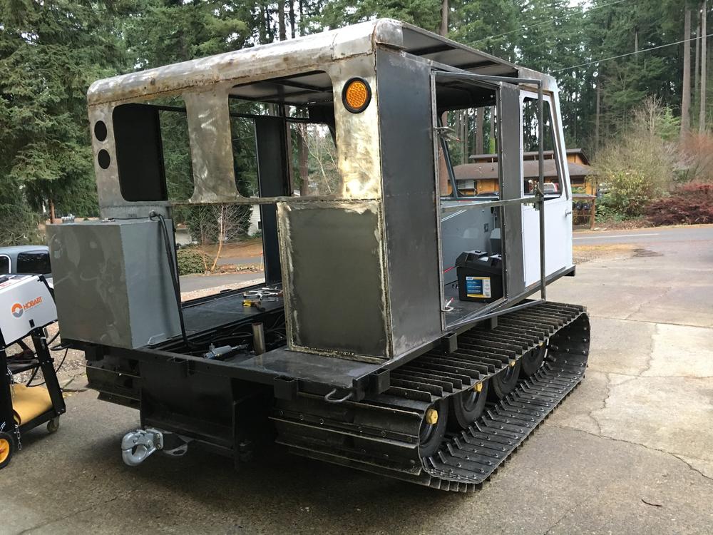

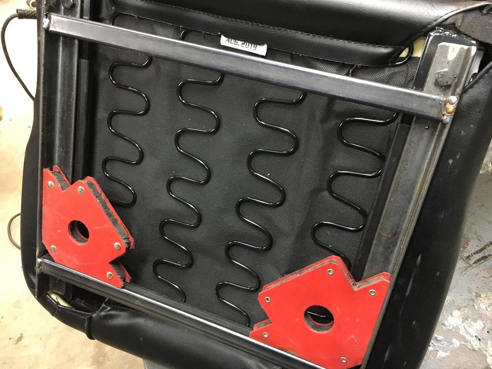

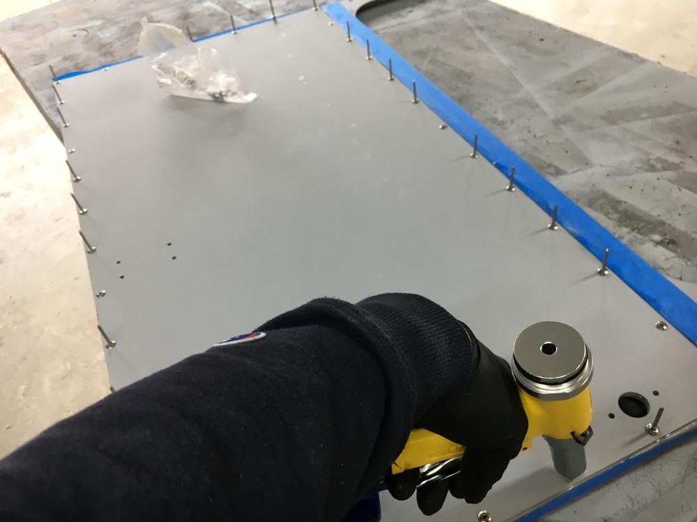

Made new mounting bases for the new rear seats, then got the sheet metal welded onto the roof. I'll get another bottle of C25 tomorrow in preparation for the long turkey weekend - during which it will be sunny and cold, perfect for getting out the doors and side wall framing and sheet metal.
Also cleaned up (de-rusted) the hydraulic tank and painted it with some grey POR-15. Still lots to do...

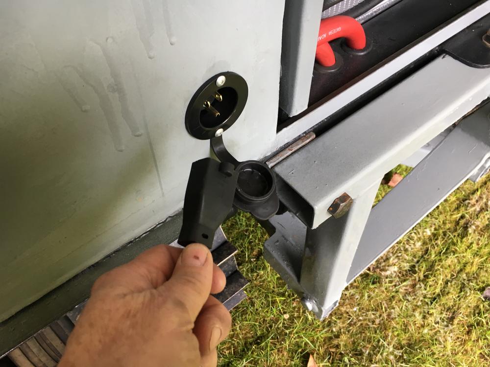

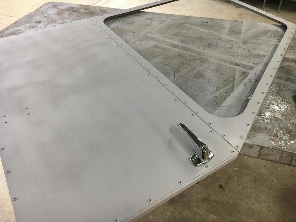

I've been busy cutting, grinding and welding steel and making aft cabin panels and doors. Installed an external plug for the block heater and rebuilt the original front doors. The engine is very quiet in its insulated box. Lots more to do, slowly but surely.

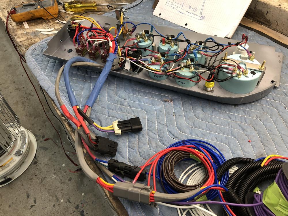

Continuing to make doors and Floor panels. Renee comes down to weld up a door while I paint and reassemble the instrument panel.

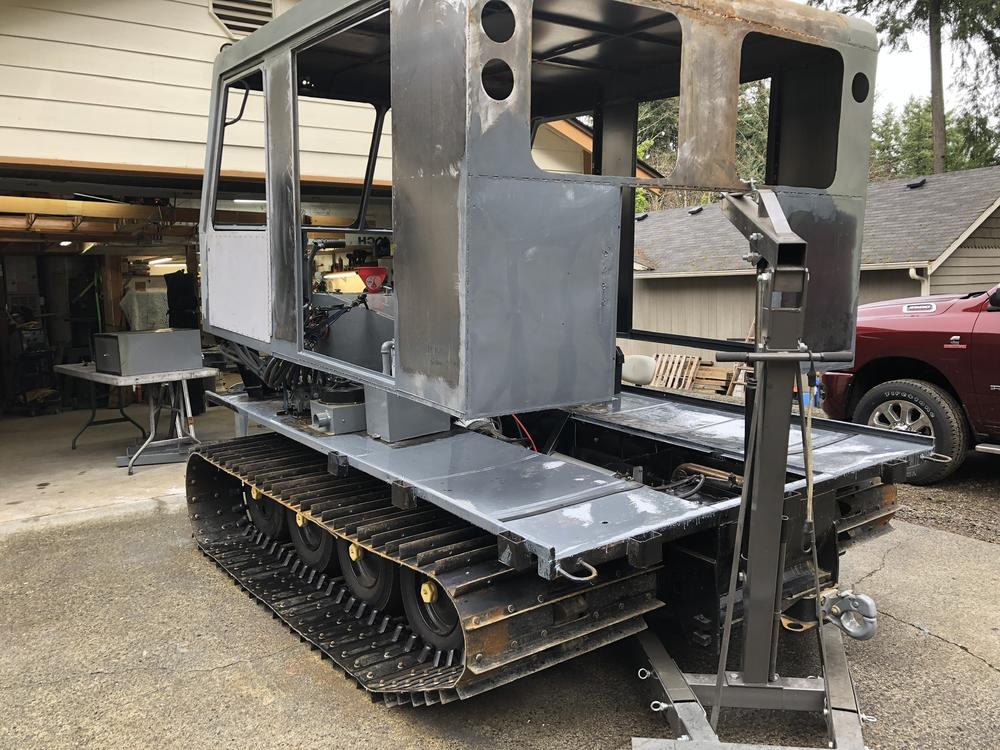

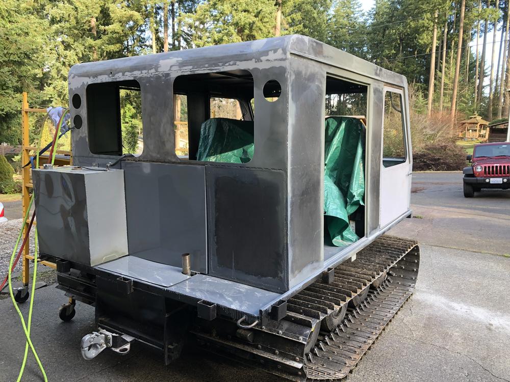

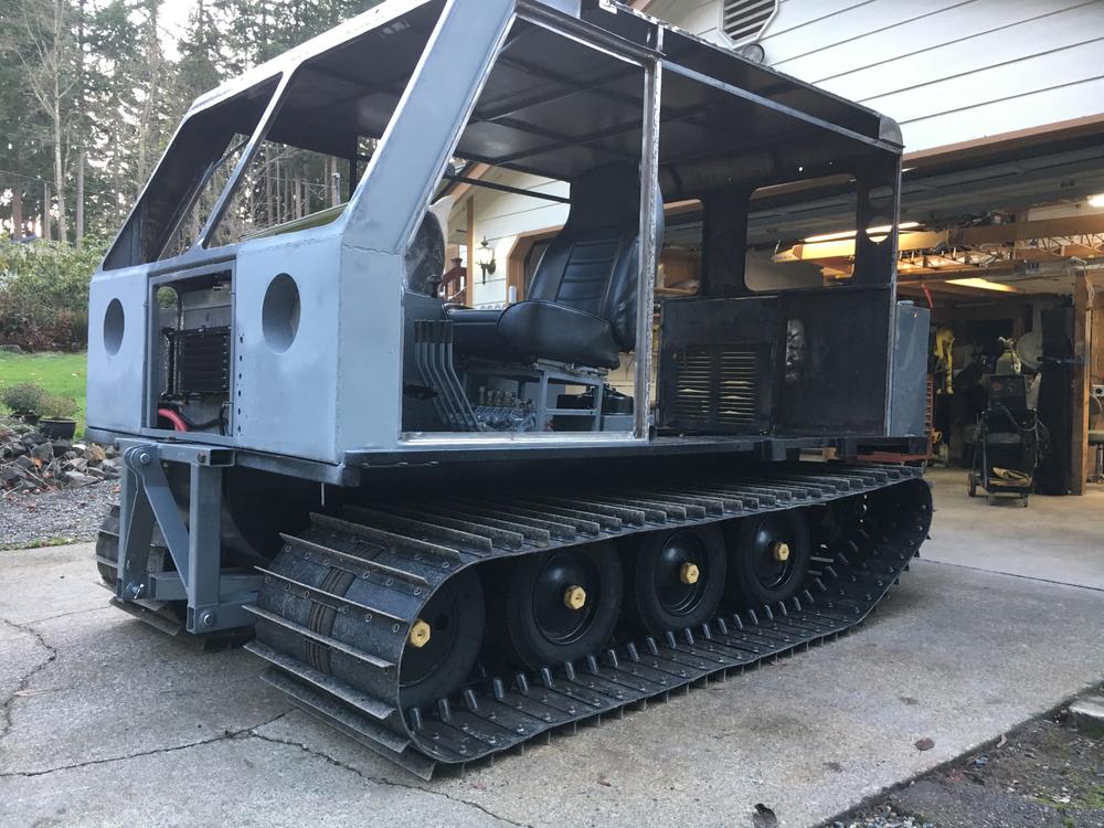

Slowly but surely, progress is made. All lower metal parts prepped and epoxy primered, cab bolted down on new rubber gaskets for good now, roof epoxy primed, just need to sand and prime the sides, then finish paint. Been raining since the last millennium here, not good for painting ?
Jphoenix

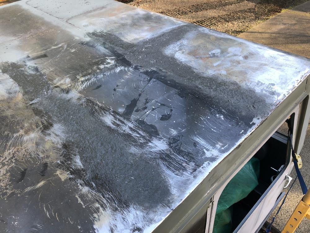

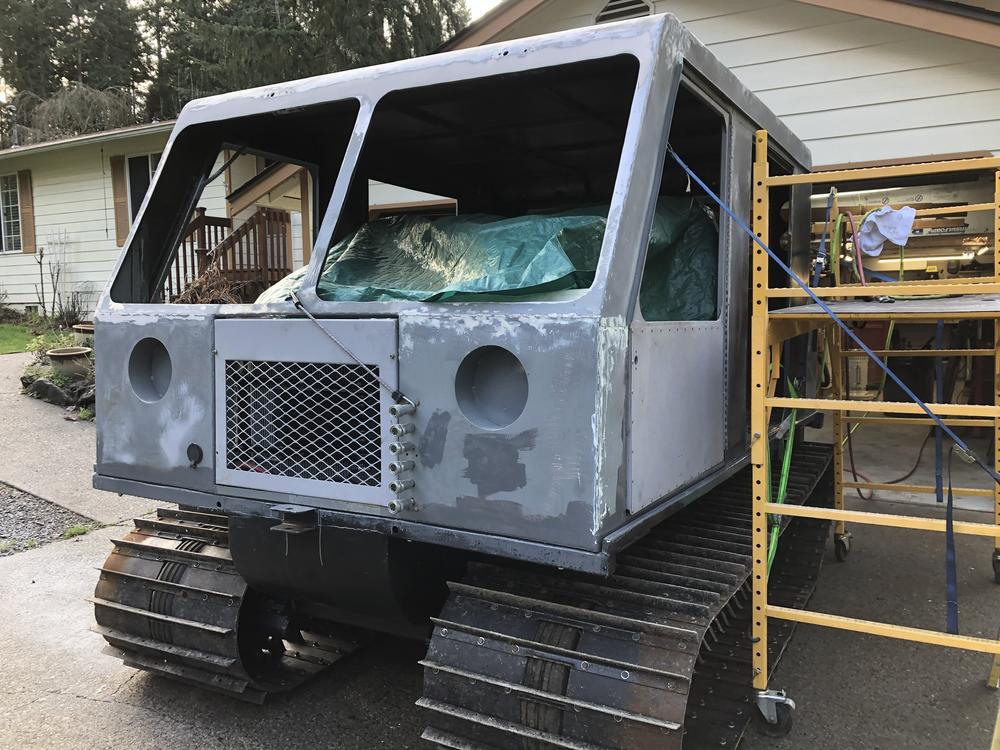

Much less filler being used than original. On the roof, I used Tiger fiberglass filler, really strong stuff. The scaffold is very handy for high work, much more stable than ladders for welding, grinding and sanding.

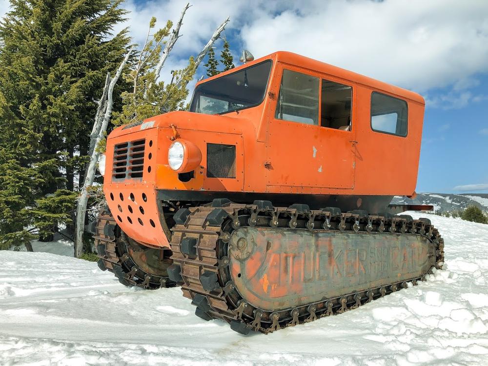

DAVENET
Has anyone ever seen those "rubber overshoes" the article describes for the Tucker?
Doubt they ever left the factory drawing board. Probably the closest thing that came from the idea were these:
There was also a video of a 442 going round years ago that had a set like that. But the blocks are hard mounted to the track, not really 'overshoes'.
