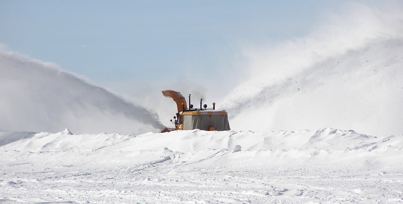

Glad you're enjoying the snow. Wipers have been the week link on all my vehicles. Yesterday I was out blowing snow with the big unimog snowblower. It was about 15 degrees and the snow was powder, easy to blow, but horrible for visibility. You send up a big powder cloud and the wind blows it right back on the windshield where the underpowered wipers can't deal with it (see pic below). Unimog's answer to the snow-on-the-windshield problem was to outfit their dedicated snowblowing machines with a 3rd party (Schmidt Engineering) panoramic cab with a windshield that is tilted forward maybe 20 degrees beyond vertical. I see the wisdom there and wish I had one. The tilit forward windshield is like that on the Antartic A.N.A.R.E. ST's.

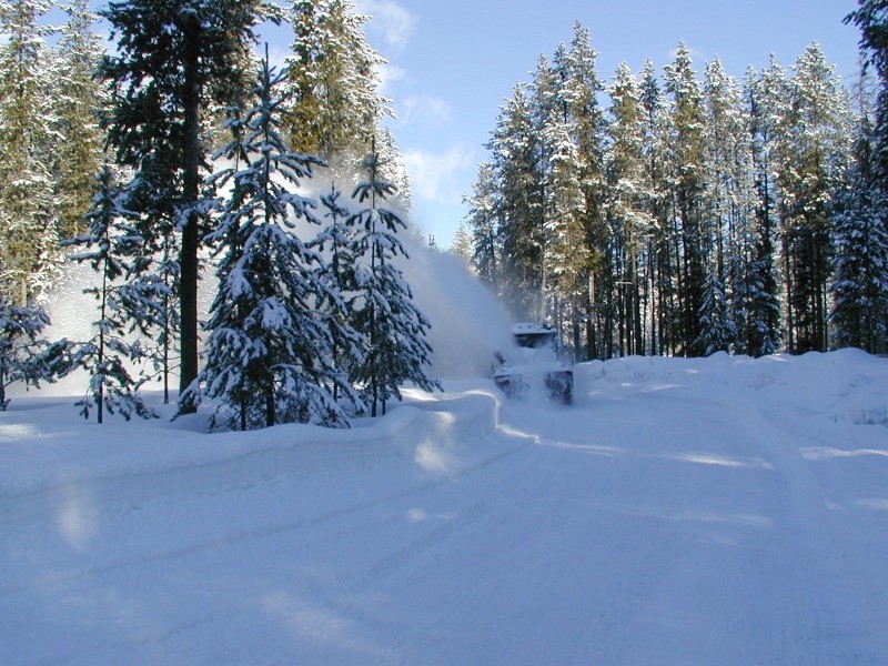

Whoops, see my snow-covered, non-winshield wiping unimog below.
I use a 5' snowblower on my tractor to clear the driveway, but we've been having sustained winds of 25-30 miles per hour with gusts that have been well over 40mph so I didn't bother to put the blower on the tractor to clear the drive. I've been using a rear blade in combination with a front loader and just pushing the snow to the side and then piling up hills when I can't push any more off to the side.
As for the wipers on the Snow Trac, mine are obviously the wrong assemblies. But last year I don't think I ever drove it during a storm :17875: This year I've driven it several times during snowfalls and it is very clear that I need to make a change! I think the ANARE solution of a custom cabin would be ideal . . . but I don't foresee rebuilding the cabin to allow for a reversed windshield. So I'll just settle for proper lenght wiper assemblies and longer wiper blades.
