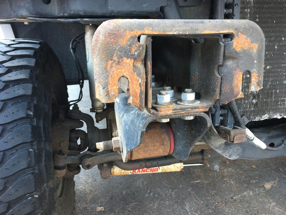

Sunday morning at The Serenade Mike Mikelle and I had our trucks parked "beak-to-beak”. We were chatting and he asked if I had hit a deer with my truck. I have a winch bumper and 15,000 lb winch mounted to the front, and I knew it was slightly askew. So without looking at the truck, I told him Scott and I had bent the frame on the truck where the bumper attaches a few years previously while winching aspen trees out of my yard. After our conversation ended I walked back to my truck and the bumper wasn’t slightly askew, it was seriously tilted! Looking at where the bumper bolts to the frame on the right side, I could see the welded factory frame bracket had broken and the bumper was now hanging from the left side bracket only.
While snowcatting during the day I thought about the bumper and how to get it safely secured for the drive home. Scott and I discussed using a spare ratchet strap to hold the broken end up. But that seemed kind of hokey. After returning to the parking lot I looked at the left side mounting and saw more cracks. After some discussion I convinced Scott of the wisdom of removing the bumper entirely. We asked GMoose for some muscle assistance, and the three of us made it happen.
Pics are necessary.

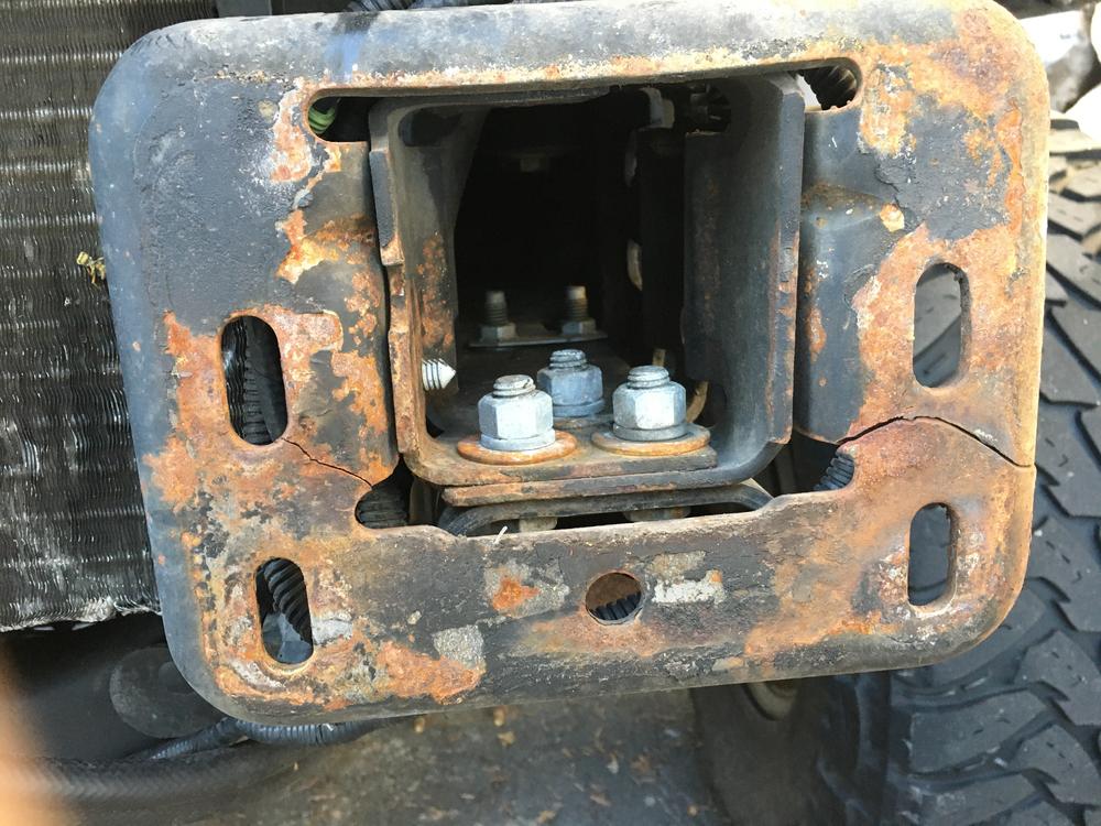

Here’s the right side. The winch bumper, winch and cable are about 320 pounds.

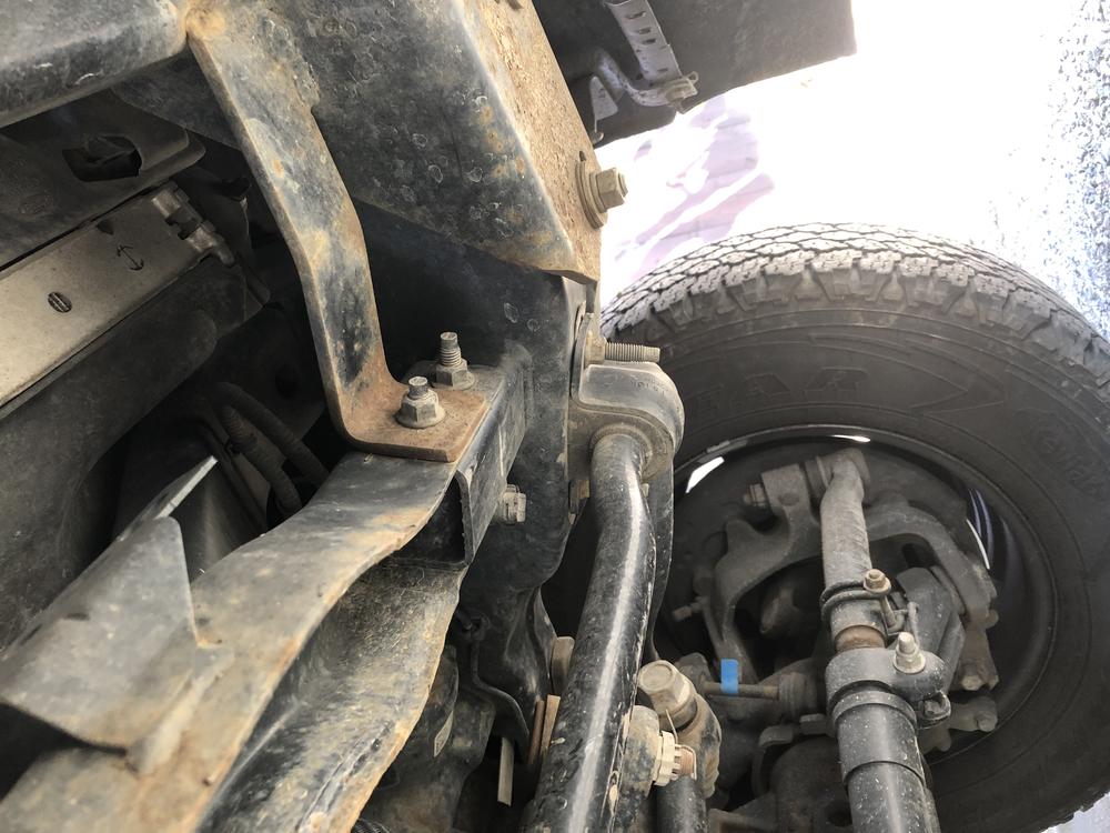

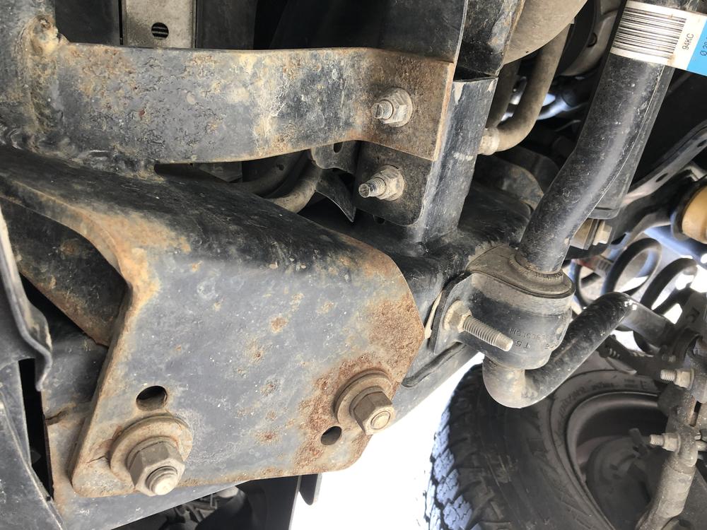

Here’s the left side. Check out those cracks. Not much left holding the bumper on

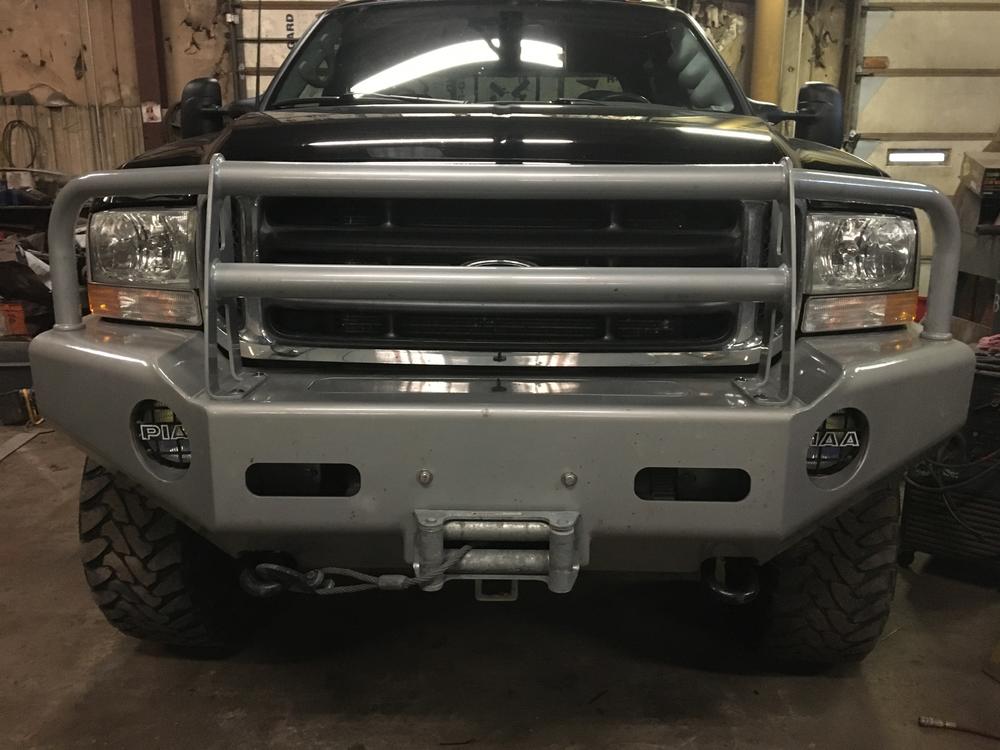

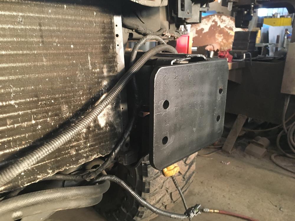

The bumper bracket repair project is now complete and the winch and winch bumper have been reinstalled.
Scott suggested using “beam flange” for the brackets. If you're like me and thought "WTF is beam flange"?, basically we cut the two brackets from a 9” wide section of steel I beam (this font doesn’t display the capital i with the upper and lower horizontal bars). Scott used part of what is normally the vertical leg of the I and that fits inside the frame. We removed the three factory installed bolts that secure the front leaf spring mount to the frame and punched holes in the new brackets’ section that fits inside the frame in the corresponding locations. Grade 8 nuts were welded to the top side and new longer grade 8 bolts were used to attach the front leaf spring mount and provide an additional attachment point for the brackets. The brackets were also welded to the frame on both sides. Before the brackets were welded slight “tweaking” was required to ensure the bumper fits properly in terms of alignment. It is very solid!
