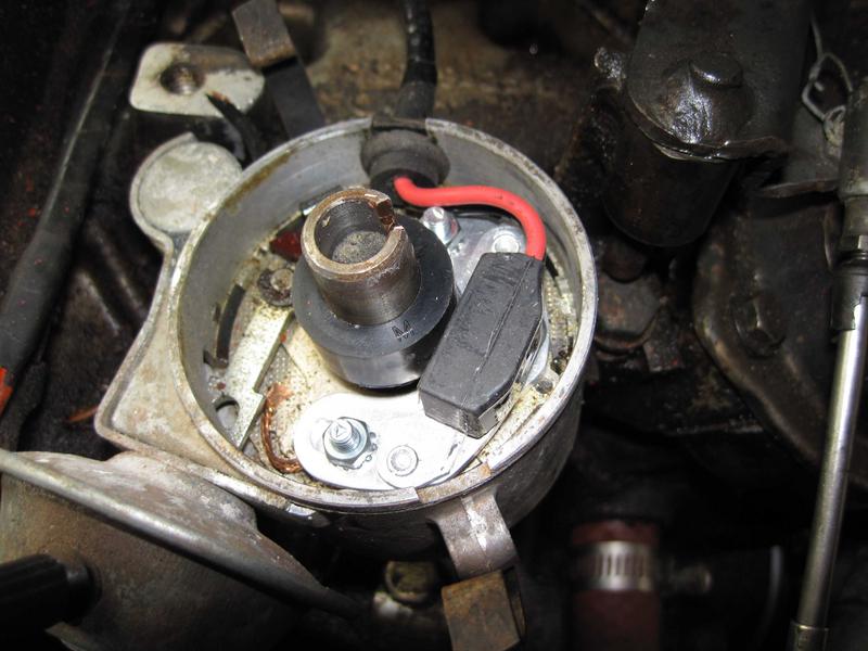

I just installed a Pertronix electronic ignition module on my Imp and I think it's the best thing since sliced bread. It took less time to install than it takes to adjust the dwell on a set of mechanical points and I'm now finished fiddling with points and timing forever. In my experience, electronic ignition is *way* more reliable than mechanical points -- there's just no comparison.

13 year old thread, fond while searching the topic of ignition conversions for Imps. Do you recall the part number you used for the Pertonix kit? I did a quick search on their web site and came up with maybe part number 1847V.
Thanks if you can help. Working on restoring my rough but serviceable Imp, but we need a bit more snow here in N central WA.
cloudcap
I no longer have any documentation on the Pertronix unit I installed and the cat is at our cabin in WA so I can't look at it right now. That said, the spreadsheet I have listing parts for the Saab Sonett (which shares the same engine) shows a Pertonix 1847 as the appropriate kit. That seems like a pretty good match for your 1847v.
The two engine changes I made which vastly improved the reliability of my Imp were the electronic ignition and an electric fuel pump. Starting the Imp used to be a real challenge, but since those upgrades it has been boringly reliable.
Ron
BoyToys
Thanks Ron. The 1847V I think is the designation to be used with a Bosch vacuum advance distributor. Looks like over the years they've made some improvements and now offer upgraded series ll and lll, addressing some issue of burning out the module if you leave the ignition key on for too long without the engine running, adding a rev limiter, etc. So part numbers for those would be 91847v and 71847v. The only thing I don't like is that apparently none of these are compatible with most older tachometers. My tach is dead anyway but will need to do some research before getting a replacement.
Pretty much decided to go electronic ignition, as well as electric fuel pump. Added to my extensive to-do list this summer.
