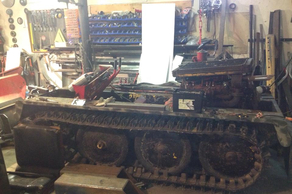

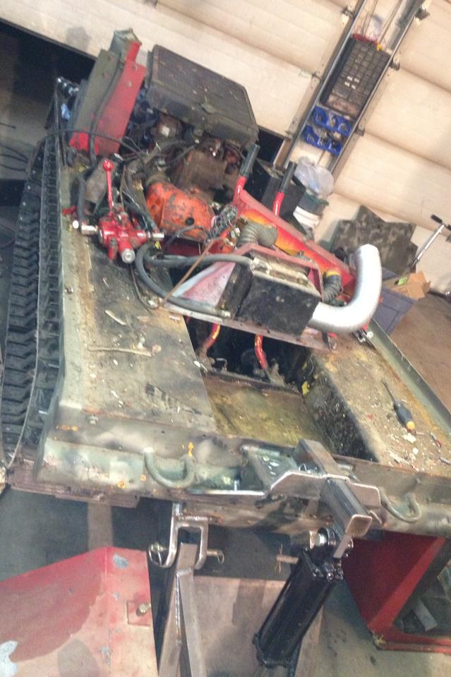

Thanks for the direction to start. The rest of the machine is good mechanically. It steers well and stops easy. The engine runs good, I found a new carb for it and stuck that on, pulled cab and body covers off, down to chasis now. Cut off the lower V-plow mounts and made a new set of mounts and a strait Hyd blade on front. Added a Reciever mount for front winch. V plow available Free if someone wants it, tossing in scap pile. Lots of work to go but should be a fun learning project. As for use, Moose Hunting and pulling my Ice Shack. Thanks again for the help.
Argofixer

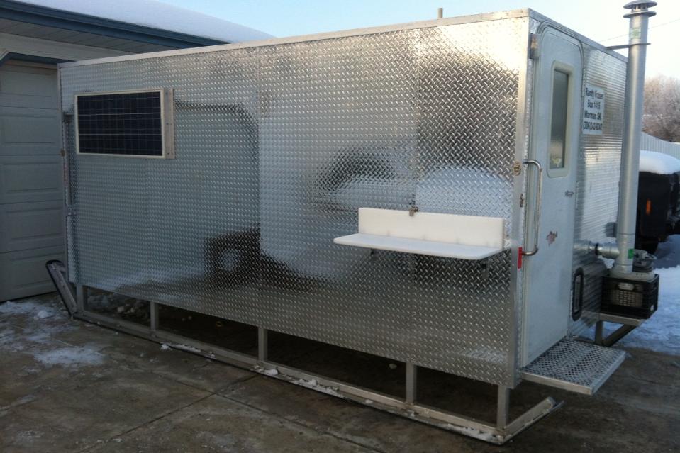

Sure to have a few questions for all you knowledgeable guys as I go along with this build. Here are the few pics I have on my phone from when I first got it and Start of tear down. Also included a pic of reason I bought it ..... Ice shack my sled cant pull across the lake:smile:.
