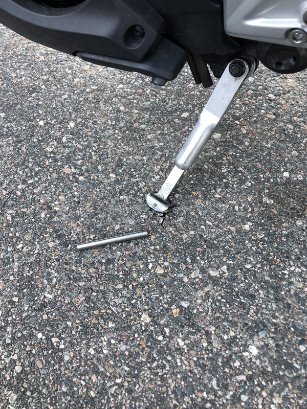

And we had a modification failure today.
The lovely Mrs_Bob's bike is lowered. Used a Soupy's adjustable lowering link and then teamed that up with the Soupy's adjustable kickstand. The kickstand has an aluminum foot extension that is screwed into the billet kickstand. That snapped off. Right at the top of the threads. So its firmly embedded into the threaded hole. Kickstand is useable but its just inconvenient.
I could use an EZOut to remove the broken bit if I was at home, then thread the part of the extension (which I saved) and screw it back in. But I'm not at home. And I'm not planning to do that. I still have the original kickstand. My plan, after we get home, is to measure the length of the Soupy's kickstand as it is currently the correct length. Then cut out a section of the original kickstand and weld it back together. The original is a better design. The Soupy's design makes sense because it is designed to be adjustable, but I believe cutting down the original is the best solution.
If you look close you can see the damage the Soupy’s stand is doing to the asphalt. There is now a pop can under the kickstand.
