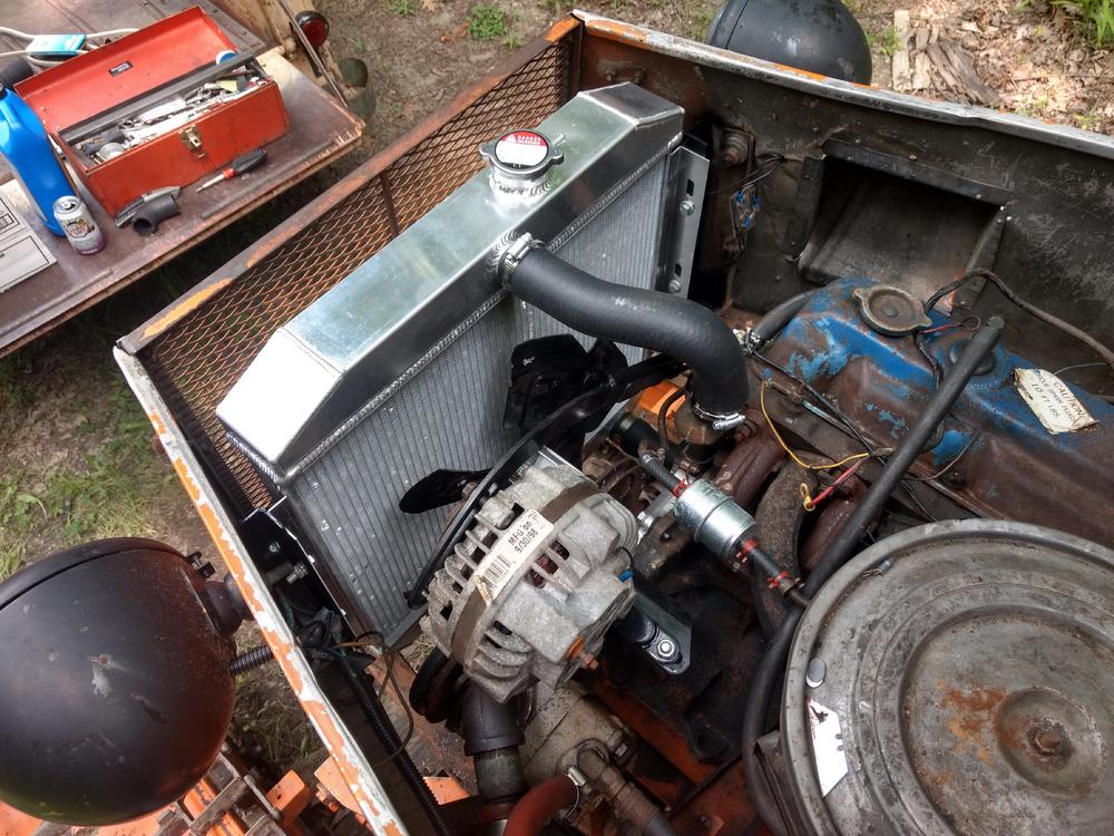

Here's the radiator installed. I welded in two pieces of angle that it's bolted to. The thing nearly fits like it's made for it. I also built custom brackets and moved the alternator to its current location. You can see where the side panel was "custom" clearanced to make the alternator fit in its' factory position. Is the bumpout in the side panel a factory correct thing? If it is, what is it supposed to look like?
Either way, it's packaged a lot nicer now...

That looks very nice. That cobbled together bump out, not so much.

….. nice upgrade... looks more than adequate for the slant six. with a fan shroud it could be efficient enough to cool a big block. I cant recall the bumpout for a slant six. theyre not as common as the v-8's. but you can always do away with it …..

I was looking at Track Addicts Tucker. His slant six has the alternator mounted left side. Yours was right side same as in a Dodge car application. I wonder if your engine was swapped from industrial to an automotive. Or did Tucker mount them on either side?

Totally agree! (Well said, PJL!) Sometimes I look at Tucker's work and shake my head. What were they thinking? The bump out qualifies for that category of critical thought, or in this case, lack thereof.
I also agree with olympicorange on the fan shroud. In addition to the safety aspect, without a shroud it will only pull air through the portion of the radiator inscribed by the fan's arc. For example, if your radiator was 24" x 20" it would have an area of 480 square inches. If the fan were say 15" in diameter, it would cover an area equal to 176.71 sq inches. Roughly 63% of the radiators area is getting zero benefit from the fan...

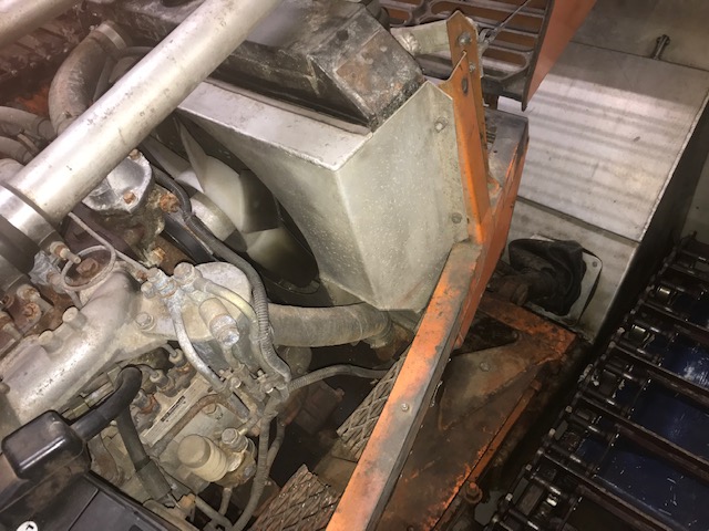

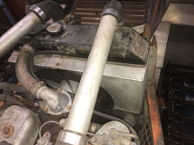

Pay heed to what oly orange and BFT said about the shroud. The unshrouded fan will do very little to pull air through the core. Think, no ram air. Think, stationary engine set. A 2/3 engagement works well. Go look at a Freightliner truck engine. Do a before and after air flow at given engine RPM's and you will be a believer.
I made this shroud in two pieces so it is easy to remove for water pump replacement etc. without removing the radiator.

Quote:
Originally Posted by Southtowns27 View Post
Here's the radiator installed. Is the bumpout in the side panel a factory correct thing? If it is, what is it supposed to look like?
I can't believe everyone missed the toilet paper fixture! Not a bump out. Factory option. I woodent $h*t you about this!

Nice looking work
I have seen the bump out, AS5 wipe holders, on many slant six powered tuckers here in the midwest.
