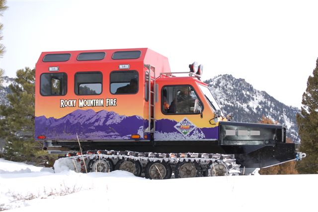

same wheels, same tire, same sprocket, there are 2 or 3 ring and pinions for the oc-12, drop box gears, will all work. Not sure on grousers or track guides. If its a good running cat...just build a full cab for it and run it.
This one looks like they put a set of WT spryte tracks on it.
