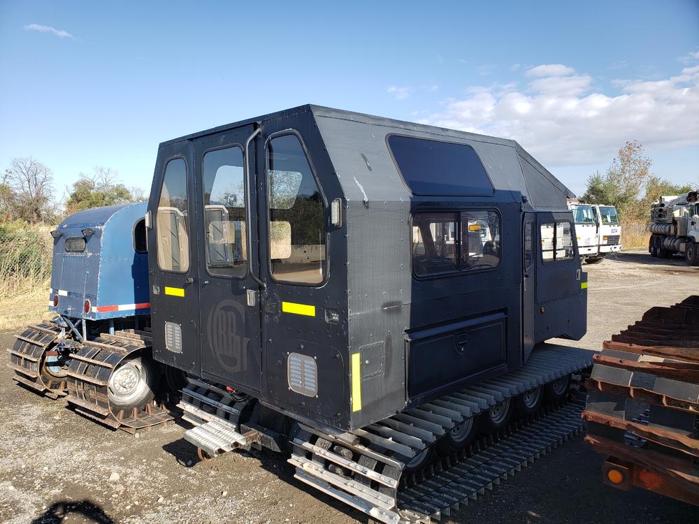

I've been dreaming of a cat for many years and I was finally brave (dumb?) enough to bid on one at auction a few months back. Low and behold I won and soon we were hauling it home.
What I do know:
Thiokol Sprtye with a customized cab
Ford I6 mated to an auto (still need to sort which one)
C-4 differential
Newer tracks with aluminum trousers
Most of you will know far more than that just looking at it. I've not found any data tags but presume it's a mid-late 60's?
I've since picked up a tilt deck original Thiokol trailer. It needs some bearing/wiring love so I haven't loaded the Spryte yet but based on dimensions and the previous owner I'm confident it should fit.
Now for pics!

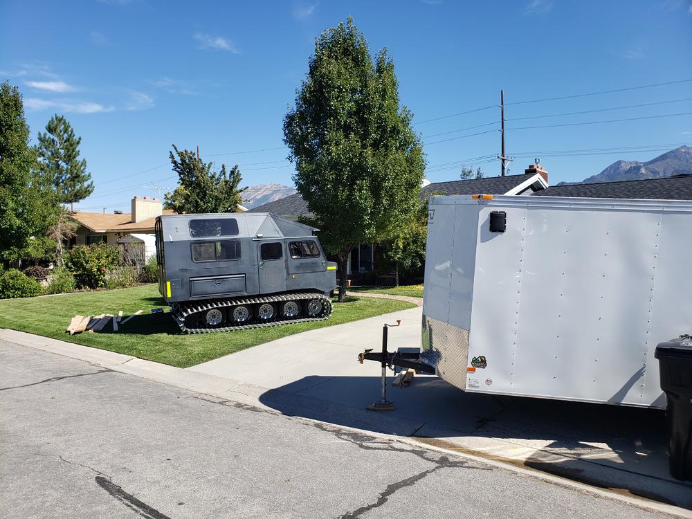

Nice trailer, nice cat. Make sure your tow vehicle is heavy enough, sure don't want the tail wagging the dog.
cruiseroutfit
Site Supporter
The Land Cruiser pictured is rated to tow 8500lbs but I don't know that I would ever be comfortable in that realm? I suspect the trailer is in the 1500-2000lb range and the cat in the 4500lb range? Think I'm way off? As soon. As I get the bearings on the trailer fixed up I'll take it to the scales and find out.
sno-drifter
If you are redoing the trailer axle bearings, do yourself a favor and scrap the CA wheels and rims and get the replacement brake drum set up with eight on 6.5inch. The rims on that trailer were made for moving mobile homes one time and then tossed. I found it impossible to keep them tight as the rims would deform from torqueing down the lugs and then deform more with miles of use. You can still use the same axles. The easier way to go, buy new axles and eBay those ones.
cruiseroutfit
Site Supporter
I’ve been looking at doing just that. ETrailer has conversion hubs. I need to pull one off and measure the spindle and verify the brakes will still work.

Just wonder what the neighbors are saying when that's sitting in the front yard? You're ready :shitHitFan:

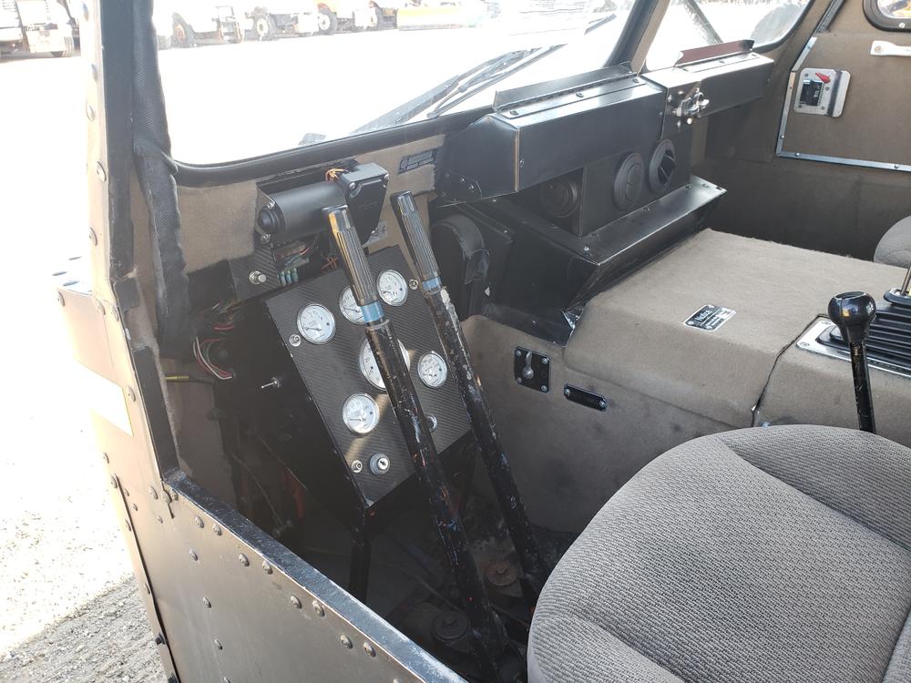

I had a great chat with Dan @ Snowcat Service this afternoon, he is a wealth of knowledge and knew some back history of the machine.
I wasn’t sure it had the original 170ci but Dan was quite certain it has a later/large Ford and sure enough it looks like the 250cc mated to a C4 auto. I need to have some snowy runway to toy with the transmission as I’m not able to get it into all gears. I get P-R-N-D but not the 2-1 positions. So perhaps it’s setup only to go right into drive but it wasn’t shifting when I’ve moved it around. Time to tinker. :D

Oh they are pretty used to crazy vehicles around the house. It was only on the lawn for a few hours :D
