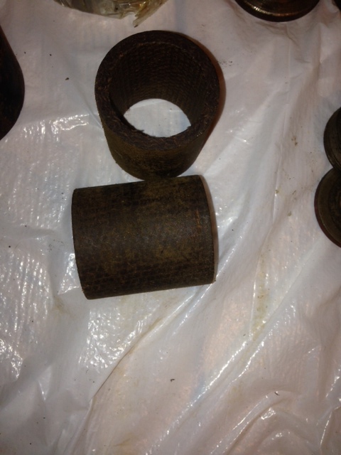

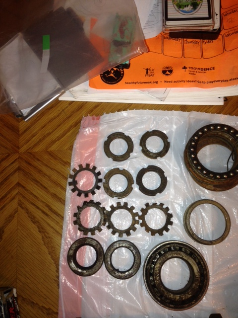

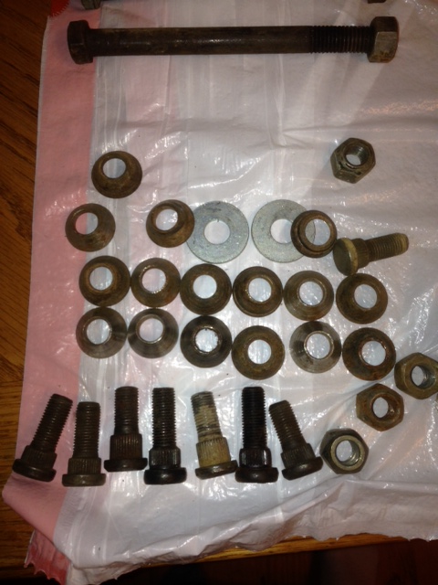

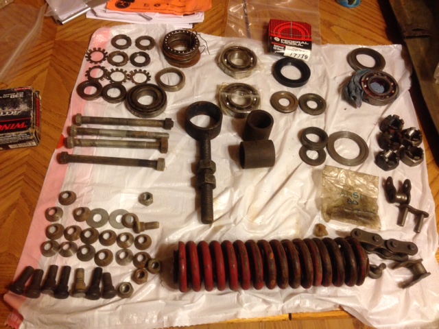

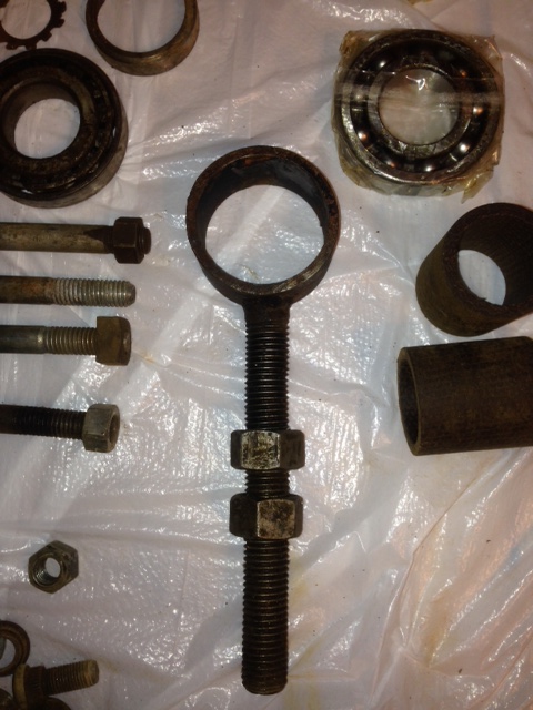

JIMVT I had alaska bearing and seal measure the chain and they came up with 16B chain. I ordered 10 master links but held off on the 10 ft chain purchase (cost cost was $ 383:sad:). I recieved another goodie box with the ST4 B. Below are pictures taken. There was some master links with the box but some are SAE 80 which is not correct but might work in a pinch. I can identify some but not all pieces. The one that has a circle welded to all tread has me stumped. The one with the boggie assemble nuts, what is the goofy roller bearing for? Well I'm going to get all the parts in order today and post pics. Will not be working on rig until I get home from the slop in two weeks.

redsqwrl
given the bushings....
I would guess the rear track adjusters on the rear?
Track adjuster.

member formerly known as dds
there are varriator bearings, axle bearings ,or trans axle bearings . a boggie outer spring and rear track adjuster, also spanner nuts for rear spindles or or suspension pivot points and the rare lock washers for the spanners I would give up a left nut to find a source for.
teledawg
Try your "local" SKF rep/dealer.
Those lock rings and lock nuts are used on the 6-bolt boggie wheels to retain the axel tube.
Here are the SKF part numbers:
LOCK RING, AXEL SKF MB4 LINK
LOCKNUT, AXEL SKF KM4 M20x1 LINK
They are available from simplybearings.co.uk if you don't mind ordering from accross the pond! :brows: You can also get the boggie wheel bearings and seal there.
If you are doing work on the boggie wheel axels and bearings it is also wise to have a M20x1 die on hand to chase the threads. They are really fine and get boggered up easy.:w00t2:

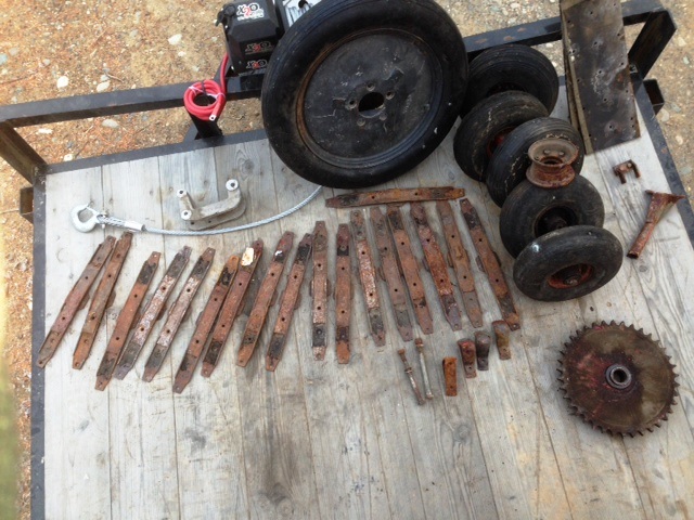

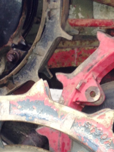

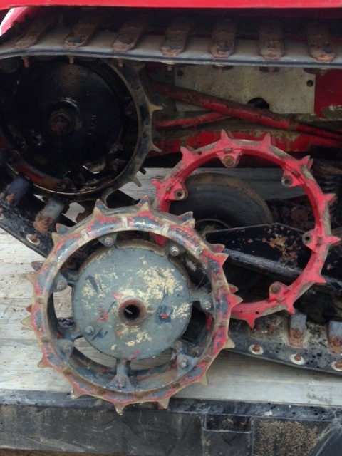

Thanks everyone for the replies. Here is some more booty that went with the machine. I think the two sets of sprockets teeth look to have a lot more meat on them:w00t2:

akimp
The piece above sprocket is a ripped off ice scraper bracket. One is attached and the other one you can see if broken. I will remove the attached one and make it at work. if the process goes well I will manufacture ones for my other machine as well. The bracket attaches to the aluminum tube that holds the drive axle and bearing assembly.

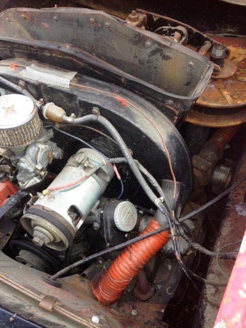

akimp

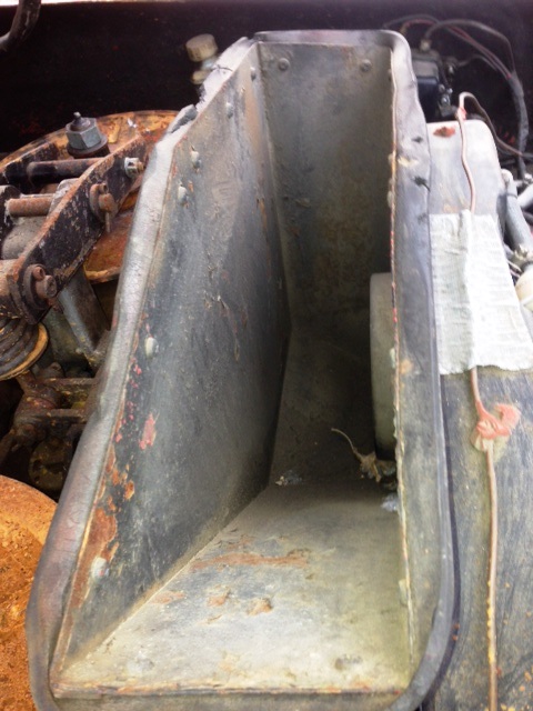

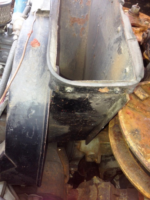

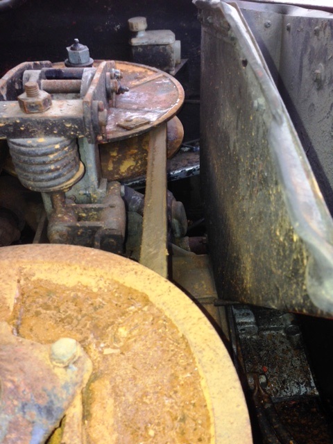

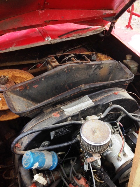

Air cooling shroud for Snow Trac Nome. i can take measurements when I get back home if needed.

Snowtrac Nome
bum deal I thought that had the doghouse type fan housing that is the up rite oil cooler like the engine I just built. I'm interested in seeing a scoop for an engine with the dog house type cooler that doesn't have the aux fan also.
Snowtrac Nome
well I was talking to some one this morning about one on a remote property I'm hoping to score. it is another liquid cooled conversion. it will be good for parts and the glass is all there.
