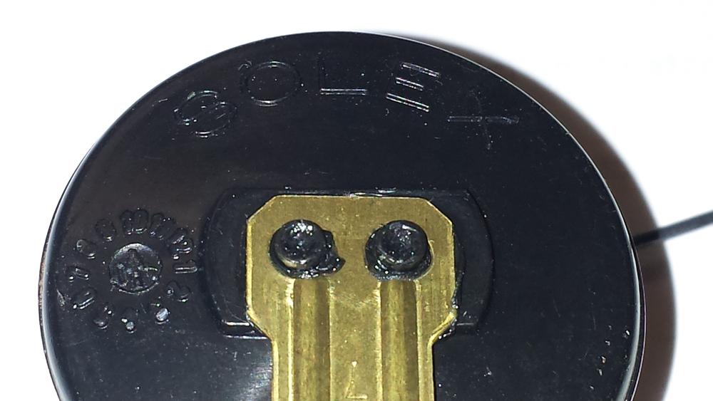

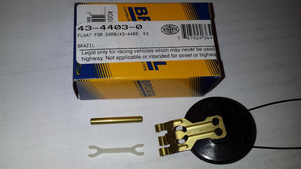

The carb kit I ordered and received is the exact kit for the Solex PDSIT-4, including the correct bowl gasket w/side hole and the original accelerator pump diaphragm.
I also found and purchased a new Solex float for the PDSIT-4. I found it at aircooled.net, their part number 43-4403-0 which says is for a carb/43-4400. It is made by Brosol. I attached pics.
