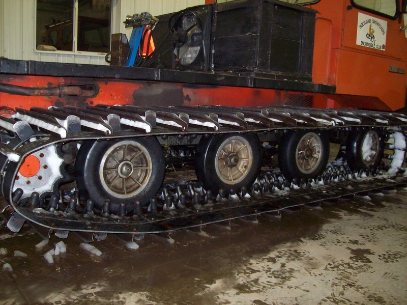

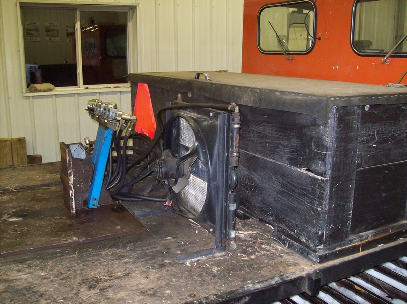

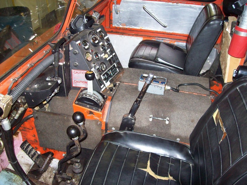

started its life as a groomer hare are some before pics. as we received it. they had put 2" rigid foam everywhere in the cab. we are not doing a complete rebuild like we did on the last 1200 we did. we are just going through the mechanicals, Differential, redoing the cab, a few new tires and fill. bearings and seals, new muffler, removing the rear garbage, most of the work relates to the rear camper cabin with its on heater and two bunks the main frame of it being 1" square tubing and to be bid enough to sleep across the front it will be a removable cabin and we are using .040 prepainted aluminum
well here are some before shots

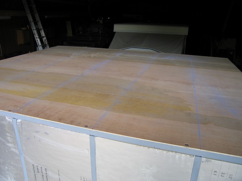

Few more photos of the process the rear cabin does not have its windows yet they will be about 16 by 30 tinted and the inside will have durothem a 5/16" honeycomb product with a white smooth surface and adds a little R value. in the one photo you can see the 1/4" luan was added for snow load to the roof and it will get sheeted over with the orange aluminum also the rear of the cabin has 3/4 plywood

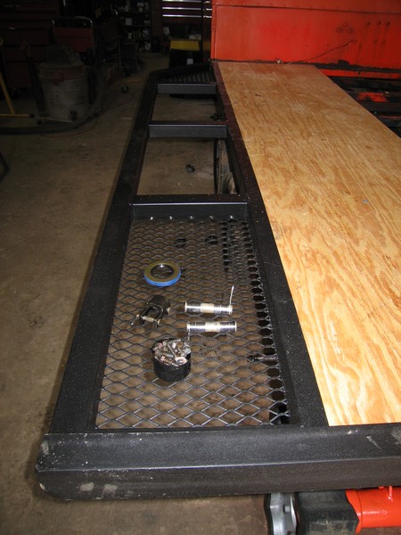

In the previous photos the extensions on the side are for the two 40 gallon fuel tanks they go in the middle the rear area is for two propane tanks to run the 20,000 btu Atwood heater with thermastat and blower. the prepainted aluminum panels are 4 foot by ten foot and are .040 thay have a protective coating on them that peels off after mounting. they will be riveted on. The roof will also be riveted on with closed back rivets and orings under each one.

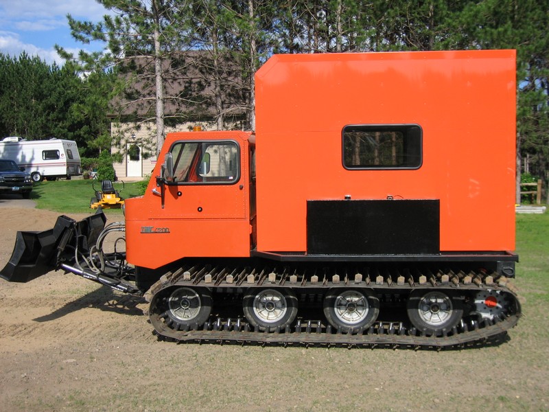

well here are a few more pictures the final R value is 14 in the walls top bunk folds down the bottom bunk has storage under it.still needs propane tanks and rear step. 80 gallons of fuel capacity

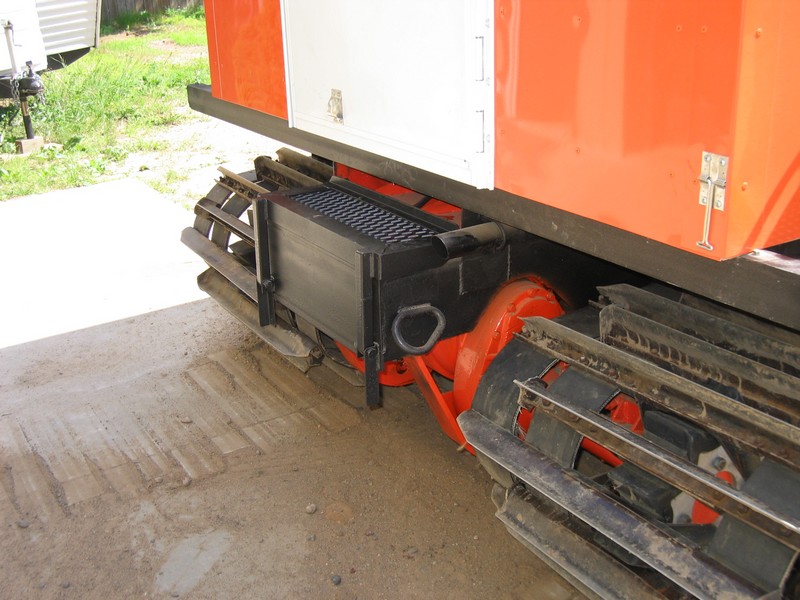

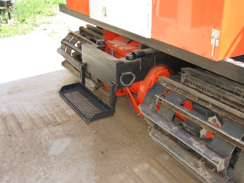

Some off the last touches are now done. the propane holders are built and installed and the tanks and heater were tested. on a 90 degree day..... Ha.
rear folding step now fabed and installed. ready for Snow.
