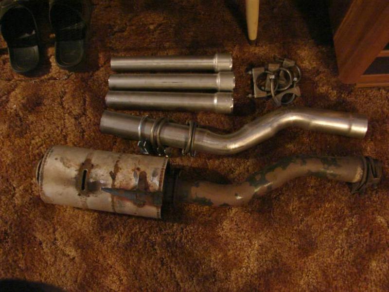

To replace or not replace? The muffler keeps coming off in the deep snow. The initial front / header pipe connection is the culprit. Instead of matching the muffler inlet to the header pipe size (approx 2") they just flared the end of the header pipe and stuffed it into the inlet to the flare and clamped it. I had some parts made to eliminate the muffler and replace the flared connection with a pipe that fits inside the header pipe and is flared to match the rest of the setup to the tailpipe connection. Is there a potential problem running with out a muffler? The noise with it off is not deafening, and truthfully I did not know it was missing until I got under it and saw it missing. My major concern is the hot exhaust dumping by the bell housing and getting trapped in the engine compartment. If it is working hard and under load it starts to sputter / starve until I throttle back. If you open the engine covers and let things cool down things, work well until the heat builds up again. Some similars cats in the area (1500's) do and do not have mufflers. Trailering it and taking it to a shop is not an option at this time. Any comments or suggestions would be appreciated. Thanks.

if you have a naturaly asperated engine i would not run with out the muffler that muffler looks trashed i would suggest an enexpensive glass pack or resonator to hold a bit of back pressure in the exhaust so as not to warp the valves with cold oxygen rich air the stuttering sounds like vapor lock that can be resolved with some steel fuel lines if your muffler comes off the best way to fix it is to clamp it and than tack weld the joint that will keep it from moving and loosening up
I ended up putting an electric fuel pump on my Spryte because it vapor locked at higher altitudes. I agree with tack welding the joints, end of problem.

Thanks for all your comments and suggestions. As the cat is at a remote location I had no access to welding equipment. In order for the exhaust to be repaired "properly" it would have required hauling the trailer up to the location, loading the cat, hauling it 60 miles to a shop (getting oversize load permits) and taking it back. I was not up to the "dance" so was looking for an on site fix. We were able to replace the old muffler assembly with the parts pictured. The header pipe is 2". Instead of clamping four sections to replace the muffler set up, we only had to double clamp two sections. The gap from the header pipe to the tail pipe connection is clean and there is plenty of clearance from the snow.
