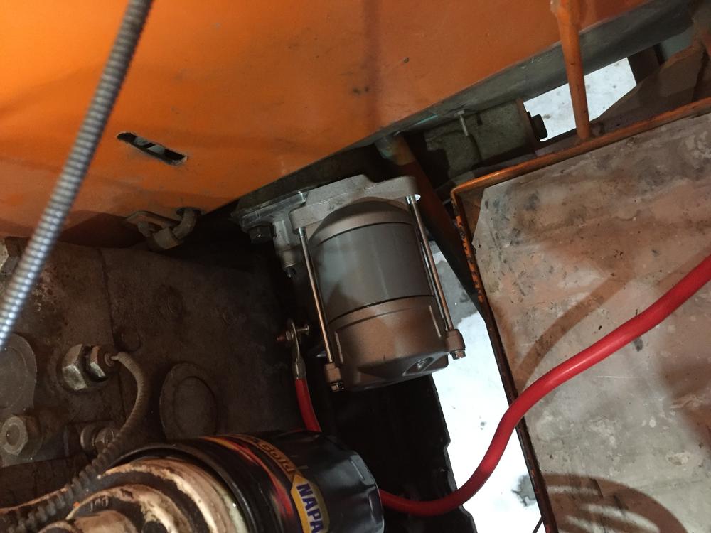

Just picked up my new Hi-Torque gear reduction starter for Sophie our 1949 Tucker. Now I won't have to hunt around on the floorboards in my snow boots to find the stab start switch. Also adding an auxilliary battery, isolation charging system and a battery joiner switch.

no more hitting the gas and starter at the same time. are you keeping the floor one for looks?

No, I'll turm it into a hatrack to display my Tucker cap from our factory tour a few years back.

Will that starter bolt up to the 251 flathead Crystler motor with 146 teeth on the flywheel? If so I would really be interested in the part number and where you bought it.

The folks at Hi-Torque supply the adapter plate and the seller modifies and rebuilds the starter then offers the completed unit on eBay. Hope to install it over the weekend.

I got the new Hi Torque starter installed today. It took a bit of grinding on the adapter plate and some on the starter body to clear the large mount bolts but now it can be listed to fit the Tuckerís 1948-1949 Dodge truck T142 engine. The old stab pedal starter sounded like it was a can full of rocks but the new one is more like a sewing machine motor. I weighs about 1/4 as much and is only the size of a standard spin-on oil filter. Very happy. Now to install the reserve battery isolator and bypass. Name:  D60DF58F-5F00-42B6-A50D-542036D65D14.jpg

Do you have a good email contact or phone number for the Hi-Torque Supply people? They dont seem to be very responsive when i tried to contact seller through Ebay. I would like to get a light weight starter for my 251 flathead to carry as a spare. Thanks for posting this info!

Here is there site I have used these before on the Bombis they work good
http://www.hitorque.com

Mine came from eBay seller Snap Rebuilders in Salt Lake City Utah. Google search will show all the onfo.
