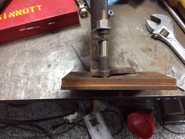

I finally made some room in the shop to repair pontoons and tracks on my 1962 443.
"Has anyone been successful in heating the grouser and bending the roller ear back into a vertical position?"
Forgot this- I have just been putting them in a vice and GENTLY adjusting them back to square (in both planes). And even the ones that look perfect are usually off. :hammer:

mill666er, as for your rebuild of the pontoons, first is to open up the pontoons so they can be media blasted inside and outsides when they are blasted ( the inside was never sealed or painted, and they tend to rust from the inside out ), need to start with clean parent material,
the 30 grouser set ups, just mean that everything is well worn, one can make that work, sadly when the grouser and rollers were not serviced and cared for, they simply wear much fast than they should, getting everything back OEM specs just ensures that you have trouble free operation for the the life of the machine, fyi, know of a 1960 tucker that still has it's original rails and rollers that are nearly new after thousands and thousands of miles of use, reason why, they had the correct factory service. always greased and the link pins were kept clean.
building a jig for straightening the grousers and ears works the best in a press not using heat as the cast ends were heat treated
Mill666er
No heat? Ok I will try my jig in the press without the heat but assume I will have to take into account the spring back.
OK, now you officially have too much free time up on your hillside . . .:wink:
IMHO it is going to take you quite a bit of time getting each side like that, but it should work fine. There is definite 'spring back' when adjusting them. But as well as fixing the 'IN / OUT' orientation, a lot of them probably 'twisted' when the cat was backed up and hit that rough patch.
