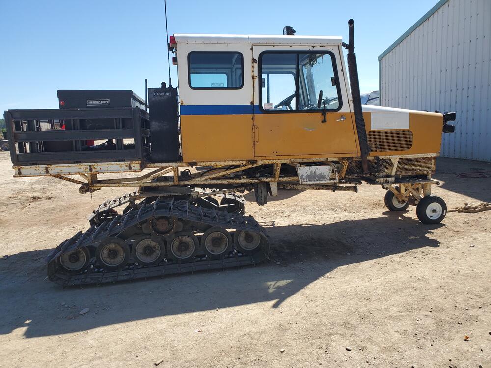

1989 Tucker 1644c
1boringguy
I'm sure I'm going to end up thinking this winter that I should have started this project way sooner than this, but here it goes.
Resto-mod? Restoration? I don't know, maybe a retro-mod. I'm sure I have a pair of PRE 1500 205cm from back in the day I could use for skis. I'd have the only 1624 in existence.

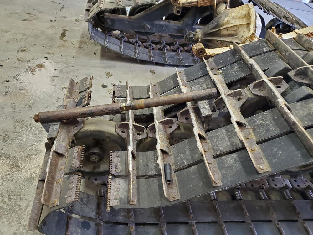

So first order of business is the track journals.
When jacked up off the ground side to side play seems excessive and sitting on the ground can see that outer edges of the track are higher than inner edges. Also as measured with a straight edge across both tracks. That would indicate journal wear. Since in the end it will get a coat of paint, complete removal of diff housings seems appropriate.
Checked freeplay movement between track carriers and diff housing as shown. Fronts weren't as bad as the back when checking by hand before disassemblely, backs were the worst. Haven't got the back all apart yet but will share numbers later. The fronts weren't as bad as I thought. Much of the side to side movement is simply the track carrier moving side to side on the journal from snapring to to snapring stops. I would never have guessed that the track carriers were meant to have that much sloop, but then we're not talking 60mph.
Plan to have the gear shop inspect/repair the diffs before reassembly. Was considering installing lockers too thinking front and rear were open diff. The front is open, haven't cracked the rear yet, but seems to be spooled. So might decide I'm ok with 3 tracks driving full time and skip the front locker. We'll see.
Also, handy little track tool that came with this cat, works good, wouldn't be hard to make.

Track Addict
Looks like the right equipment to make that job easy.
You going with the bearing tape or the expensive uhmw sleeve repair for the slop?

Yea i need all the easy i can get, because when I'm doing it, even easy ain't that easy.
I talked to Clyde at Tucker a couple times about the journals. I'm inclined to do the sleeve, thinking I'm going to have this cat around for a long time. Tucker can sell and install the new sleeve journals (same ones used on new cats today) onto the diff housings. And of course they have the UHMW sleeves. But seems to me, the trouble with that as an entire fix, is that half the wear is in the track carrier tube part of the journal assembly, and without replacing that, while going the sleeve route, one has only solved half the problem. Tucker would also sell me the tube piece thats welded into the track carrier but would not install that into the carriers. Guessing, their busy time of year, don't have a jig for that? Perhaps either I could do both ends or the local machine shop I use could.
So I stopped by the machine shop with pictures in hand. My thought is if the wear isn't as bad as I expected it to be, and not much material would have to be removed to true them up, then maybe they could turn the journals right on the diff housings and the tubes right in the carriers. Would save a lot of trouble. Seemed like a long shot, but I have taken them a lot of odd requests over the years and we often figure something out. They laughed. They make and repair large mining equipment, and do similar things to much larger pieces, so just bring them by when I have them all apart and let them have a look at the actual pieces. Cool, hoping I get them there tomorrow or Tuesday. Depending on how much material has to be removed, I was thinking about wrapping the entire journal with the tape, essentially creating a sleeve and easy to replace. Or the machine shop said they could make sleeves for whatever gap is created.
So right now I still need to see what the maximum out of round is on the rear tracks and how much material has to be removed, and consequently how much that will take from the thickness of the original parts and make decisions from there. I'm definitely hoping to machine the original parts, and add UHMW in one form or another. We'll see.

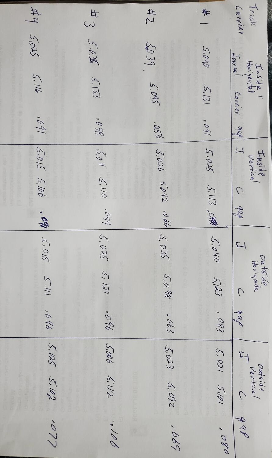

Probably people are going to be thinking tmi, but thinking someone now or in the future might be looking at the same problem, so I'll share anyway.
Track carriers and journals.
The tube in the carriers that I have are the same as Tucker uses on the new machines today. The journals on the diff housings used today are smaller OD and this allows for the sleeve. New and old are the same width. The sleeve is made up of plastic composites that Tucker has made, and is 5.073 OD and 4.765 ID and 10 17/32 long. Cost of parts for the new size journals and sleeves for all four tracks is just under $2,800.00 So thats the background.
Measuring with a bore gauge and caliper yielded the measurements in the photo below. Normal wear should elongate the ID of the tube of the track carrier vertically and the OD of the journal horizontally.
Of note from the chart. All of the tubes in the carriers are elongated horizontally rather than vertically. I can only attribute this to being pulled from the wwlding into the carrier framework. At any rate doesn't indicate excessive wear.
The journals are elongated horizontally which would indicate some wear vertically, ranging from .010 to .024.
Anyway indications are that the wear is very small compared to the gap that is the factory tolerance when this cat was made, generally about .015 compared to. 090.
I measured the thickness of the journal at .280. To turn the journals down to 4.765 ID of the sleeve, would leave the journals just over 1/8 th inch thick. Doesn't seem good to me.
Conclusions,; the wear on my journals/carriers is small. The gap from the factory (most of the machining marks are still on the parts) is surprising to me. The parts used today are a press fit and are greaseless, fyi. If I replace the journals and used the new style sleeve, I'll still have roughly .025 to .050 gap between the sleeve OD and my carrier ID. That seems like a lot compared to a press fit. My machine shop said they use UHMW to machine wear bushings all the time with good results. If I put it back together the way it is, it will be near new tolerances as is. If I use the UHMW tape to fill the gap and it gets beat out in time am I any worse off the original tolerances? McMaster-Carr has UHMW tape available in various thickness from .005 to .065. Wrapping the entire journal to create as tight of a fit as possible and let it self conform with use, seems like the best option for my conditions.

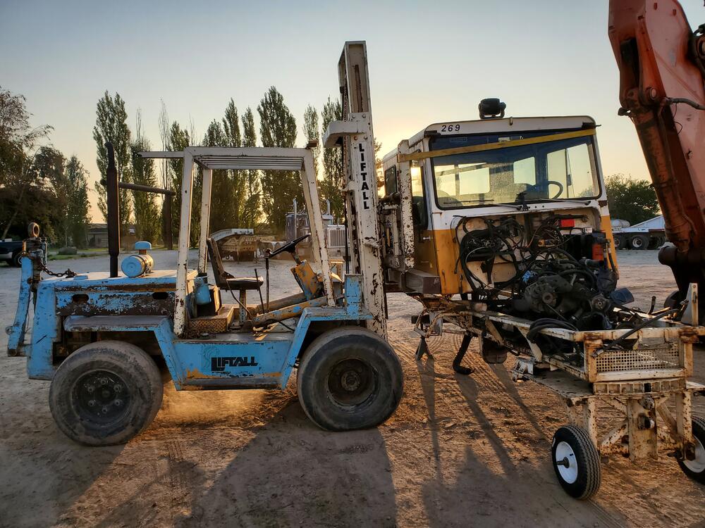

Progress Report.
I think the c model came out about the second half of 1988. Anyway I've been pleasantly surprised that some of the issues I've read about on the earlier Tuckers, like frame tubes that are open at the top and unable to drain at the bottom, had been dealt with by 1989. Aside from surface rust, compliments of BC winter road de-icer, I've only found one real issue to this point. These frame uprights that are at the point of the front motor mount. Clyde said they see some machines with this problem, due mostly to the rigidity of the engine/trans mounts but that the blade might also be a contributing factor. They cut them out and replace with thicker wall tubing, so I did the same.
The gear shop said the diffs look great, but since it's 30 years old we're going to put bearings in while they are out, as prevention medicine.
Weller truck parts shop pulled the pan on the allison AT545 and said there was hardly even a shaving on the magnetic plug, like its had very little use. So new filter and oil and that should be good for a long time to come.
The machine shop said the same thing about the block, really no wear. Same for the parts when I pulled it down. Felt bad about pulling parts out of an engine that looked so good. Ahh but such is the road on to bigger and better things.
Also interesting, the drive shaft between the transmission and the transfer case is very short, not possible for a slip joint, so the yoke on the transfer case is left free to move slightly to accomplish that. Note from paint that a bolt was never used.
All in all pretty happy about these findings so far.

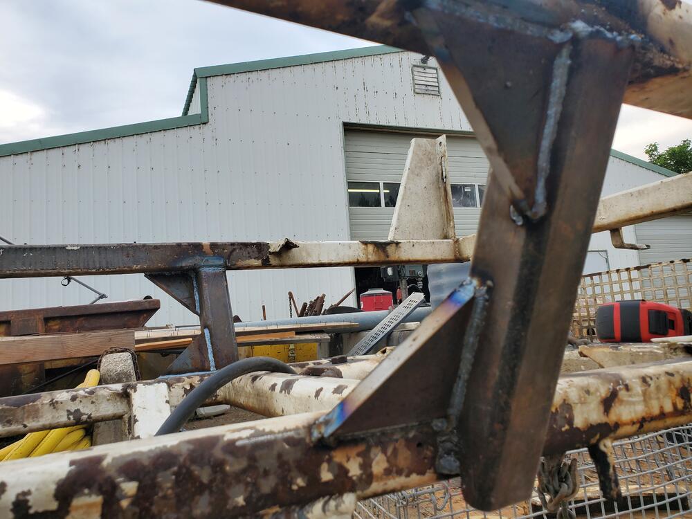

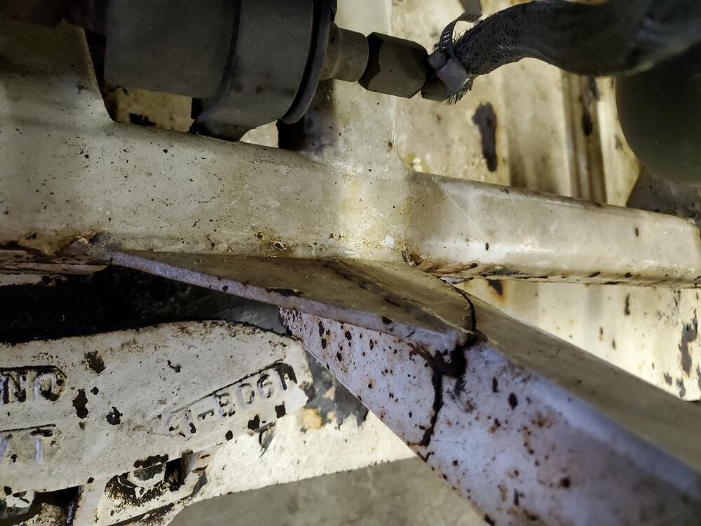

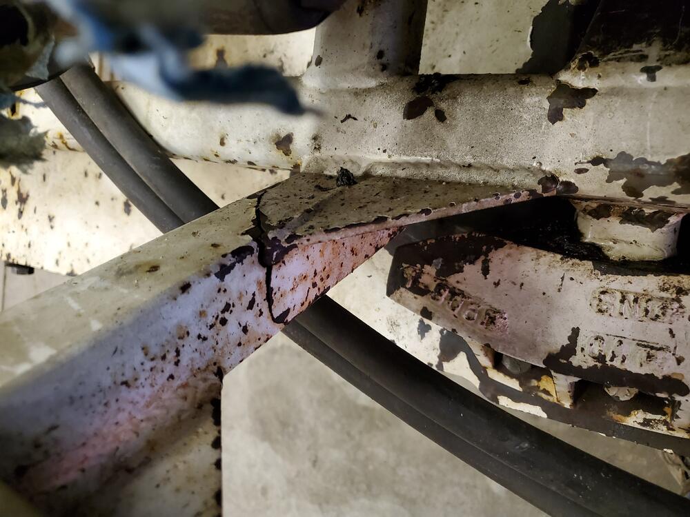

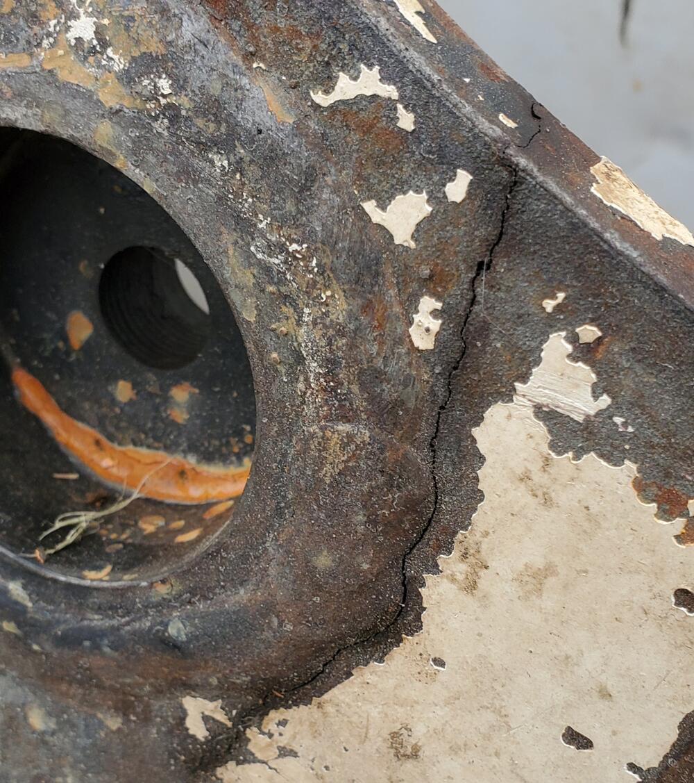

Found another problem. Glad to find this one in the shop and not a failure 20 miles out on a trail. I'm thinking maybe I'll have to just cut a section out of the 5th wheel plate, maybe a foot square, and replace that whole area. Thought about v-ing it out, welding it, and then cutting a donut out of 1/2" plate and over laying that on the bottom side. The metal right around the bushing has got to be fatigued right? Anyone see this before? What was your solution? Also rear 5th wheel has about .015 wear in the male and female parts, so needs to get cut and bushing installed anyway.
