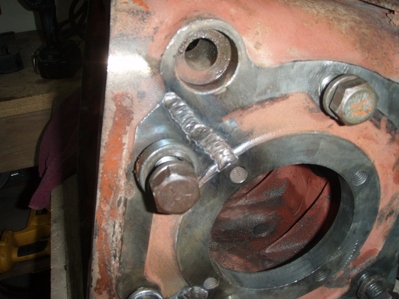

We finaly got out our Imp after a few failed trys tuesday night. Turns out the axle was not broken and only slid out of the gears. I brought it in the garage and pulled out the axle. Found plenty of metal shavings a cracked flange and where someone else had welded the other end back together before. Now I need alot more parts.

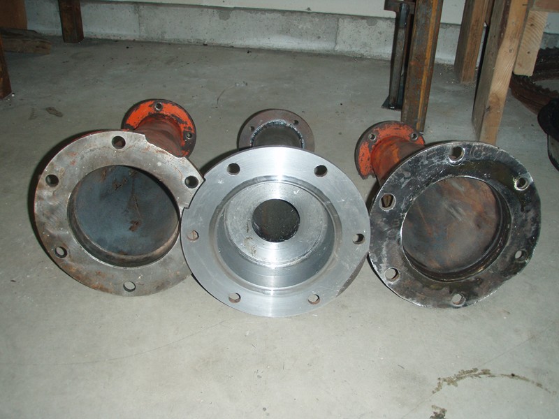

The end of the axle housing closest to the sprocket where the bearing plate bolts on broke part of the flange off. The other end had been welded before and was never right. I am very suprised it didn't break sooner. but thats my luck.

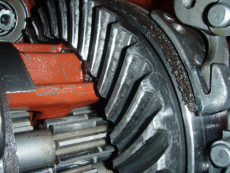

After taking every thing apart. Found that the ring gear is shot, needs bearings, 1 axle tube, and a good cleaning. Found a ring and pinion at Zimmermans, making a new axle tube and got bearings localy.

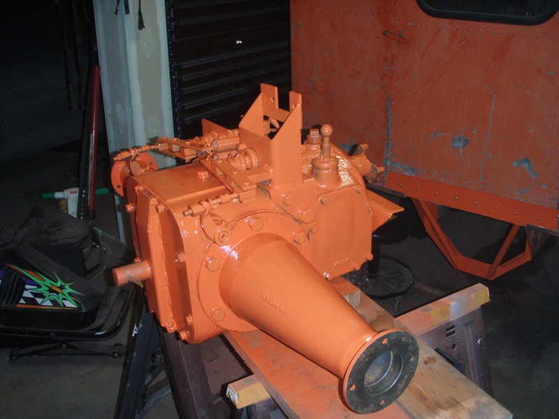

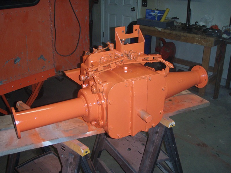

every thing is almost ready to put back together. New ring and pinion, all new bearings, brake linings, trued axles, some new bracing on the imp and a sloppy paint job. should be in the snow this weekend.
That looks pretty good for a new axle tube, might be good to put some ribs on the outside because there is a lot of stress on it being out that far. Still looks like a good job, who did the machine work?
