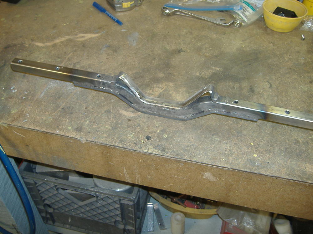

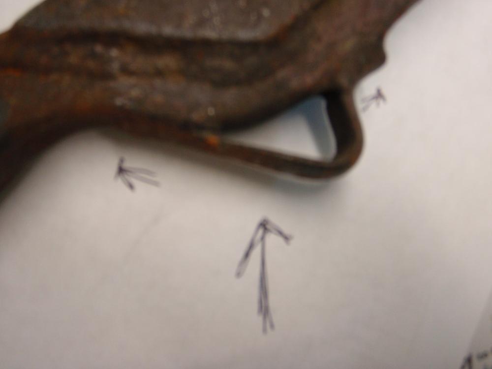

As we continue with our IMP we are finding a few more things...I need about 30 of these, I dont know exactly what they are called, wear tabs that keep the tires in the track. Bunch of them are worn through. Anyone have a source for these or a drawing? I could just replace the entire grouser if I could find some.

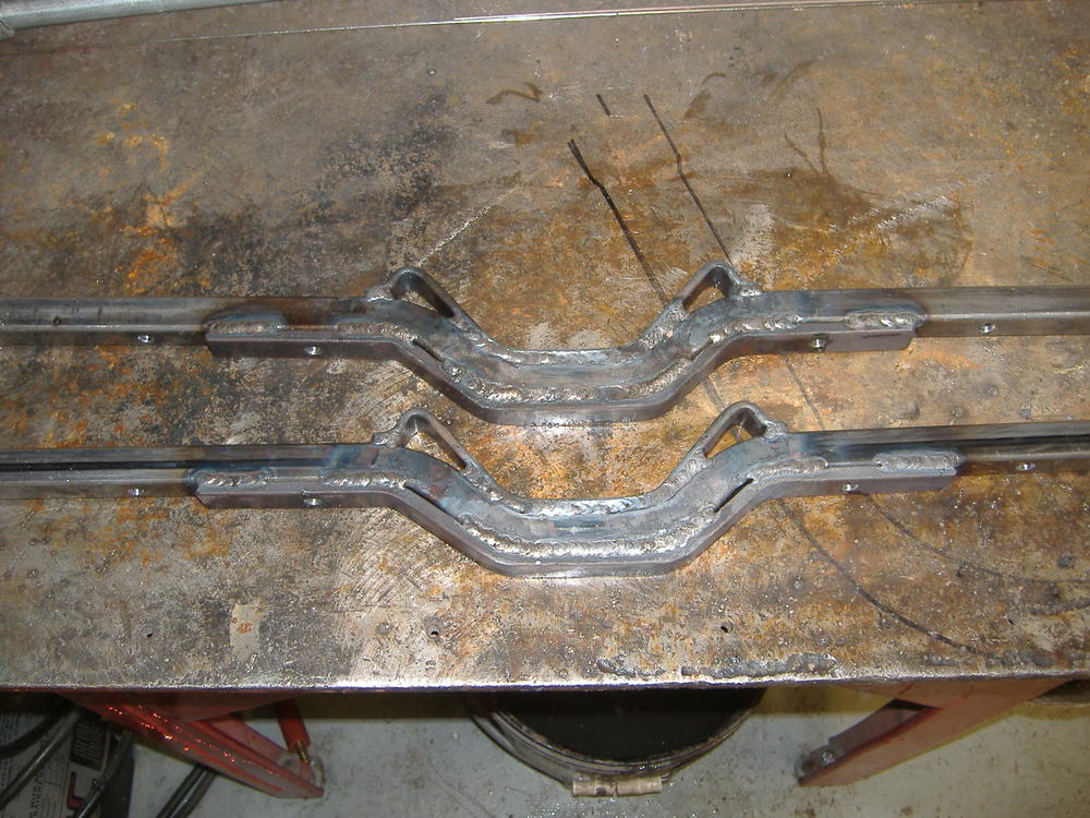

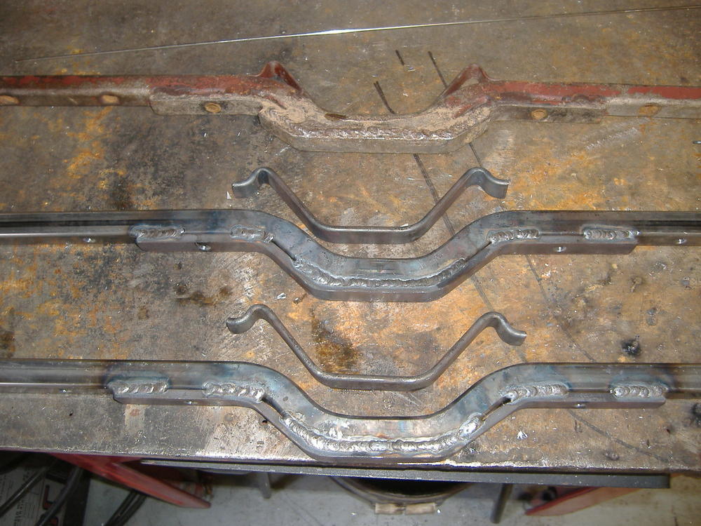

Track guides are pretty easy to make from 3/4 X 3/16 steel bar. I made several. You only need an acetylene torch, a vise and a big hammer. Just make a pattern from an old one and start heating and bending. (We call it "Heat and Beat") Cut the old one out with a cut off wheel and weld in the new one. It may take awhile but what else do you have to do? See my thread http://www.forumsforums.com/3_9/showthread.php?t=63147&page=2 #38.

I forgot to mention to use a disc grinder to round off the edges of the new track guides , then finish them with a flap sander to match the originals. Good Luck!
