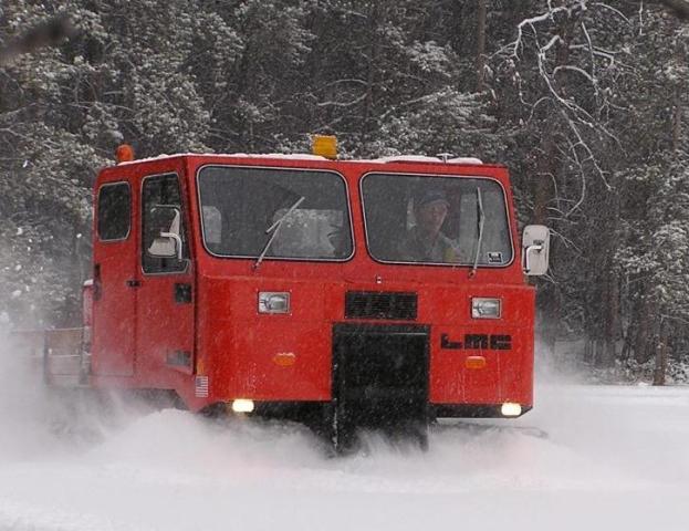

Here are two pics of my 1200 LMC and its lighting arrangement with some explanations. This setup seems to work well in everyday usage. I will set up most of my cats with similar lighting arrangements.
1. Headlights Hi/Lo Beam
2. Amber Safety Strobe. Must Be Visible Front, Rear And At The Sides Of The Snow Cat.
3. Low Mount Fog/Running Lamps For Low Visibility And Blizzard Conditions. These Run Very Warm And Do Not Collect Any Snow.
4. The Lights At Each Rear Corner Of The Cab Are A Combo Of Amber/Front and Red/Rear. They Work As Front Amber Running, Rear Taillights, and 4 Way Hazard Flashers. They Could Also Be Setup As Turn Signals If Required.

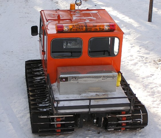

1. Again, At All Angles The Upper Red Tail Lamps/Hazard Flashers At The Rear Of The Cab Are Visible and Stay Free Of Snow.
2. The Rear Backup Lamp In The Center Is Mounted Low To Prevent Glare In The Windows And Mirrors When Being Used.
3. I Also Have A Lamp Strip Of 3 Red Lights Mounted Just Above The Tracks On Each Side Of The Cargo Box. They Are Secondary Taillights. As You Can See In Deep Powder Snow They Collect Snow And Are Hardly Visible. They Do Look Cool And Can Be Seen Easily At Night.

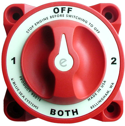

And just to throw something else on top of what Brian just wrote, you may want to consider adding a second battery.
I just installed a Dual Battery switch, the type used on yachts. It is a 4 way selector switch, capable of handling almost 1000? amps, that allows me to choose battery #1, battery #2, both batteries or to disconnect both. :cool2: Given where I run my Snow Trac, having a second battery is probably not necessary, but I sort of think that it is like having a belt & suspenders on your pants. You may not need both, but just in case you have a clothing malfunction its nice to have a back-up! ;)
Now all I need to do is buy the second battery and wire that to the switch.:hide:
