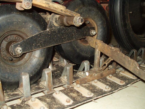

In the past two weeks I have had to change two tires/wheels on the VMC snow cat in the field. Below is an easy way if you have the torsion bar axle system. Thankfully, both of mine have been on the inside idlers. Blocks cut out of 6X6 worked best. Someone on the VMC in the past put tubeless tire sealer in tube type tires and now I am paying the penalty. If I have this machine next year both rubber tire idlers on each end of the track will be foam filled. :thumb:
mtncrawler
Thanks Mtntopper, good trick. Drove foward on one 2x4 first, then backed onto two.

mtncrawler, good photo of the wood placement!
